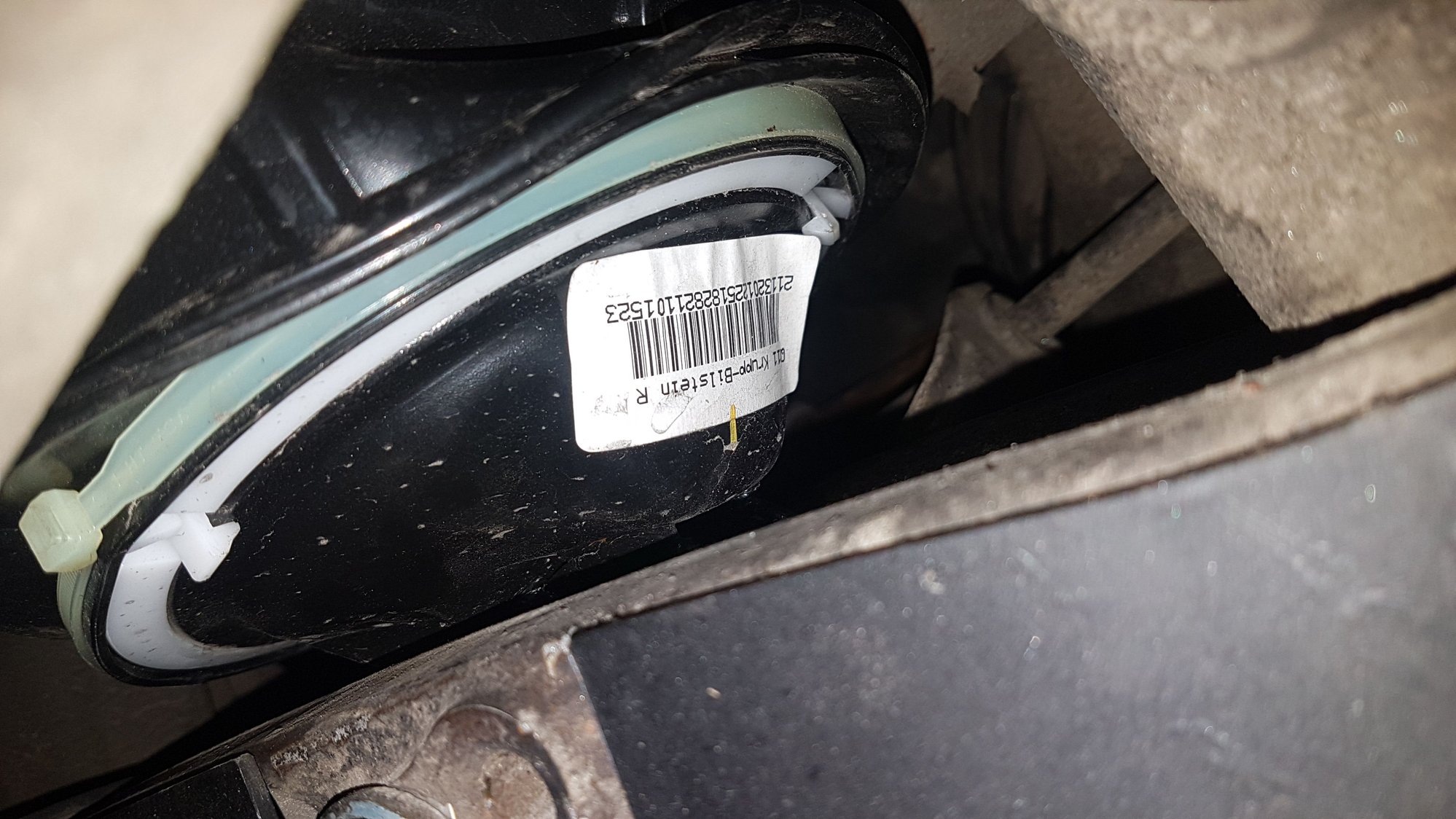

They are oem mercedes which the installer got from the dealer. I have looked around at the bags, there are no Axxxxxx part numbers on them. When i search at the numbers on the bag i get hits at diffrent bags for E class, non for amg. But i don't really think he keep giving me wrong bags since he is paying for them. The numbers im referring too are in the pics.
Well, since it's at the dealer now and they tried to get them straight with no success
i hope they know what they are doing.

My money is still on wrong install since they did not follow WIS instructions then when the car came to the groud damage to the springs occurred. The right side looks like a banana, the left spring sits not like a banana but in an angle. If you have any other ideas now it's the time to shime in.

Oh they definitely installed it wrong. That much is certain. There's only a plastic clip for the top retention of the air spring in the rear, so the airbag can effectively "spin" in there until it comes under pressure.
Only two scenarios: 1] They installed it twisted and that's what it looks like under pressure, or 2] They damaged the bags by lowering them without pressure. I'm opining option one.
