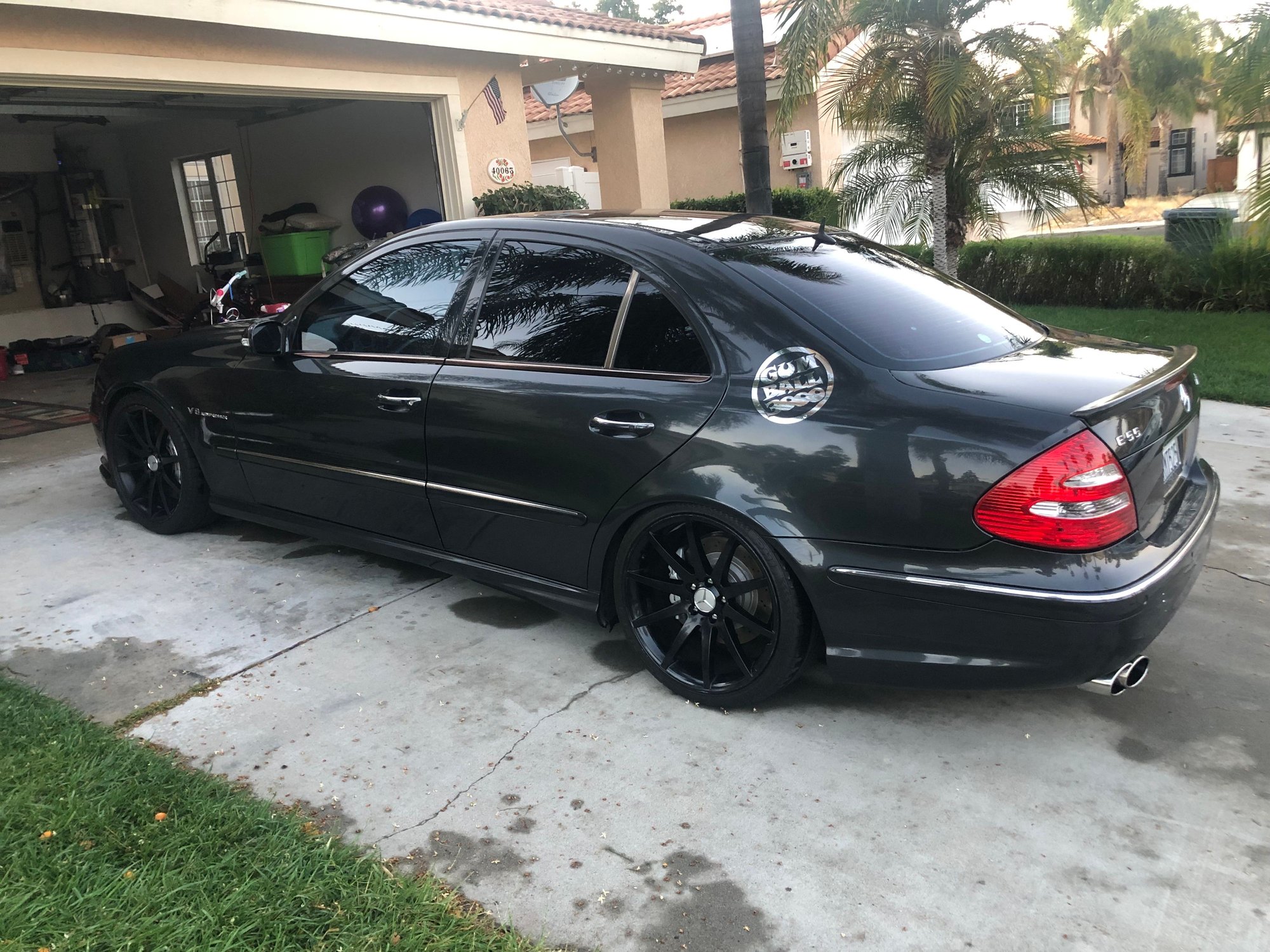

Hello! Just need to know if I can run a fixed 80mm pulley without any additional cooling mods? If not what’s the best cheapest way to keep it cool and not f up the engine. Thanks!

Yep, and I'd guess w/ the palm trees in the pic you are in a warm climate. I needed a larger heat exchanger and new pump when I was running an 80mm FSP, and I'm in Seattle..
