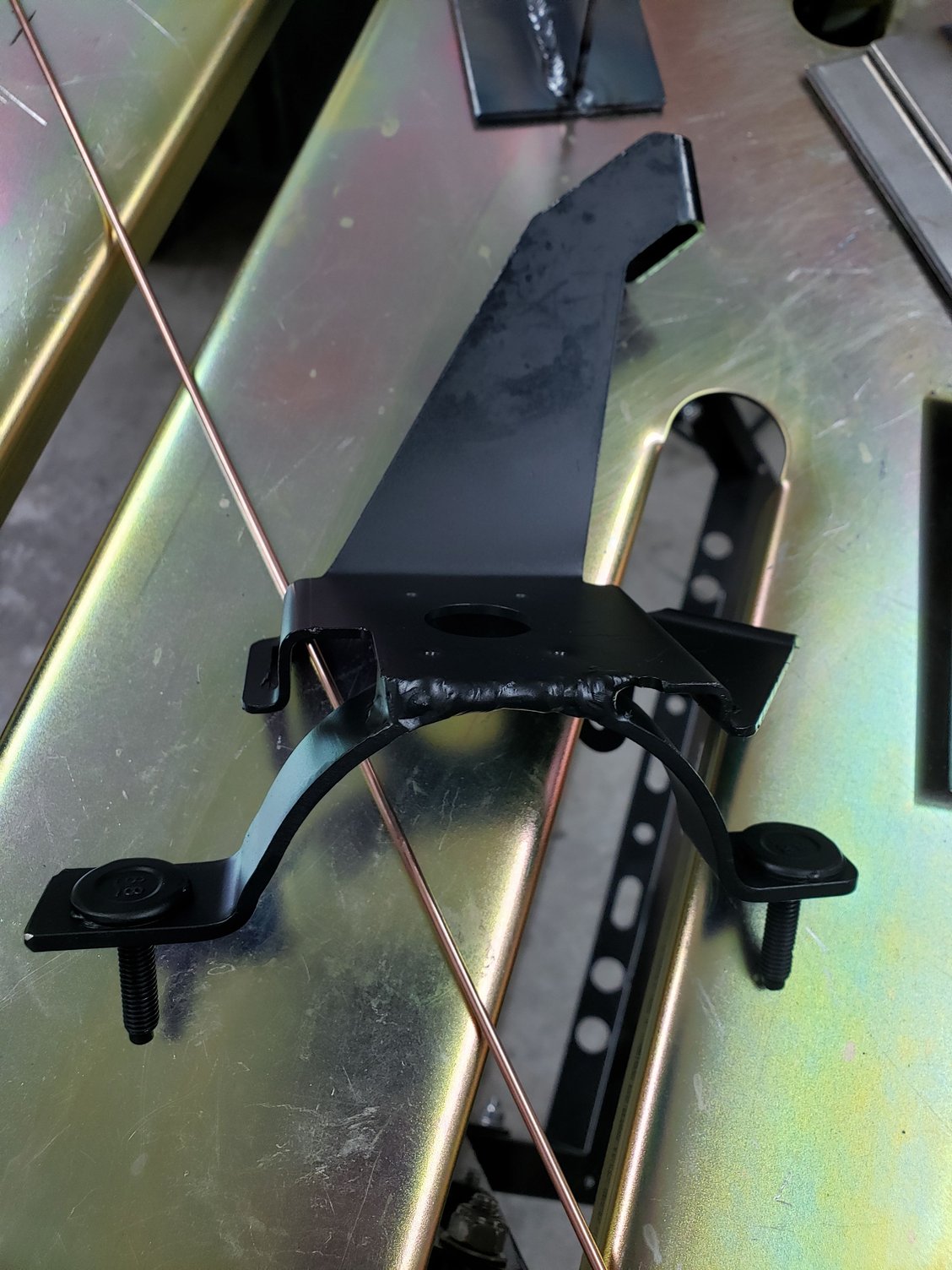

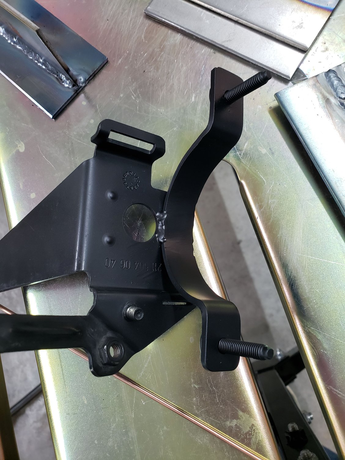

2005 E55 AMG
Here's the bracket P/Ns from Ford:
DR3V 8B503 BB (rear)
DR3V 8B503 CA (front)
A little trimming and welding you can do this:
GT500 bracket welded to E55 bracket
Like a glove
