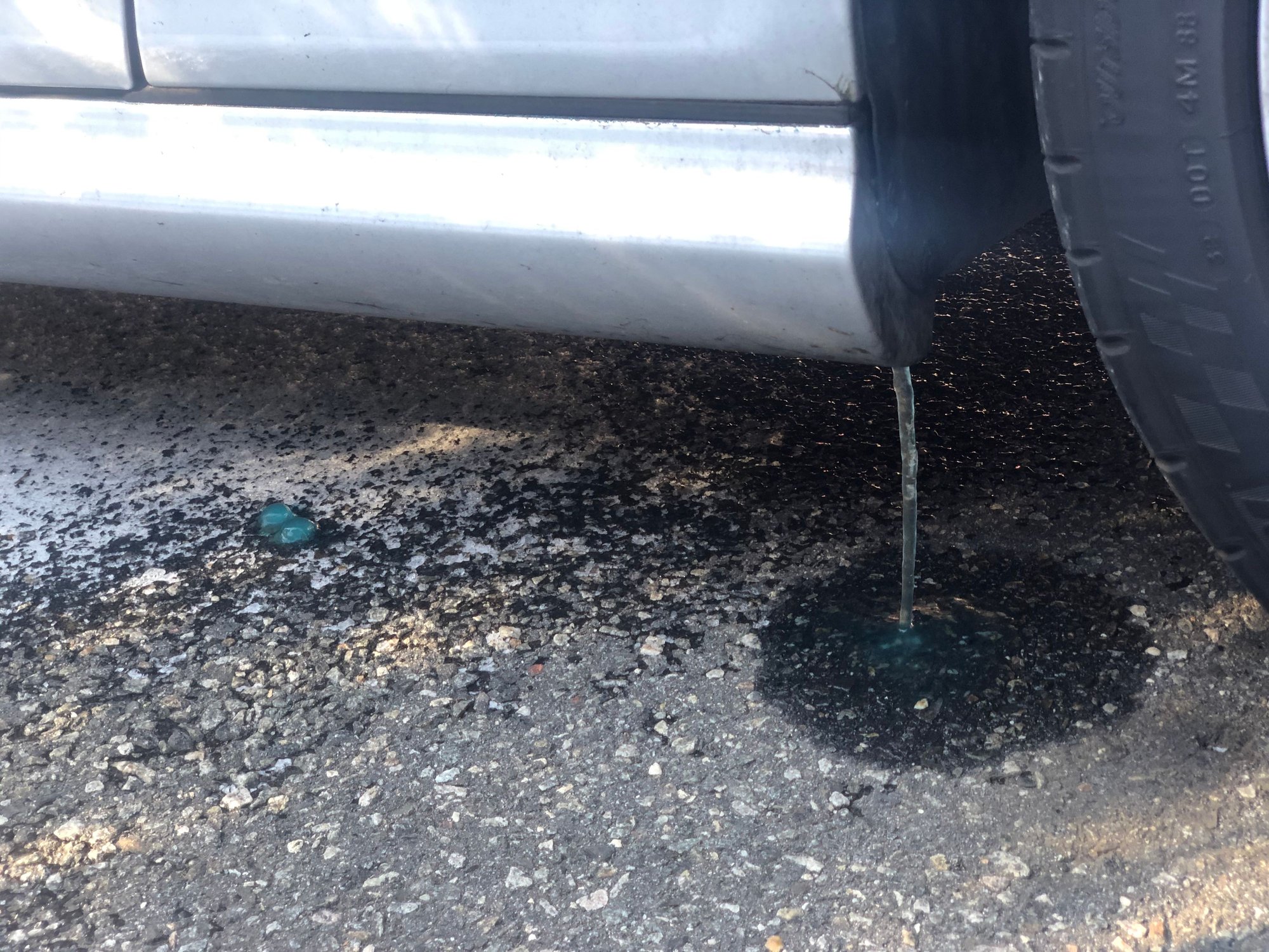

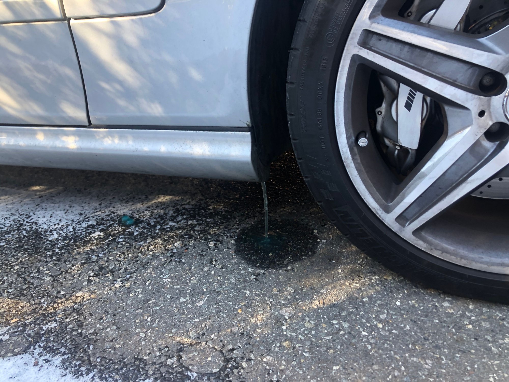

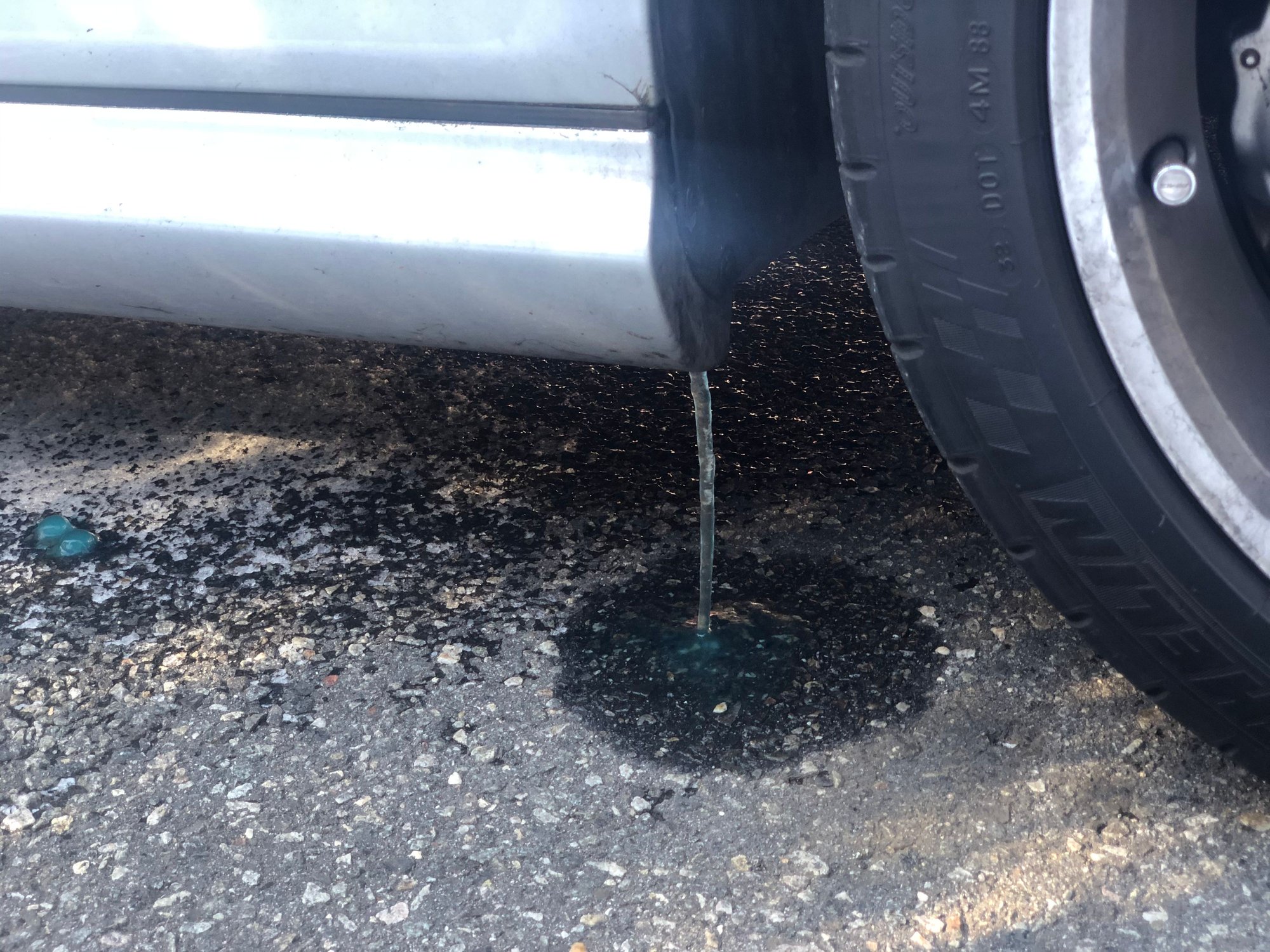

definitely not excess drain, Leak somewhere in the winshield washer fluid tank/pipes some where,

Mercedes is supposed to warranty their work/parts done at any of their dealerships. The windshield washer reservoir is an easy swap, unbolt it, and unplug a hose.
I think that someone might have added water instead of wiper fluid. As wiper fluid is alcohol based to help melt ice on the windshield. If someone did add water, then that would explain the leak as water expands as it freezes causing it to crack and leak.
It could also be a busted hose that has ruptured from the expanding ice. Anyway, that will have to come out to take a look. There is an addictive you can buy to help stop rear main seal leaks. As pulling out the transmission to replace it isn't cheap.

Regarding the washer reservoir, this car has spent all her life in the Southern United States, LA and TX, this is her first winter experience in the Northeastern US, and the temps. have been Frigid in Northern NJ. so it does make sense that some one might have put water in the resistor.
