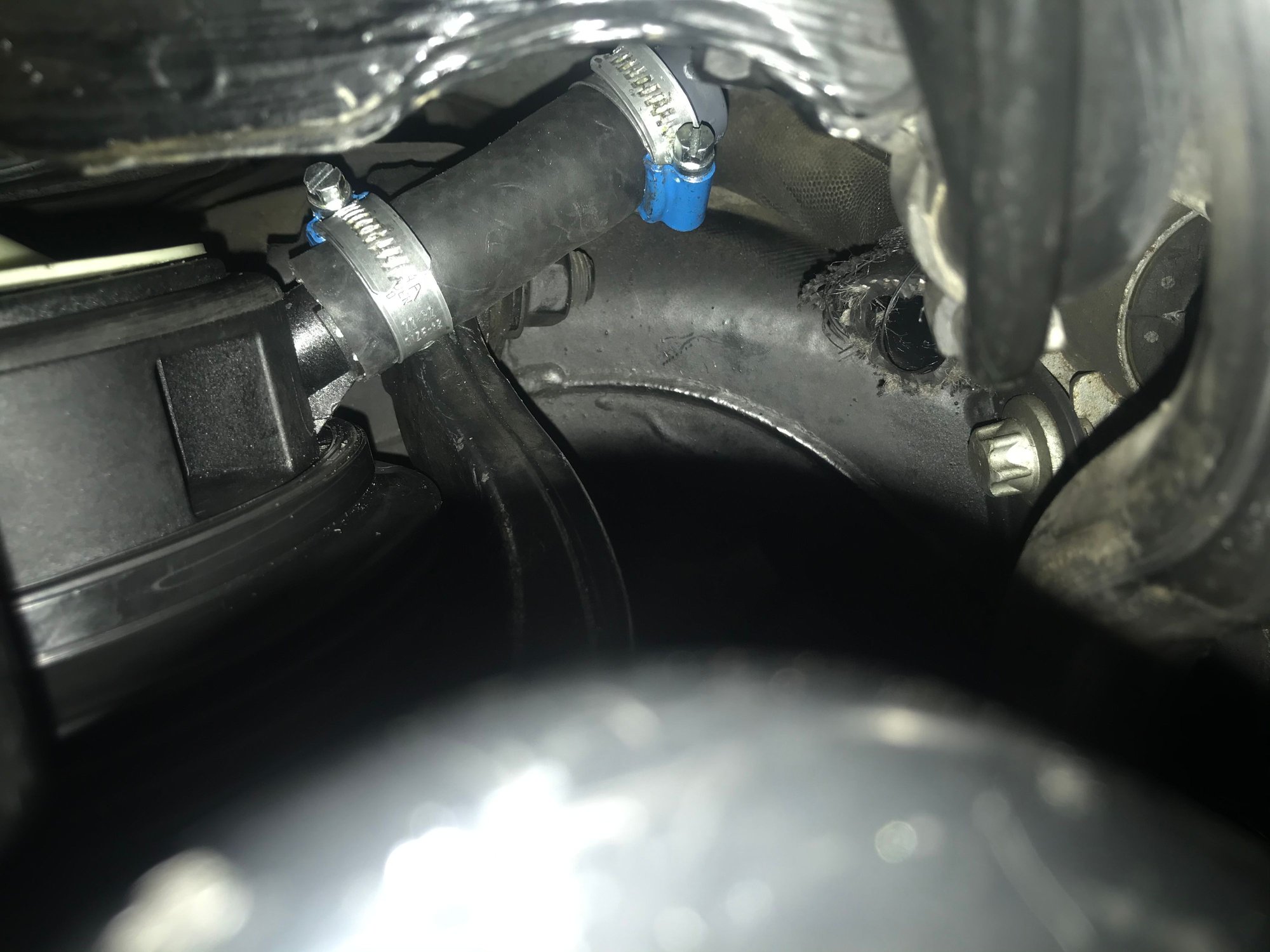

DIY: Bypassing Rear Air Spring Reservoir
Dealing with an air leak from your aluminum tank? Too lazy to fix it the right way or too cheap to drop $700 on a pair of Arnotts?
Well, you’re in luck. Here’s an easy way to stop those pesky air leaks and extend the life of your tired air spring.
Time: 10 minutes
Parts Required:
Swedish-made hose clamps
3/4” PVC insert
Sharp object
Find the kit for $30 at RMT’s website or piece it together for half that.
Locate the only hose going to the tank and find a section where you’ll make the cut. Apply some cutting lube and cut the hose nice and straight. Now insert the plastic piece into the hole, attach hose clamp and tighten. That’s it, you’re done.
After this mod the ride is noticeably firmer, but nothing to write home about. Enjoy your (air) leak free automobile.

Yup. Might not be so easy on smaller leaks from that area.
If you’re replacing a bag with an RMT or any other OE style I’d definitely recommend doing this with a set of fresh hose like you see above.

the tank is just a block of metal, if you go with arnott you can leave it alone or unbolt it and done. this procedure turns your any oe bag into a ghetto arnott by stopping air from escaping through the tank vent hole.

I did this while installing a new air bag. Everything was great for a day but the next day the car was on the ground on that side again. Pretty sure the leak was at the plug i made. I attached a rubber hose piece with a steel clamp and a plug also with a screw down clamp. Any advice to keep that from leaking?

use higher pressure hose
200psi minimum

Thanks for the tip. I only used 150 psi hose

I have not had any issues with raising or using the different modes. I currently have only done one side and that hasn't caused any issues i am aware of either. I intend to do the other soon. This has been a helpful solution for me.
