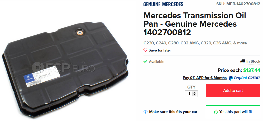

Hop on FCP and grab part number 1402701161 and 2035400253
Old Jul 13, 2020 | 04:14 PM
HLG600's Avatar
Joined: Dec 2005
Posts: 4,059
Likes: 342
From: NJ
2009 SL63 AMG
https://www.fcpeuro.com/products/mer...pan-1402700812
