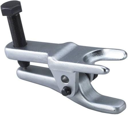

oh yeah ball joint on these ones. get one of these kind of ball joint separator if you dont have already. it makes ball joints easy!

Thanks guys. Releasing the strut was no problem, no real extension of the strut. Did the balljoint yesterday, killed one of my ball joint separator, few hours later it was off. Very stuck but that was nothing when it came to press in the new balljoint. It required tons of force, had to use both arms and legs.
