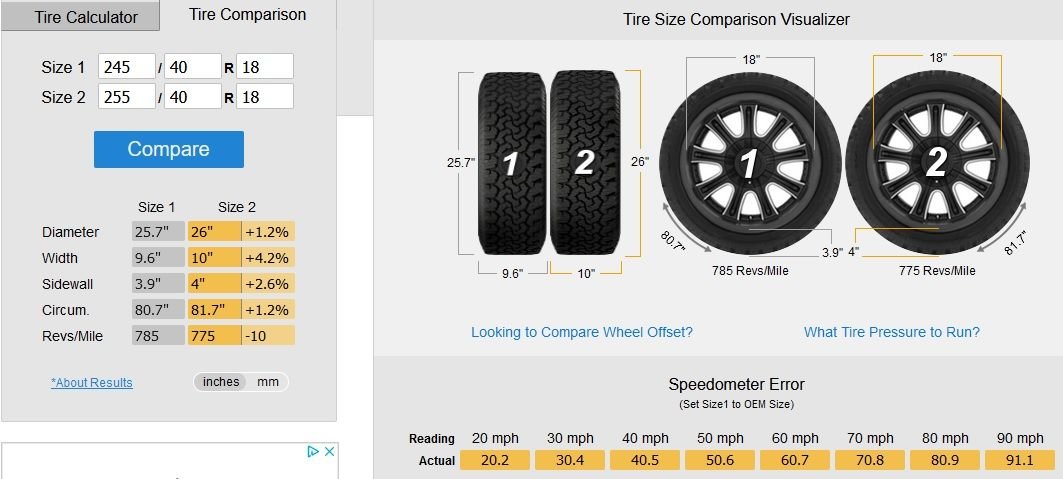

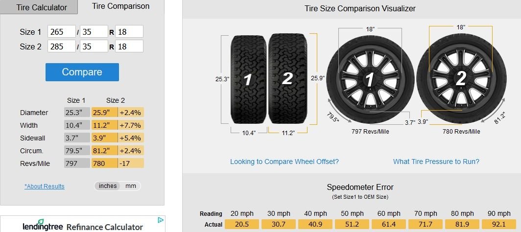

Even more so than tire brands, I'd really love to discuss sizing a bit more. I plan to stick with my factory 18" wheels. If I ever buy some 19's they'll be exclusively for driving around home in the summer and for looking gangster at the local cars and coffee, not for bombing 1400 miles road trips. (full disclosure, I did actually just make an offer for some 19" wheels... but again, that's not germain to this discussion lol).
I would LOVE to upsize the tires just a little bit. A but more contact patch is good for grip and wear, and a bit more sidewall is good for durability and comfort. I know every car has its own constraints on tire sizing, as I'm newish to the E55 I don't myself fully understand what these constraints are. The car is at STOCK ride height, and I don't plan to lower it. I typically leave it at comfort ride height unless I'm mobbing up a canyon, or you know hard parking like a badass at starbucks. of course.
So just for reference, stock sizes are: F 245/40 R 265/35.
We could go with a F 255/40 R 275/35 setup that would give us a bit more width and touch more sidewall. Only a touch, like .1"
We could go with a F 245/45 R 265/40 that does not change the width at all, but gives us a nice bit more sidewall, about .4"
Go full hog with a F 255/45 R 275/40, this starts to become a substantially bigger tire. The fronts are overall 1.3" larger in diameter.

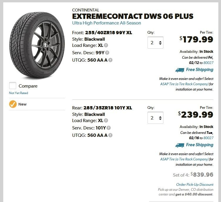

I think I've pretty much settled on going with a high performance all season, I think that will suite our needs well and hopefully keep us out of trouble if we catch some inclement weather on some of our journeys. I know we are giving up some ultimate grip but I think that's okay if I'm realistic about how I use the car and where I feel that its talents lie. I'll admit that I'm also very intrigued with owning tires with 500+ treadwear. We own five cars, and man does it suck when they all want shoes at once.
I think my choices now come down to whether I want to go with the Continental's or the Michelin's. The old adage is: "suck it up and just get the Michelin's", but the Continental's are well reviewed, have a slightly higher tread wear rating and saves about a hundo. I could be swayed either way at this point.
Next decision is sizing. I've mentally debated this quite extensively and I think I've read almost every other tire thread in the forum here trying to see what others have done. I think the best course is to go a step wider in the front and one or two steps wider in the rear. Hopefully the slightly larger contact patch can give me back a bit of that traction, and I get a slightly taller sidewall for comfort and durability. This also keeps the diameter equal front and rear. However... going with stock sizing does save me a bit of coin. To my surprise, going with the wider tires means that my Merc and BMW will wear the same size tire. Might be nice to give the 540i hand me down shoes every now and then.

Yup, after more research I think I'll have to go with that exact sizing because of the 9" rear wheels. I really liked the idea I had up above, but I just don't think that will work without a 9.5" wide wheel.

Thanks for the good discussion everybody. I ended up going with the Continental Extremecontact DWS in 245/40-18 and 275/35-18. Very pleased with the fitment, the slightly wider rear tire matches the front a touch better if you ask me. It was nice to have the beast back out on the road the other day.

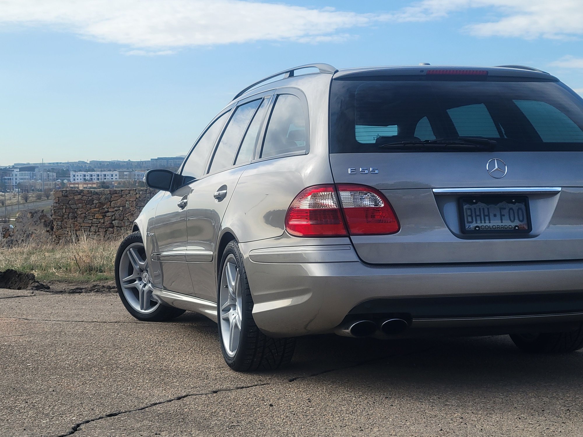

Because threads love photos, our E55 at the Michigan house.
