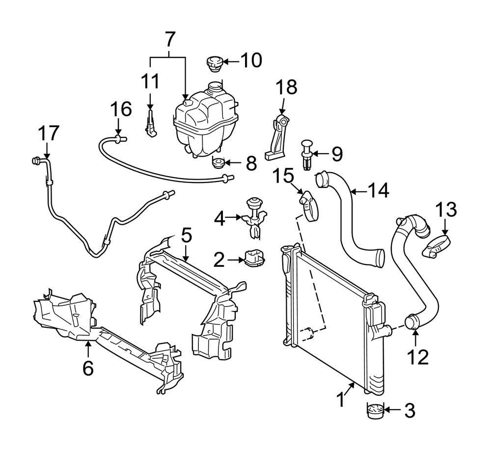

I have a e55 2006 with a very annoying coolant leak, to which I have found to be a metal banjo/connector that has been rubbing away at another metal line/pipe next to it. Took it a few years to chew through but it finally got there.

I may stand corrected, but I believe its part# 17 from the diagram. It seems to go from the lower radiator to the bottom of the expansion tank. anyone have a part number for this? I cant seem to find it anywhere!
Attached is the picture from the MB parts catalog, not just an online image that are often poor. Item #95 seems to be the one that you are indicating from the online picture. If that is the correct item you need, the part number is 211 500 23 72. If you think otherwise now that you have this image, let me know the item number and i can provide you with the part number. Good luck.
