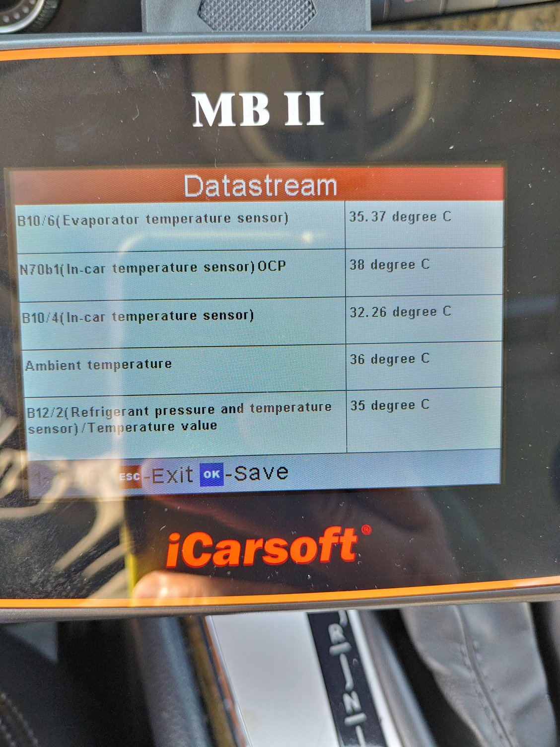

Thank you for the quick reply! The pipes are not cold! I connected my Icarsoft MB2 and ran a diagnostic test. Nothing really seemed to jump out at me. There were not any faults listed. I will take a screen shot of what I see on my diagnostic tool and post the results.

The consumption was 700 what - milliamps? The 70 was - 70%? Was that percentage when the temps for everything including inside the car was in the 35C range?
