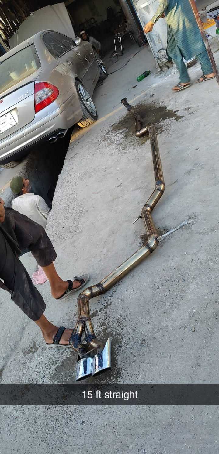

The person i got my car from had straight piped it, 14 feet of complete ss straight pipe (picture attached) however then he added the stock cats to quiet it down a little. When i pulled the car with the cats on it, it smelled very rich so what i did was pulled them out and straight piped it again. The smell was not as bad however it did not fix the problem (because im stupid). Now i feel like its wayy too loud and am considering putting them back on again. Is that setup okay?

Check the intercooler pump, there might be an old Bosch revision on there. The Bosch 010 is a good replacement/upgrade if there isnt on in yet. The way you describe it, it sounds like heatsoaking (IAT too high) and then the ECU cuts power.
Exhaust is all personal preference, I only have center resonator delete on my CLS55 and it sounds how I want it. Also the police is cracking down more and more on loud exhaust cars here in the Netherlands.

Just know that almost every E55 is a project at this point in time. There are very few clean, unmolested, and properly maintained E55s being sold right now. And if they are, they are going for a high price.
Your car looks pretty good. If the exhaust and air suspension are your only issues, then you are in good shape.
Exhausts on any car are difficult to get "right" and very, very easy to mess up. I would try to find a stock exhaust and save yourself some headache. A straight-piped V8 is, "a great place to visit, but you wouldn't want to live there."

It's way to loud of course with no mufflers but there is no X-pipe and you really need that to balance the exhaust flow and sound and will sound like sheeet with out it. Either way no matter what you do cats-no cats....add the cross over.

Any DIY xpipe i can do. its close to impossible to get it imported from the US where i live.

i completely agree haha its wayy too loud and it gets boring pretty quickly. Im wondering if a x pipe can make it sound nicer? i do want it to be a little louder than stock tho.
An x-pipe will make it sound nicer...but it will still be very loud. There are a few videos on YouTube of people who've done x-pipes with this car.
I (and your neighbors) highly recommend that you get mufflers. Don't be "that guy".
You ever notice how when people on forums or YouTube start messing with their exhaust for "that perfect sound" that they keep messing with it? It's because it's very difficult to get right and very easy to screw up. And at the end, they have a hacked up exhaust system.
The stock exhaust is "meaty" and lets people know that you have a V8. It's not as loud as modern V8s and especially modern AMG V8s, but it's pretty good.
If you really want the best of both worlds, maybe make a stock system with remote controlled valves to open up when you want to show off? I've considered that as well. This is a common mod, too.

Don't forget that sound (and the appreciation of it) is very subjective.
@CQHall I totally agree with you that the stock exhaust is good already. I only have the center resonator delete and I think its the best of both worlds now. when coasting its nice & quiet and when you floor it you get the nice rumble. But I can also understand that people want a (little bit) more exhaust note
@muddy51 if you want to have it a little bit more loud than stock, then try to source some original mufflers (or W204 C63 mufflers) or some good stainless aftermarket ones. This is how mine sounds at the moment
