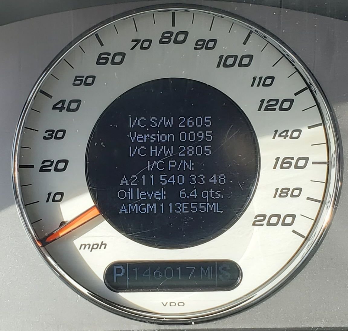

My car will read the oil level in that screen with the engine off. Full it generally reads 7.1 - 7.3 quarts. The "regular" oil level screen will just say add a quart or level OK.
My car is parked on a slope, so the reading is wrong, but this is how it displays for me:
How long after entering that menu does it take to display the oil level? I waited over 2 mins...nothing.

My 04 W211 1st key on positioned, 3 quick pushes on the dimmer switch brings up diagnostic menu and oil level with out the level numbers (similar to your picture) a second turn of the key produces the oil level with numbers.
1st position only SRS light on
2nd position gives the x-mas tree effect
