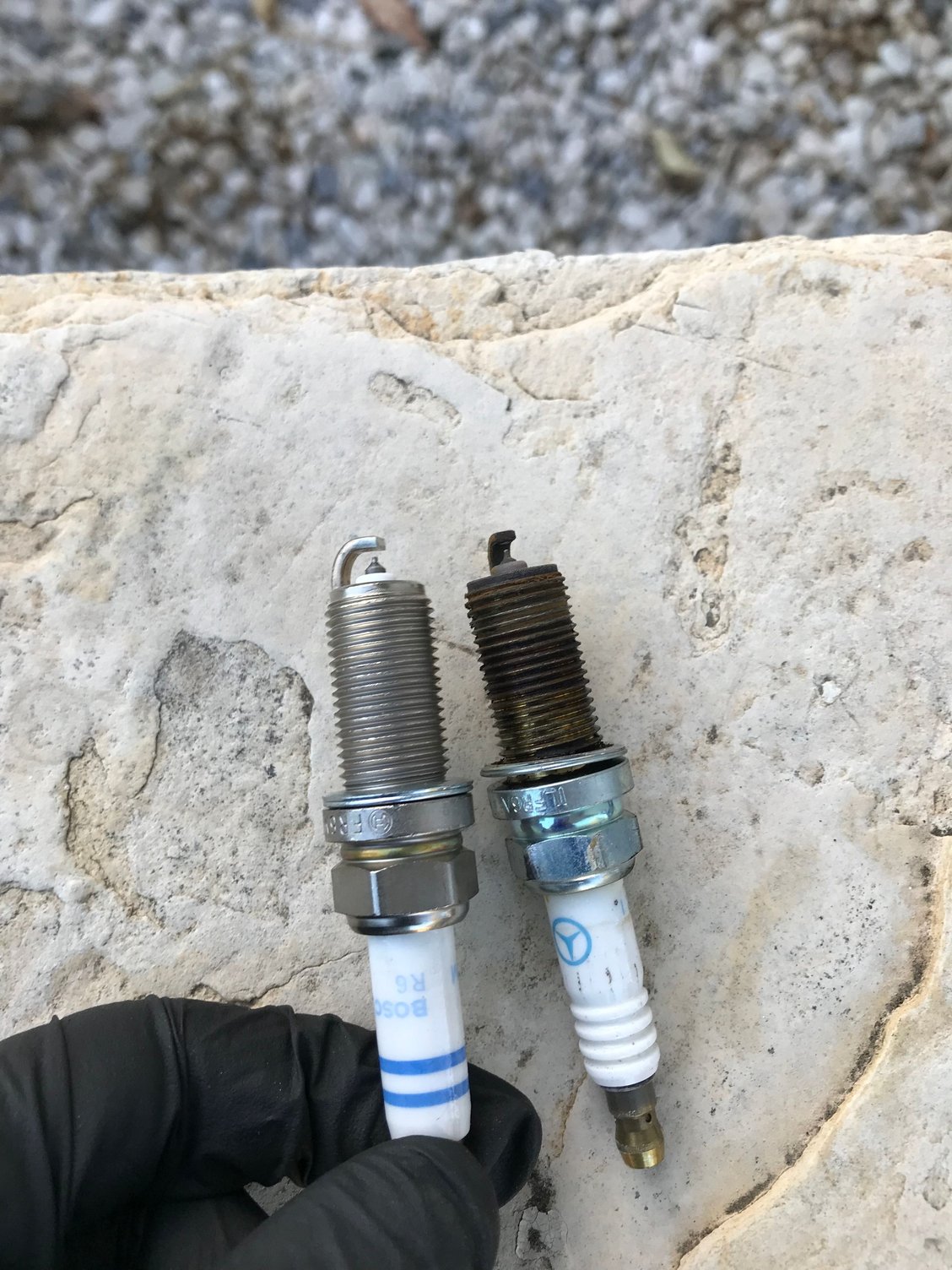

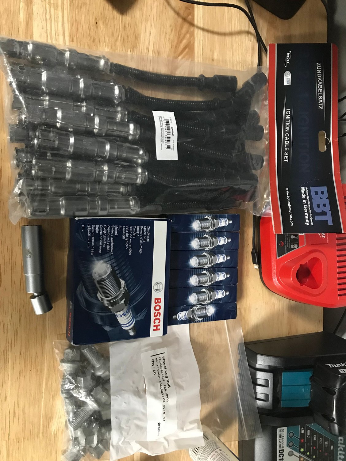

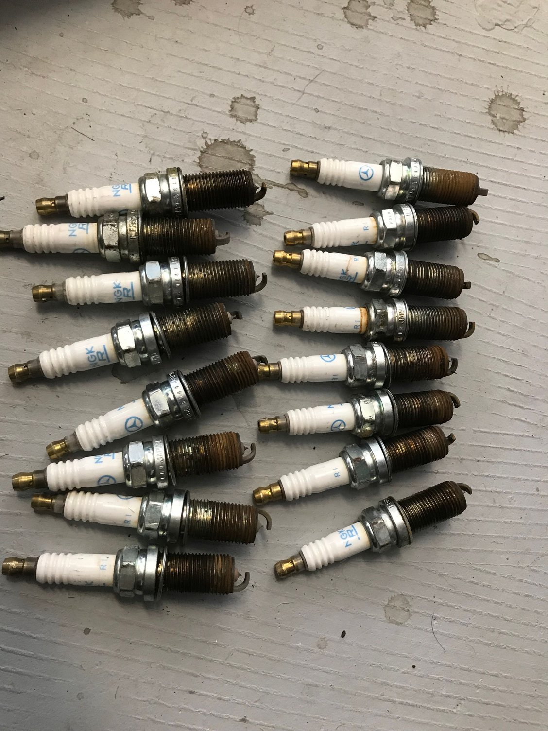

4) BBT plug wires and Bosch Double Platinum spark plugs (DIY)

From experience, the Bosch, Beru and whatever sparkplugs don't work well with this engine. NGK 3588 ILFR6A works fine on the M113 ML. Bosch ignition wires are good, they usually work with no issues.
