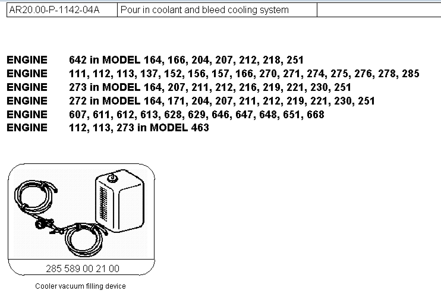

Official WIS procedure involves using a vacuum bleeder...

maybe for a m113k and its secondary heat exchanger… this is a m156

I checked for the CLS63 C219 in this case

Same for W211 E63

You likely have air in the system and maybe specifically in the heater coil. Fully warm the engine and drive it for a few minutes with the heat set on high. Park it to allow the engine to cool down. Check the coolant level in the reservoir and it will likely be low. Add coolant to bring it up to the proper level and do the warm up-drive cylce again. Again after cool down check the coolant level and top up as needed. You may have to do this several times to get all the air out. This is the reason MB has a vacuum procedure as it only takes once to get the air out. But without it you can do it this way - it just takes longer.
