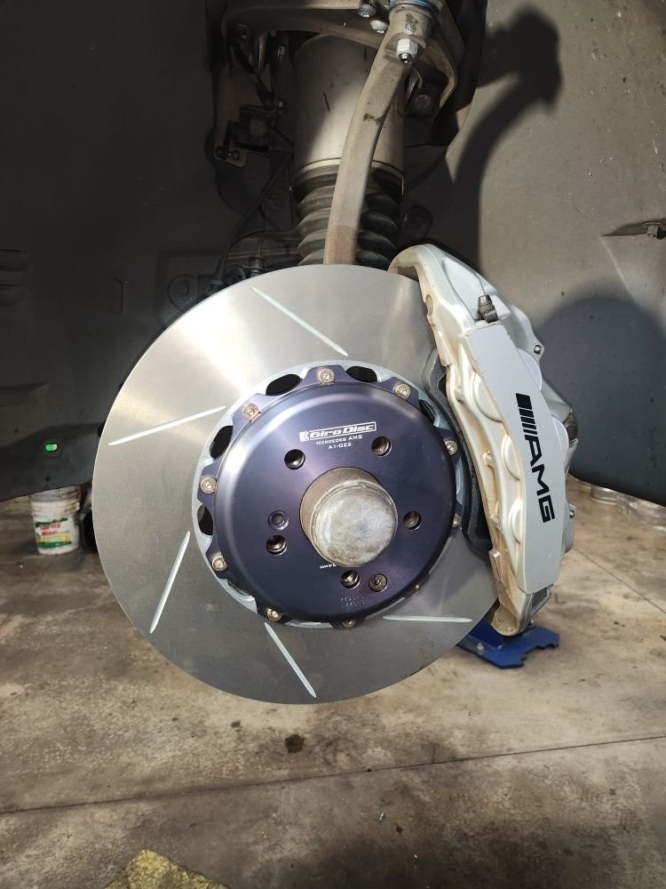

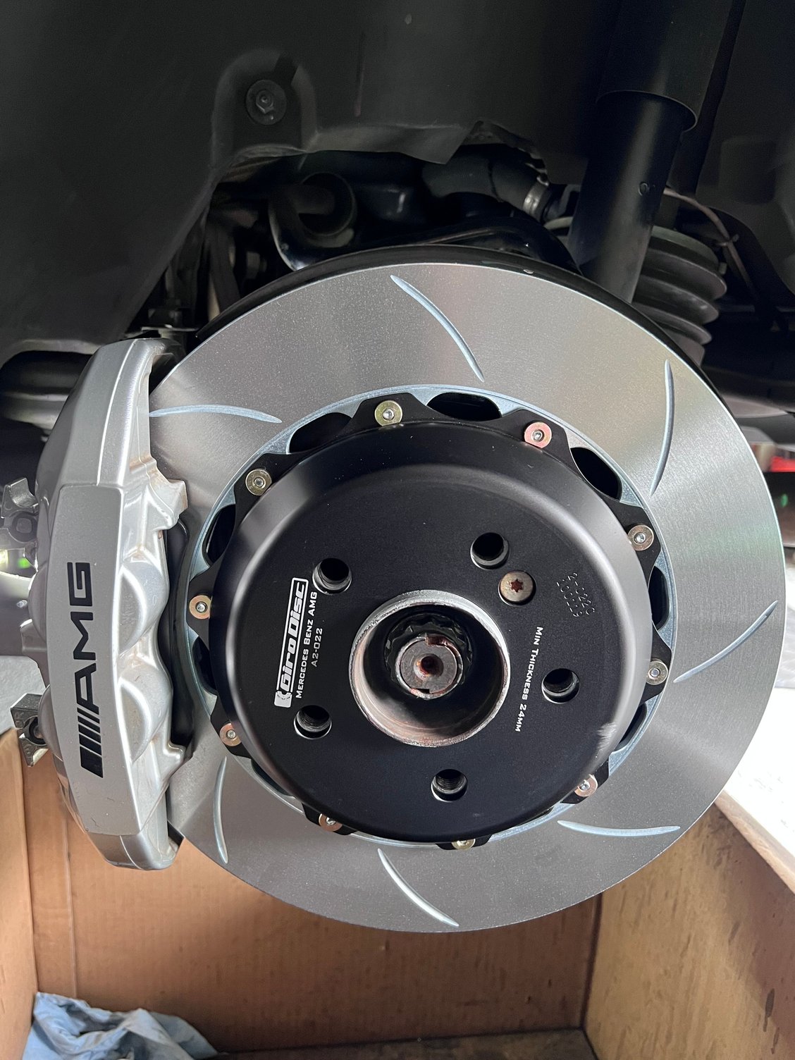

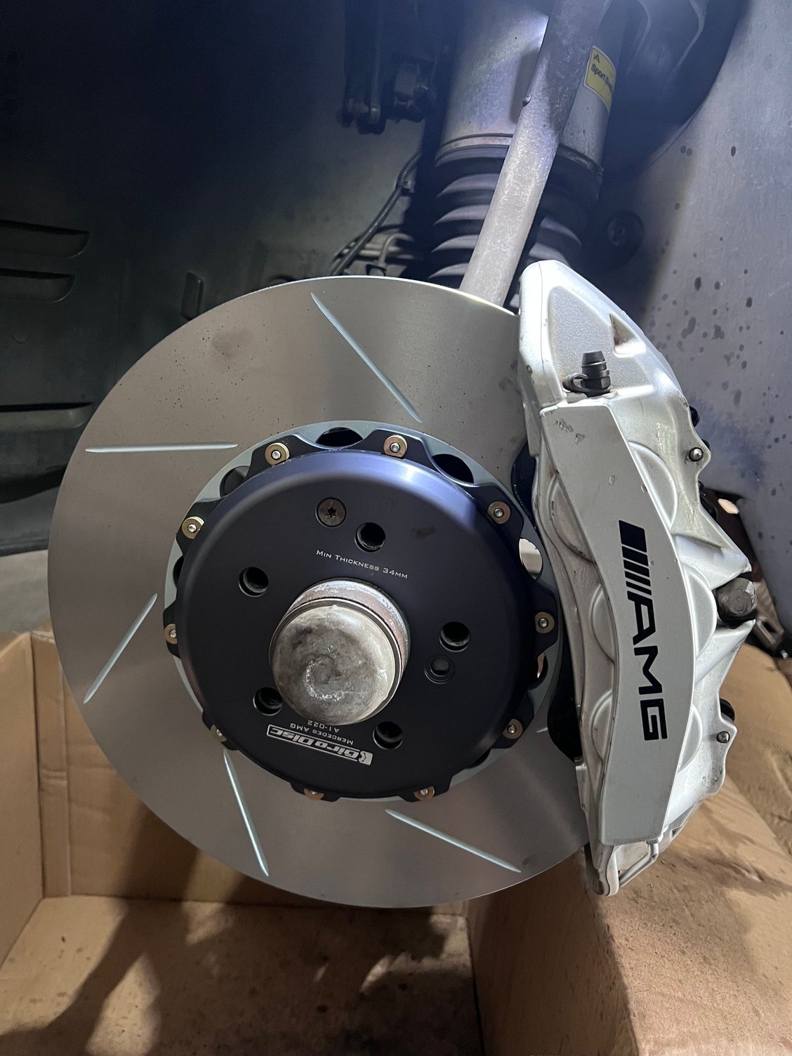

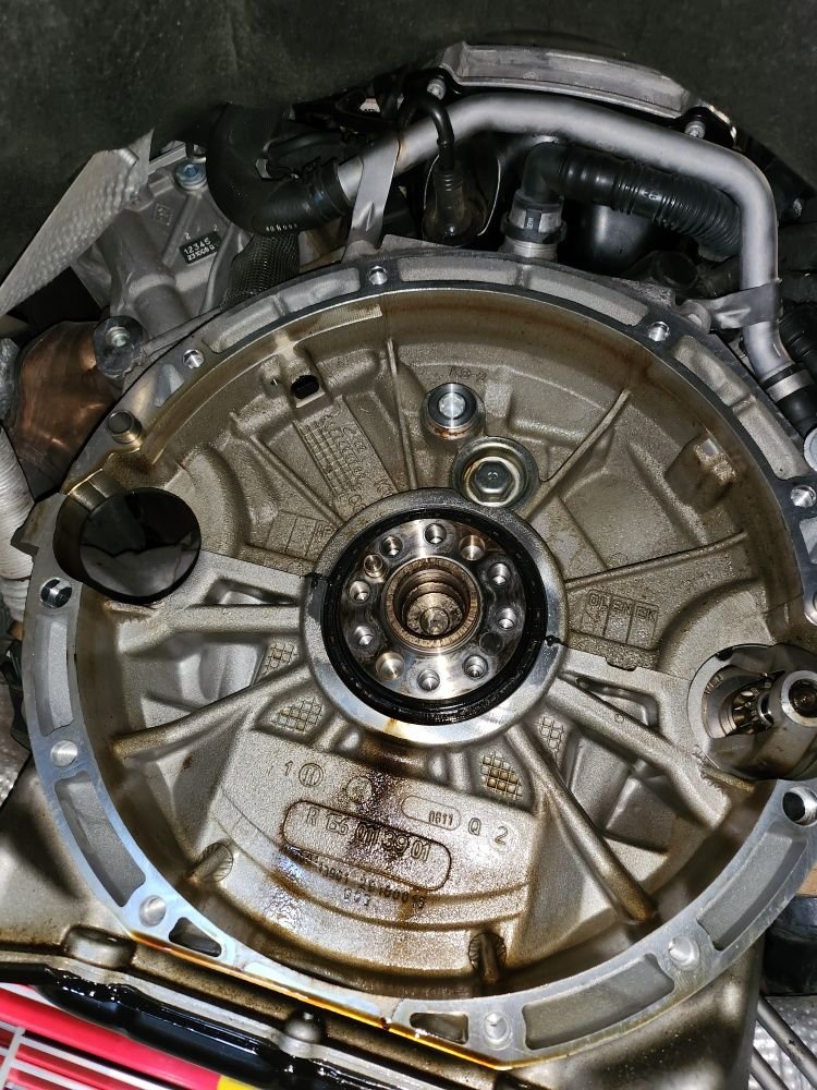

Having a bunch of work done to my 2009 E63 P30 at Blue Ridge Mercedes in Atlanta.
I have been losing oil from a bad RMS over the past 2+ years, which is irritating from the oil drips as well as the oil blowing onto the exhaust. Having this addressed - see pic below of the bad RMS. Big job - exhaust and driveshaft have to be removed, tranny has to be removed to get to the RMS - $50 part and $3k of labor. Also having an air/oil catch can installed to try and keep oil out of the Intake Manifold. Since my car has 136k miles on it, many of the front suspension joints need replacing. Finally, I am having a pair of front Giro Disc rotors installed and new Porterfield ceramic pads. The rotors are from Frozen Rotors and are cryo treated. Should last a long time. Another expensive service....

$3k for rear main seal at the dealer is crazy. Could have gotten it for half of that at a Indy shop. But I know somtimes it’s hard finding a trustworthy Mercedes Indy shop. I went with Hawk ceramic with my girodisc on the sedan. They feel like OEM in terms of bite. I have portifield on my wagon with brembo rotors and do they bite a bit better.

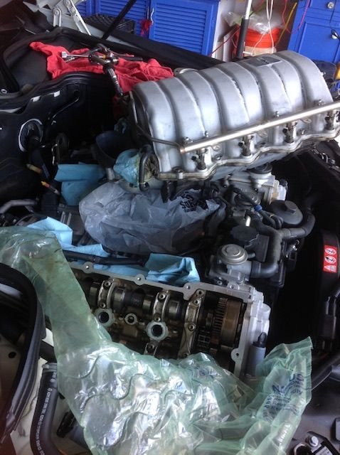

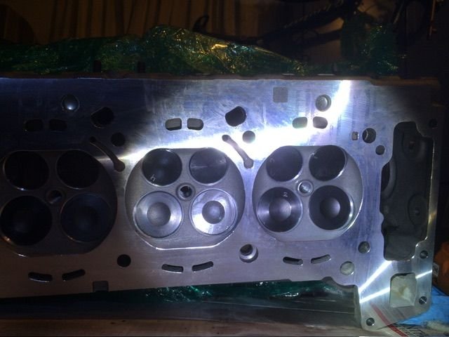

Also 1st Phase Build, just removing the Intake to discover how Carbon filled the Intake Runners were which caused me to have the Heads Rebuilt!

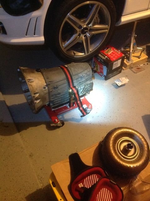

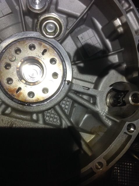

2nd Phase-Rear Main Seal
The Tranny obviously had to come out

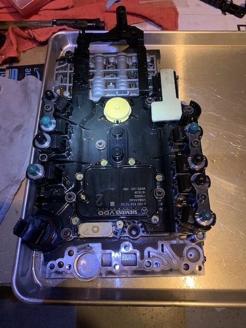

The Tranny’s Valve case below with its TCU on top. I took it out to Clean the Valve case itself, which was filthy, but then had to remove the Tranny again to have the TCU repaired several months later! One of those coulda shoulda moments!

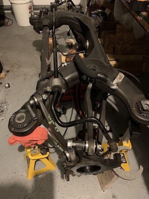

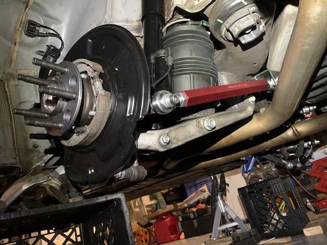

Here is the Subframe and all of its replaced components (subframe Bushings, Control Arm Bushings, new Torque Arms and its corresponding bushing in the wheel carrier, diff mount bushings)

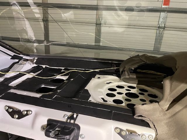

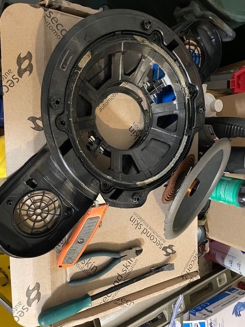

Current 3rd Phase-Rear Deck after removing the worthless Subwoofer! Just look at that flimsy thing just to the right! I’m installing 5” Surround Speakers where the 2 1/2” one previously were installed located with a JL Box Subwoofer in the trunk, Stereo Integrity 6” in the front doors, Stereo Integrity 3” in Pods to be in the A-Pillars, Focal 6” Coax in rear doors with Dirac Mini DSP>Gladen Amps (5)(4) and an Amazon Special to provide 50 watts to the front Tweeters and a Joying HU and CD Player to be hooked up via Fakra to GPS and radio, Via UBS to TPMS, Front DVR Camera, CD Player as well Rear Parking Cam with Bluetooth!
3rd Phase Build started December 23’ and continues to this day!

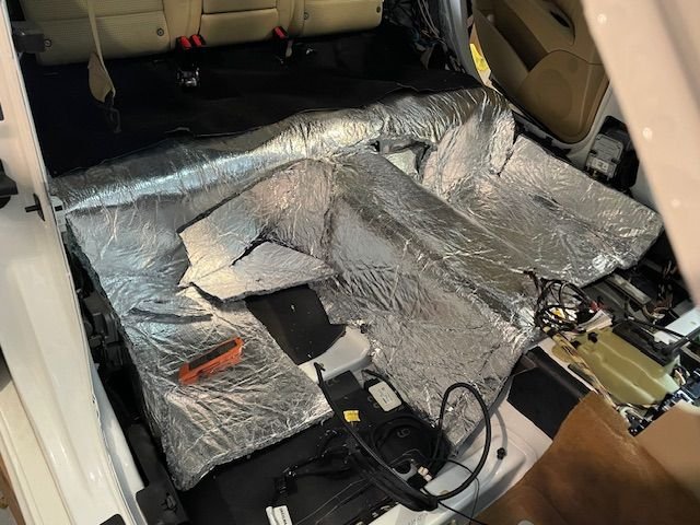

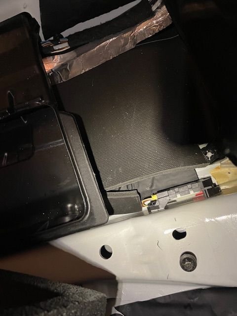

This is the Second Skin Damplifier Pro CCF/Vinyl layer cut out, but then installed over the HeatShield (next Pic, which is over the SSDP covering the Metal Floors. All hollow crossbeams are also filled with Thermafiber to dampen the Bell-like sound that happens when you hit them!
This is the Heat Shield prior to my relocating the SS Luxury Liner over top on both the rear seats and the floors.

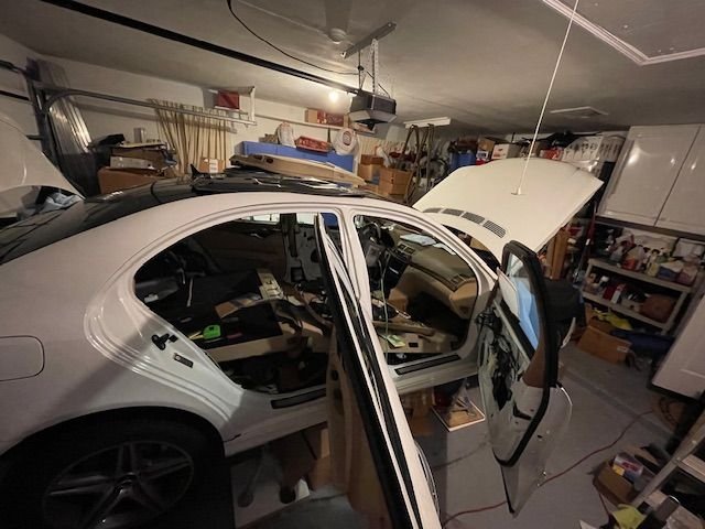

My ride as it appears currently in my Garage!
