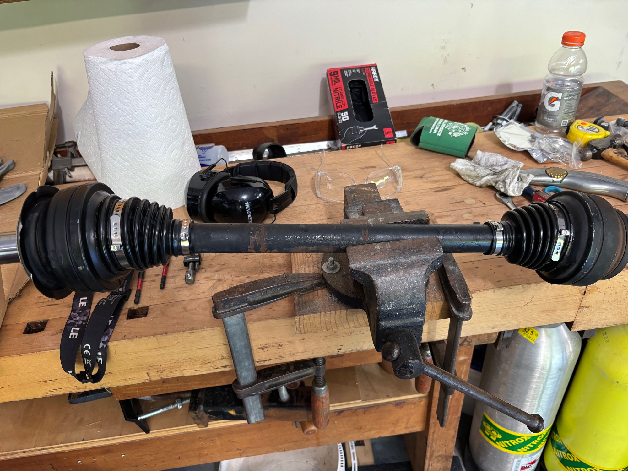

Originally Posted by Luftpost
Finished up CV Boot replacement job this morning which included a successful test drive. Overall it went very smoothly, but not without the proper tools. I ended up buying the proper clamping tool for the boot clamps as recommended above and also a CV Boot pneumatic expander tool. Without those two devices, this would have never gotten done. All for under $100.
Thanks to this site and members for the assistance.
L
Did you use the boots that came with the spreader or different ones?
The ones that came with the spreader kit. I did cut them down a bit (with a fresh utility knife blade) as they probably would have also fit onto a John Deere combine. They have several steps in the boot itself, that are designed to be cut away, for a more custom fit.
The spreader was just barely big enough to get over the one side. Any smaller and it would have been a no-go. It was kinda scary seeing the boot stretch as much as it did over the spreader. I put on a headset and safety glasses in the event things let go. . Attempting this without a spreader tool to me seems impossible.
Here is another photo of both ends completed. To be fair, I should also mention that I have a lift in my garage, so that help access immensely.
L
