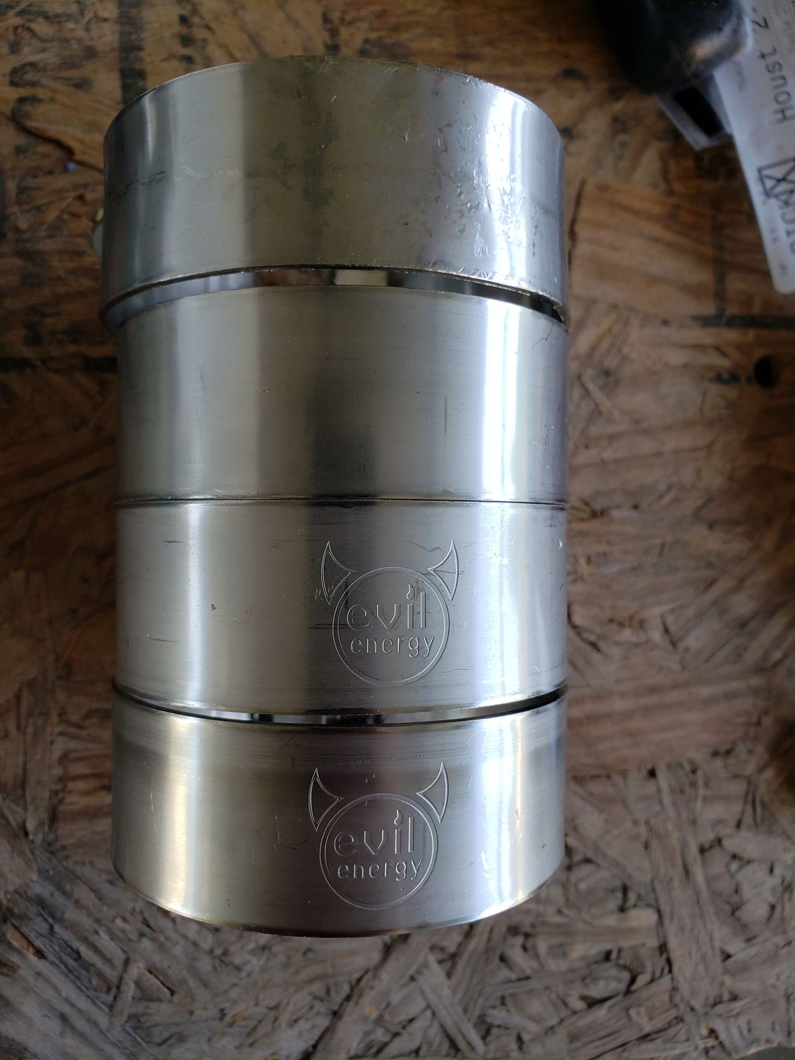

Items arrived from fabtech-performance withing 5 days. Everything was packaged nicely. However one of the clamps was bent. Contacted seller and they sent replacements promptly. Some of the clamps were "evil energy" and some were non-banded. Even though both were the same diameter, "Evil energy" clamped on tightly, non- branded did not.
Long tubes and mid pipe with hardware
