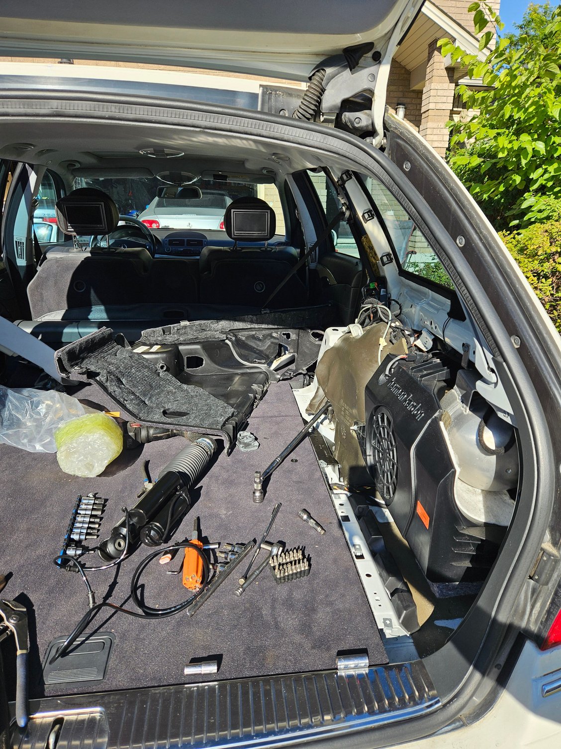

Well, one rear shock just blew out, and the other has sprung a big leak...those look like a fun adventure to try to source!

Lots of progress this weekend! I replaced both front thrust arms, the upper and lower ball joints on the driver's side (I received defective parts so couldn't do the passenger side)--that turned into a massive undertaking!
Also did the rear shocks. I'm looking forward to going for a drive!
