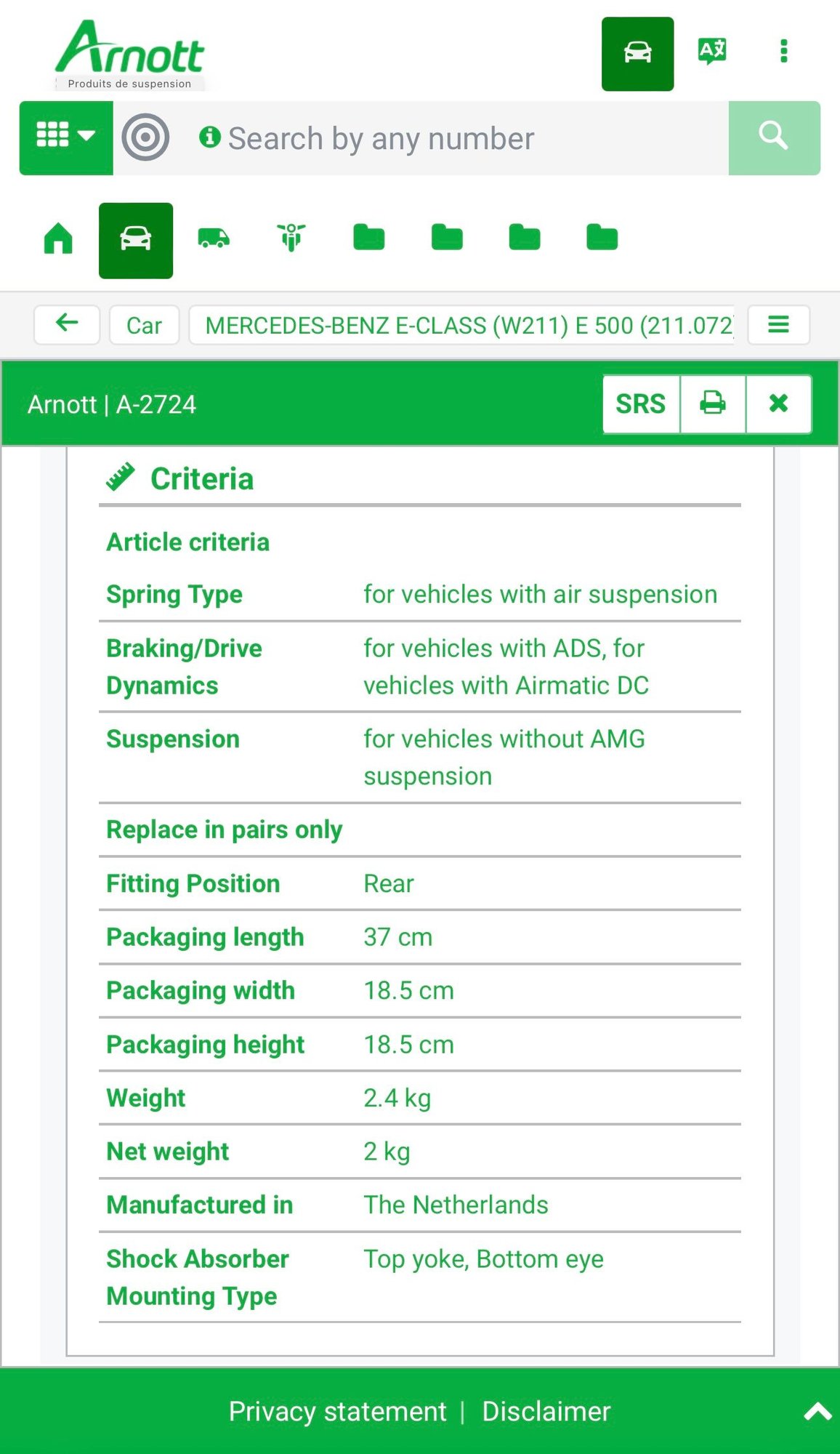

Here in the US the A2724 is listed as the rear air spring for the non-AMG models such as the E350 and do not have the features the AMG's have. .

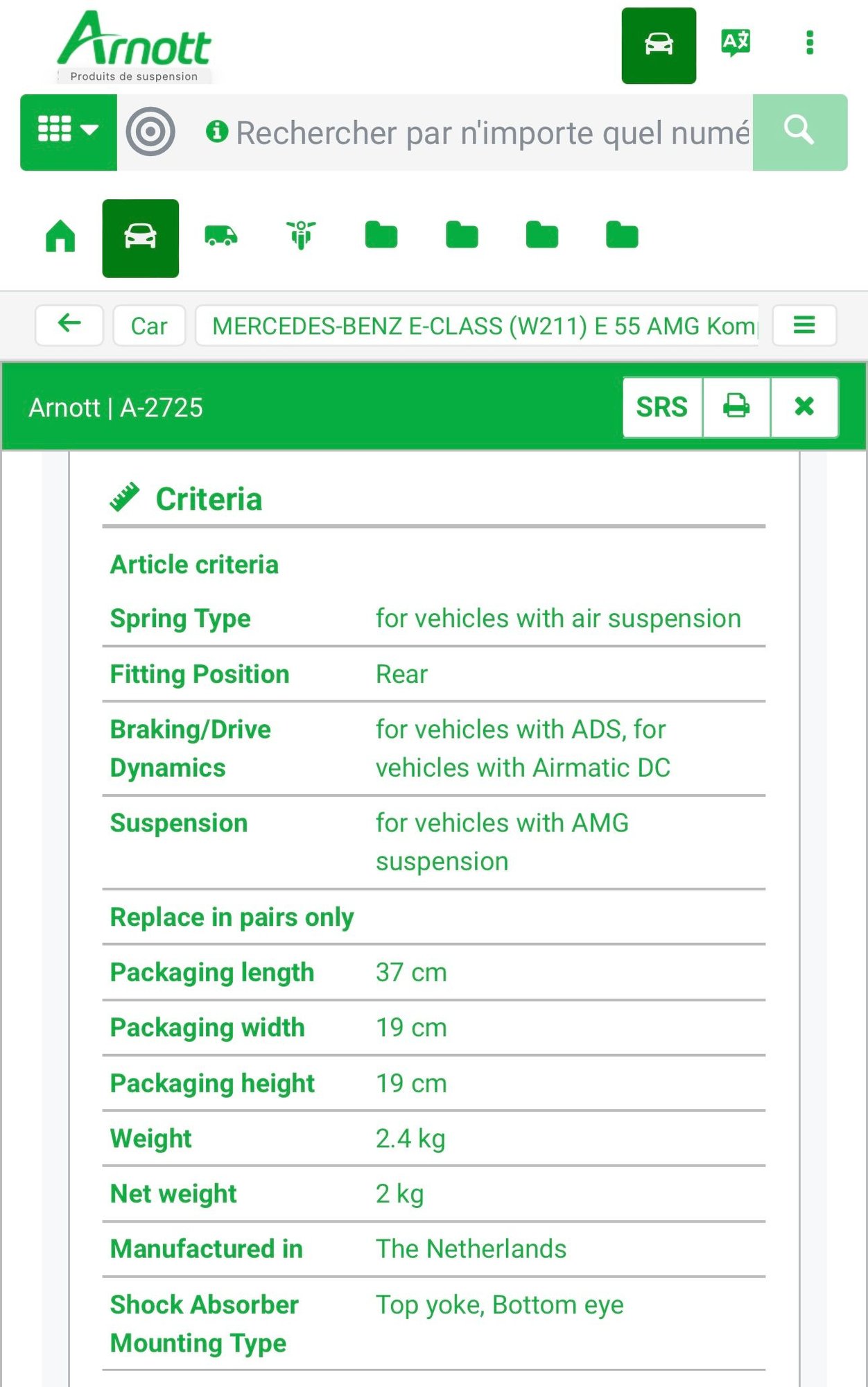

good evening friends so today I received an email from arnott with the difference between the A 2724 and A 2725 and there is absolutely no difference between the two unless I'm wrong my I don't think here are the pictures

Go to the following link, download the .pdf attachment, and learn about the Airmatic suspension.
https://mbworld.org/forums/e-class-w...ml#post9060765
If you have an E55 AMG, you have three modes for the suspension: Comfort, Sport 1, and Sport 2. Comfort mode uses the external air tanks attached to the stock air springs. Using the Arnott air springs, the external air tanks are cut loose, unbolted, and removed from the car. This leaves you with Sport 1 and Sport 2 modes. For the rear of the car, Comfort affects the air springs (by opening a valve to the external air tanks for a softer ride). Comfort, Sport 1 and Sport 2 affect the rear shocks' compression and rebound damping. Read pages 32-39 in the .pdf attachment in the above link.
You want the A2725 air spring. It is a known fit and recommended by Arnott.
