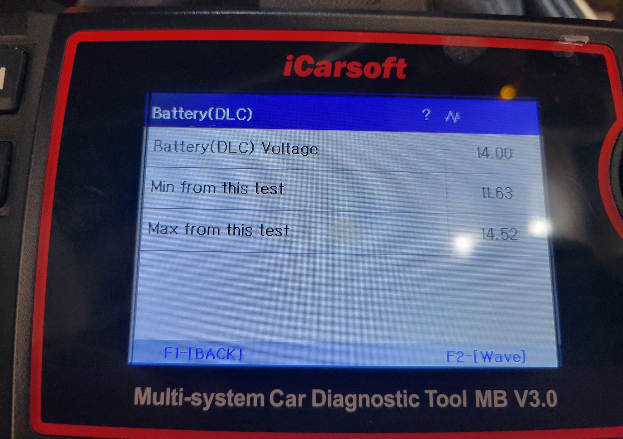

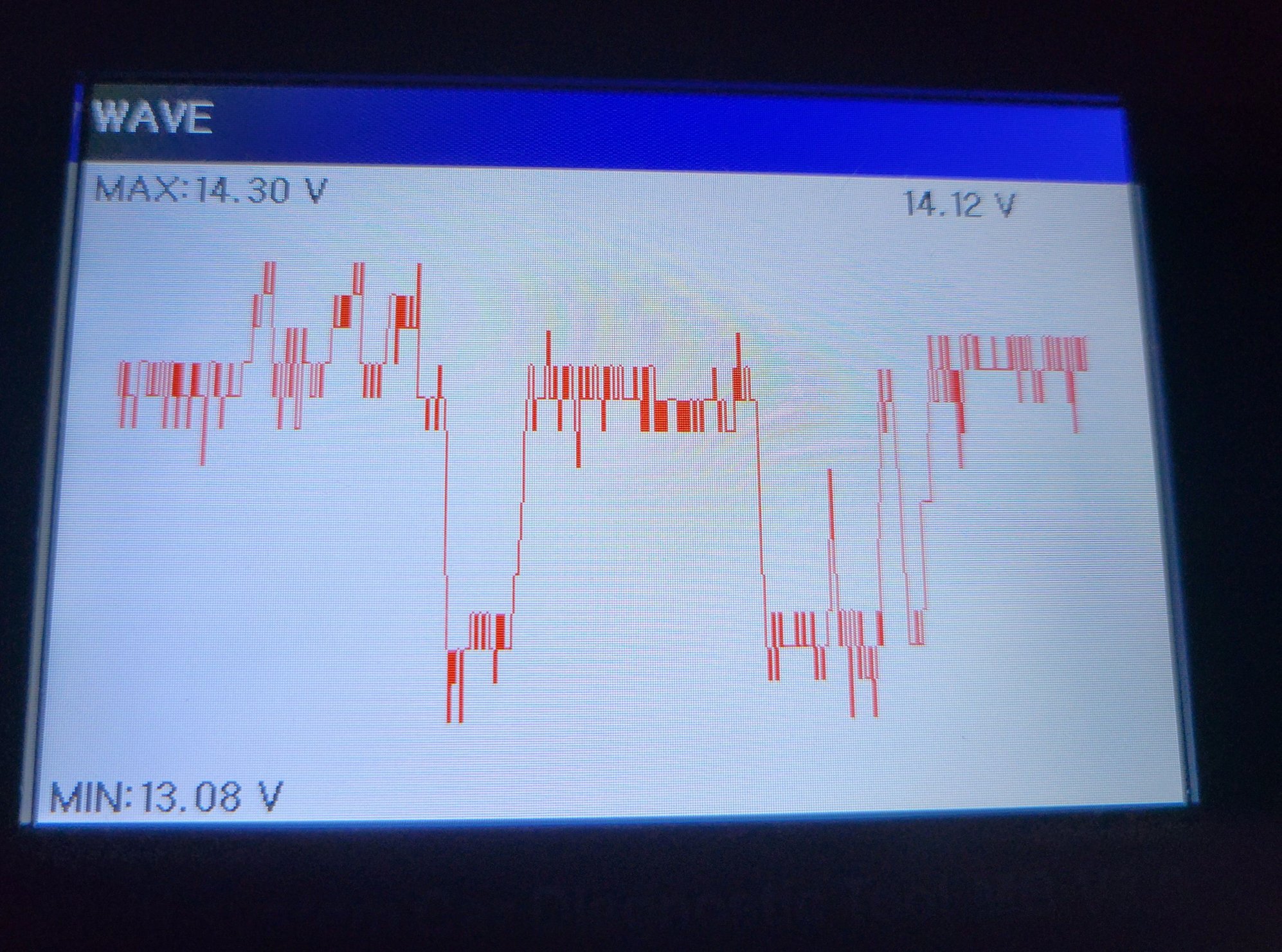

Took it for a ride last night with the scanner hooked up. 1st photo was during start up & idle hence the low 11.63v 2nd & 3rd are while running.
It does seem odd that it takes a few seconds before it starts charging & I see the voltage jump to 13.5 - 14.5. But then again I never paid attention to it before.

The 11.8 was with the car off & directly from the battery 24hrs after driving it. I agree it shouldn't be that low and why I'm hesitant to blame the alternator since it appears to be putting out the proper amount of voltage & has a decent wave pattern.
I was hoping someone could point to specific data showing the alt is faulty and not the battery.
