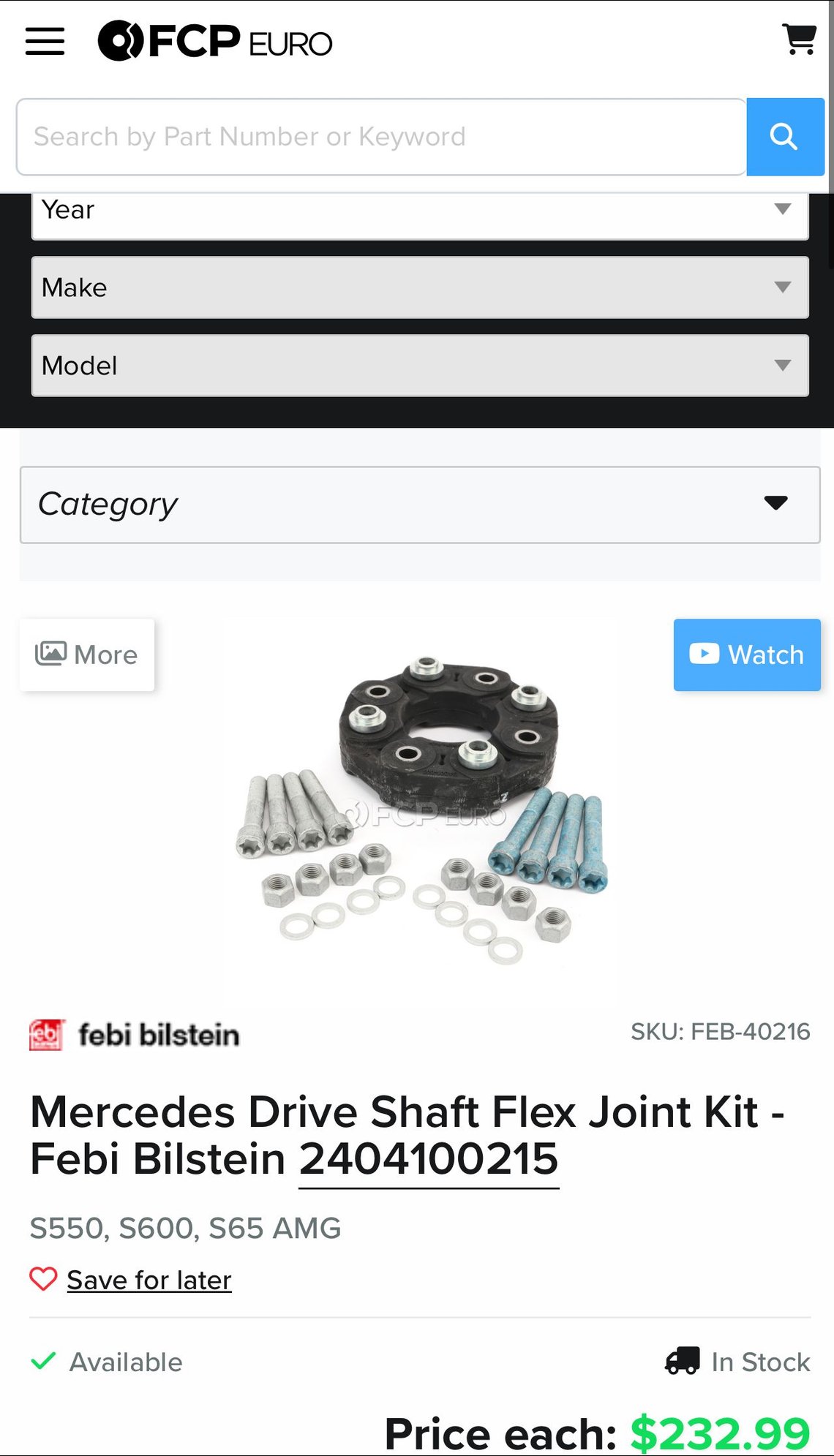

Found this … spacers attached.

Nice find. How did you find it?

I dont get it. When you search that part number only some of the manufacturers has the shims

Found by accident - Ive found another used one on eBay (with the buttons attached). On its way.

Seems clearly a difference in application front vs rear flex disc - and again only on some cars. WIS says nothing about it.

Have you received the flex disc or better yet, installed it?

1) Added flexdisc washer spacers
2) Lowered prop centre bearing 3-4mm to reduce angle of attack into diff.
3) Raised front of diff (with the notched washer) another 2-3mm.
4) Tried to test and even out the angle alignment (as stated in WIS) but access to the prop was tough with exhaust still on car. Rear shaft is within 1deg of front section.
Doing all this the flexdisc looked dead straight and not waved anymore. I would say the main effect was the diff notched washers and lowering centre bearing. I honestly don't know what the flex disc spacers achieve (by the way you need to use longer OE bolts with the washers). But not touching the car for a while!

I have no idea what those flex disc washers do … any engineers out there who can give some insight?
