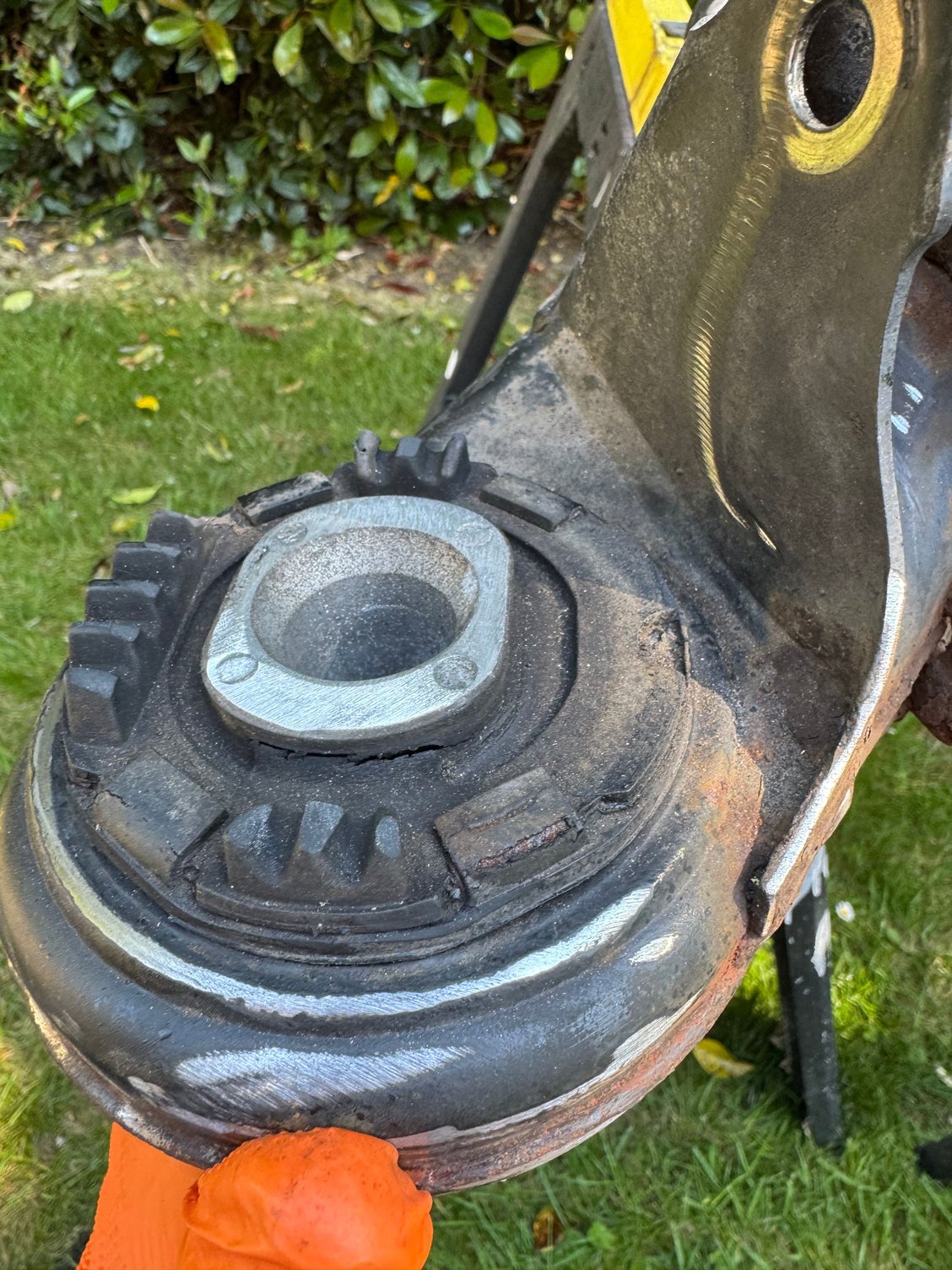

So found crack in two of the rear subframe bushes - although doubt thats the cause of the vibes.

Getting old bushings out was non trivial. One interesting thing the foremost subframe bushes seem to be a floating design. The old ones were completely bound up in subframe.

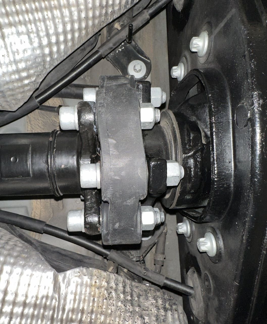

So I have one really annoying issue. The rear flex disc has a wave to it. Ive triple checked the install and no matter how I fit it the same thing happens. The gearbox side is plane straight. To be honest the disc needs to flex as the prop does not come straight into the diff there is a slight angle to overcome (which is causing the wave flex). The old flex discs felt quite hard with not much give. New ones appear have more flex. I may add some shims to the centre bearing carrier to take the angle of attack into the diff down a touch. Overall mammoth job - but the old airbags and shocks (while still working) were very badly corroded. New Bilsteins gone in.

So bad news…
After and extended drive … there is absolutely zero change. Vibration is exactly as bad as before.
So… now…?
I am thinking
Diff / Quaife LSD backlash offspec
Diff issue (its a 2.82 geared SL55 diff)
Gearbox
Half shafts
Wheel bearings
Prop alignment / Guibo Fitment -

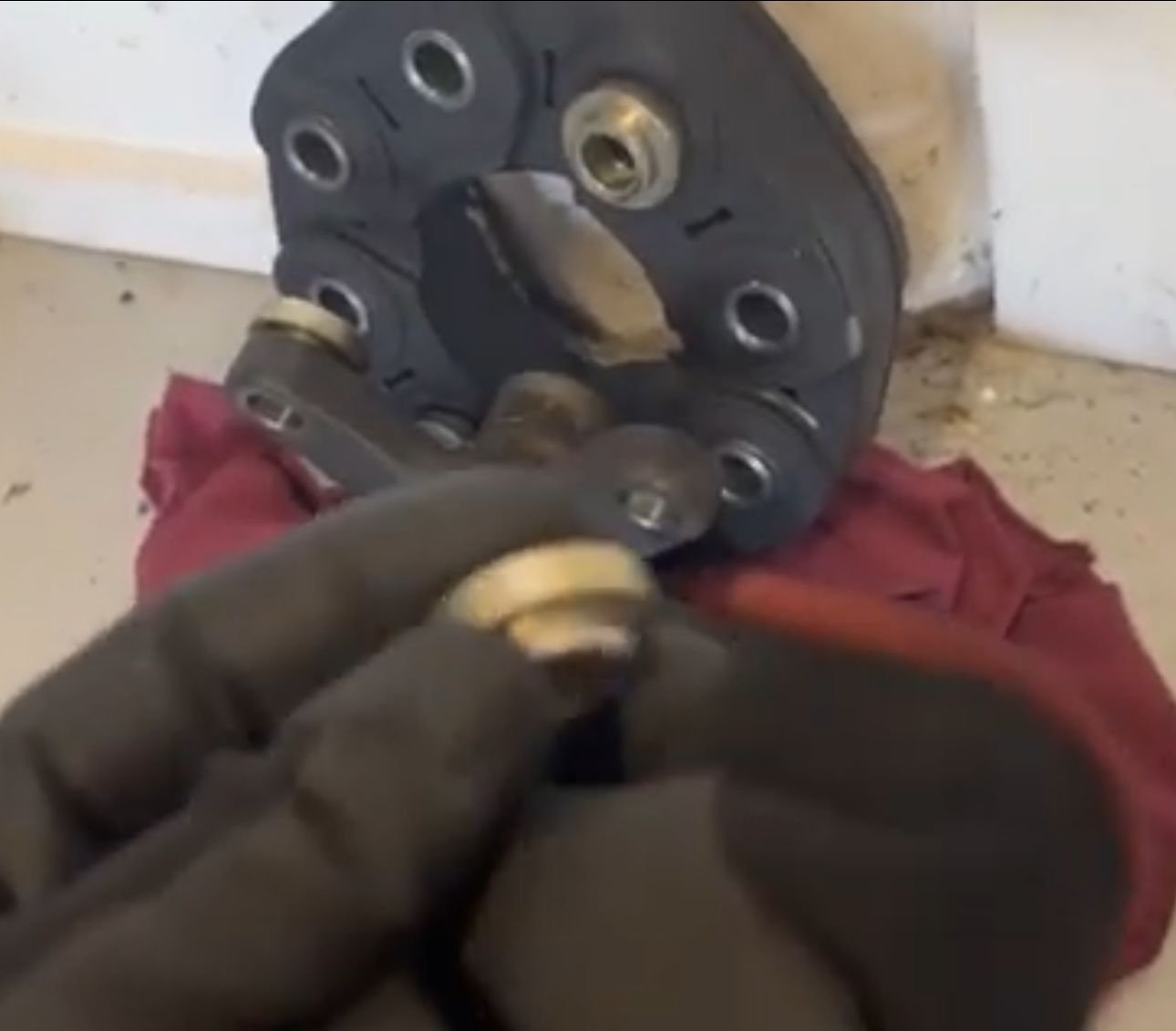

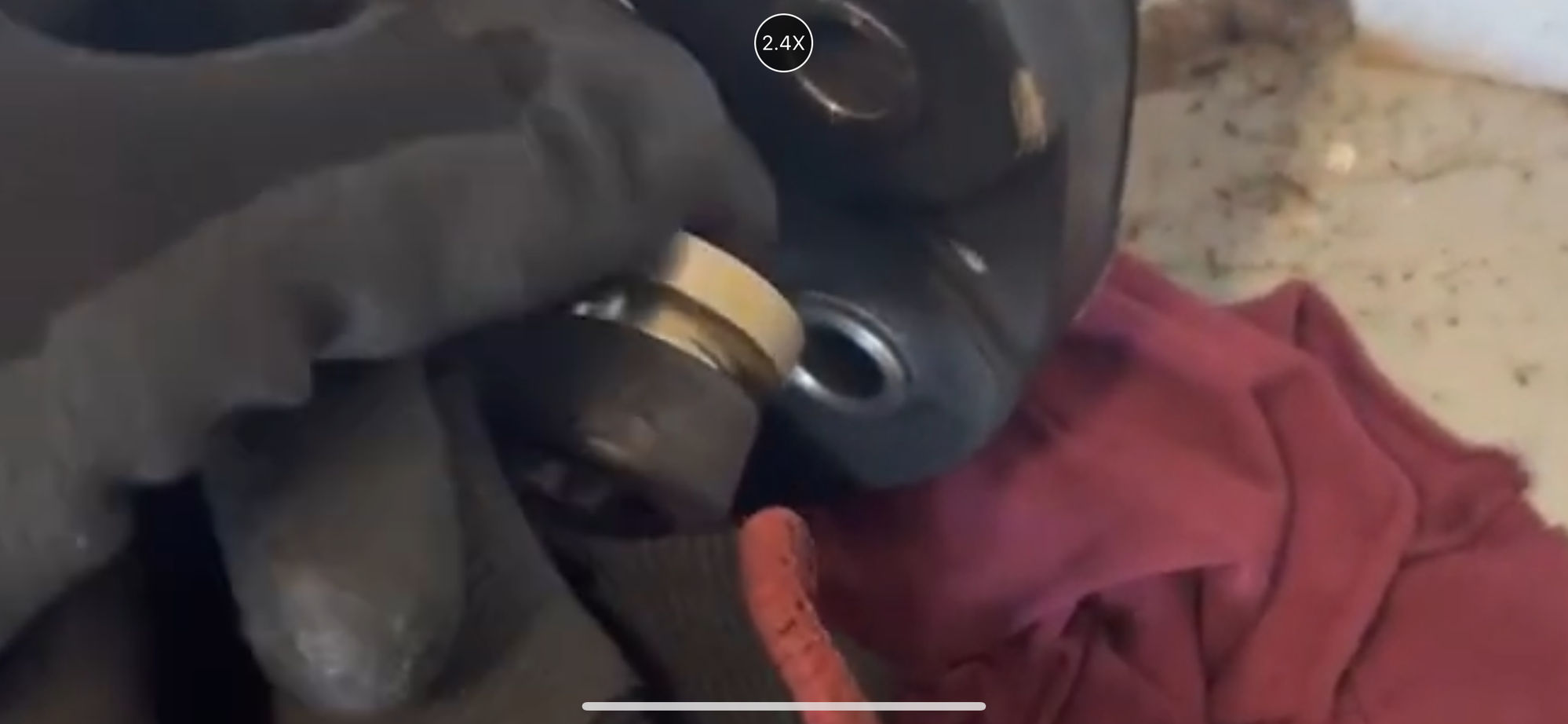

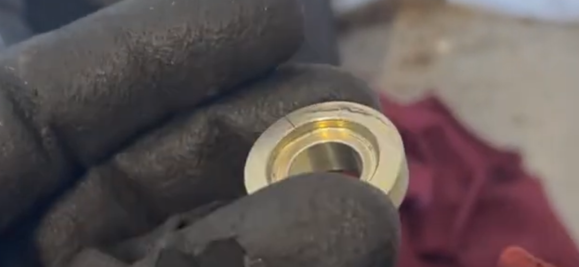

So on this prop Guibo fitment - I saw a video of a guy in the US changing shocks and rear airmatic on a W211 E55 - and I noticed something different on the rear prop to diff mount … there appear to be spacers / washers from the prop side to the Guibo (see silver spacers in picture). These I do not have on my prop/Guibo. Can someone confirm this fitment / part? This is not the washer on the bolt in the foreground but the silver (spacer?) between the Guibo and the prop.
I am almost losing hope here 🙄🤬

Old Jun 1, 2025 | 04:21 PM
Papieye's Avatar
Joined: Sep 2014
Posts: 110
Likes: 10
W211 E55 AMG
There was no spacers on my original discs but i see what youre saying.

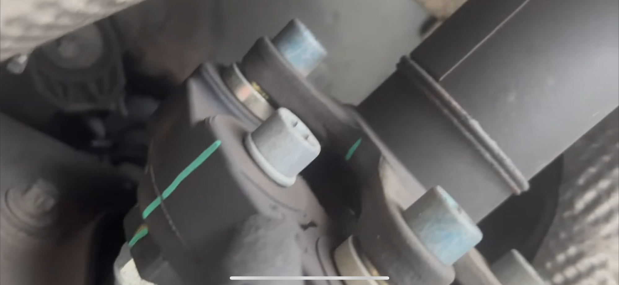

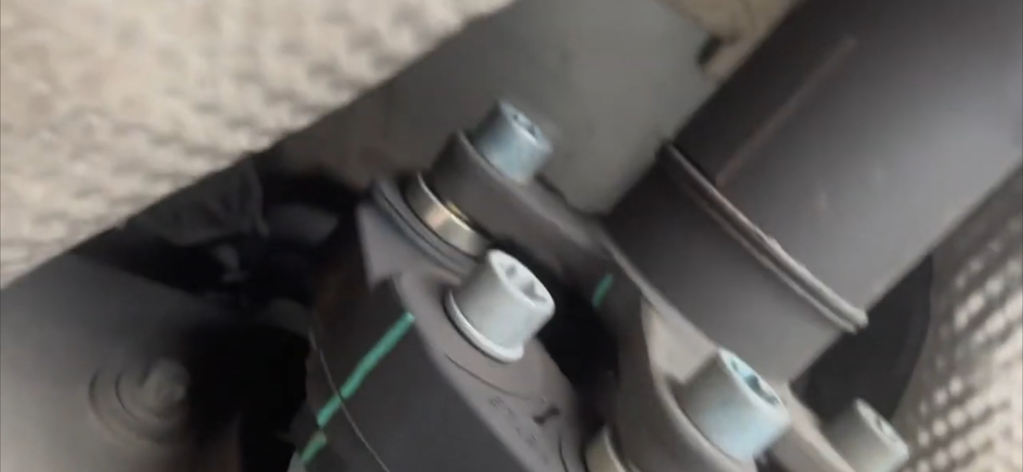

Better picture …

Anyone perhaps found a part number for these spacers / washers - I cannot find any reference to them at all.

Thanks - the carrier shims I have - the part I am looking for is the silver Button like spacer that goes between the prop and the flex disc - in pics below

No answer from the youtube video creator? Those shims on the flex disc isnt in EPC but WIS mentions something like it I think.
