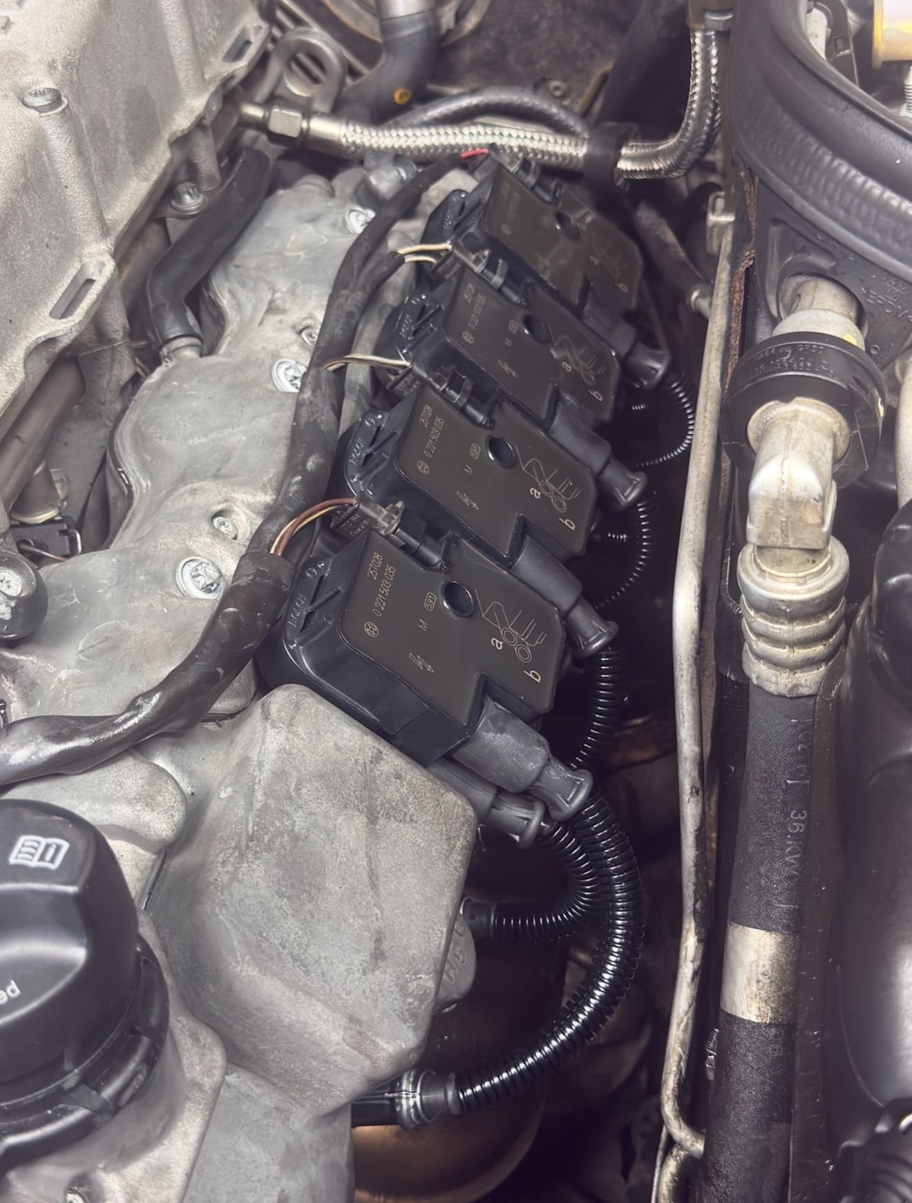

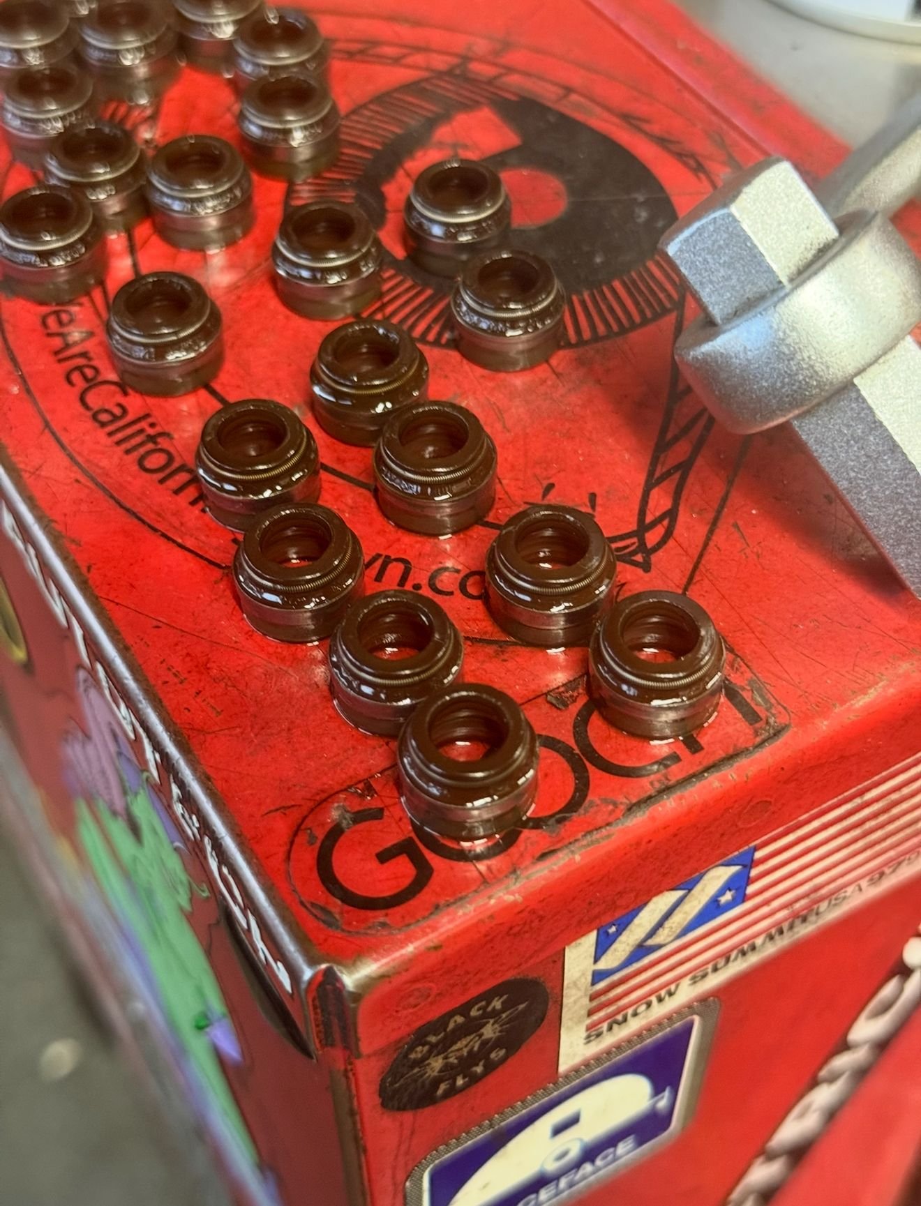

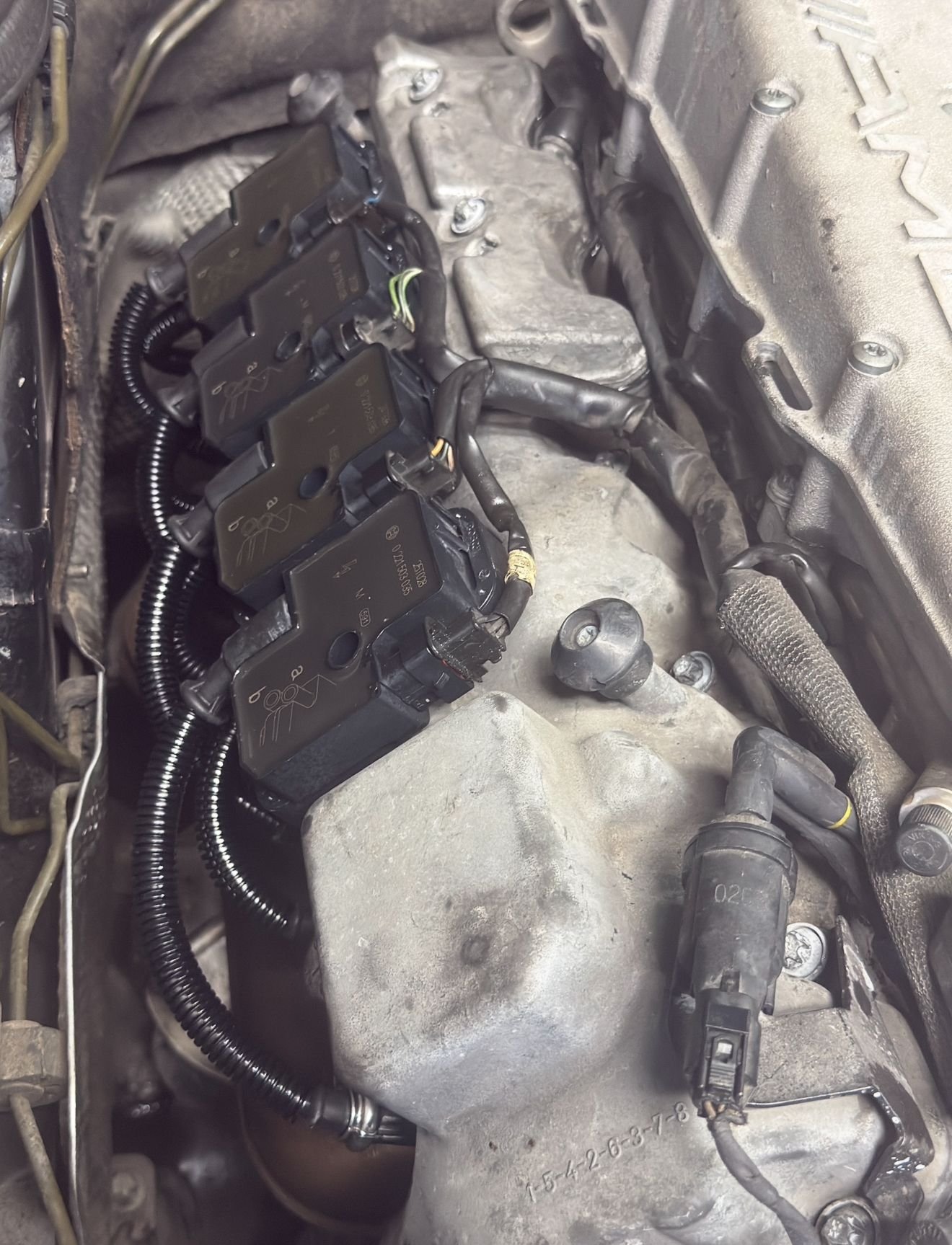

Valve stem seals were rock hard, swapped them out along with new spark plugs, wires and coil packs. No more smoke from the exhaust
only thing I still notice is the SLIGHT shaking in the motor when idling.
Not sure if that’s from a bad mount or something else. I have no clue

You sure all the plugs where gapped correctly? One not closed up from dropping it ? Have seen that before.

Yeah I checked them all before I put them in and made sure they were to spec. There was ONE that needs a little tap to be at the right gap. I'm thinking its my motor mounts causing the slight wobble/vibration at idle
