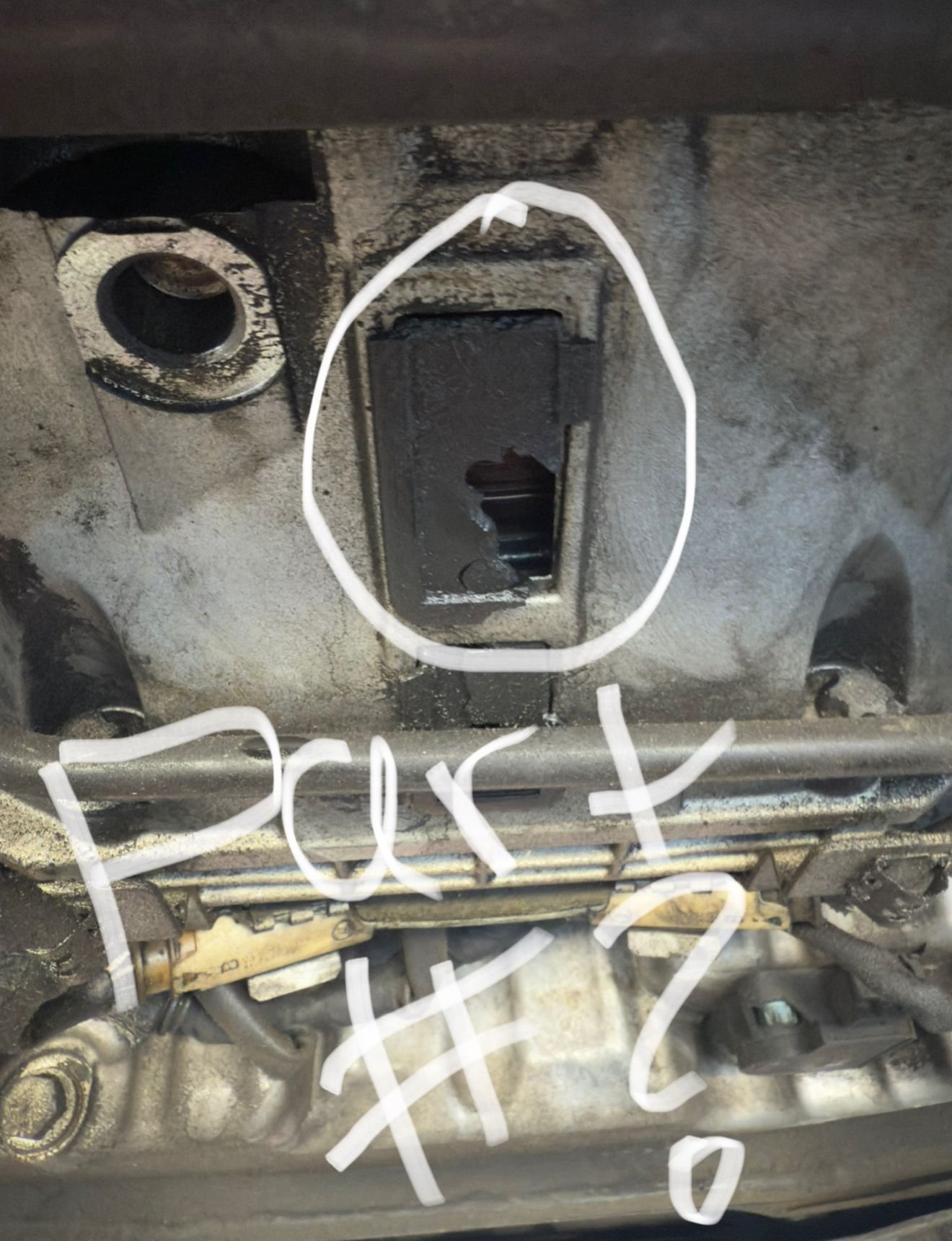

Anyone know the part number for this?

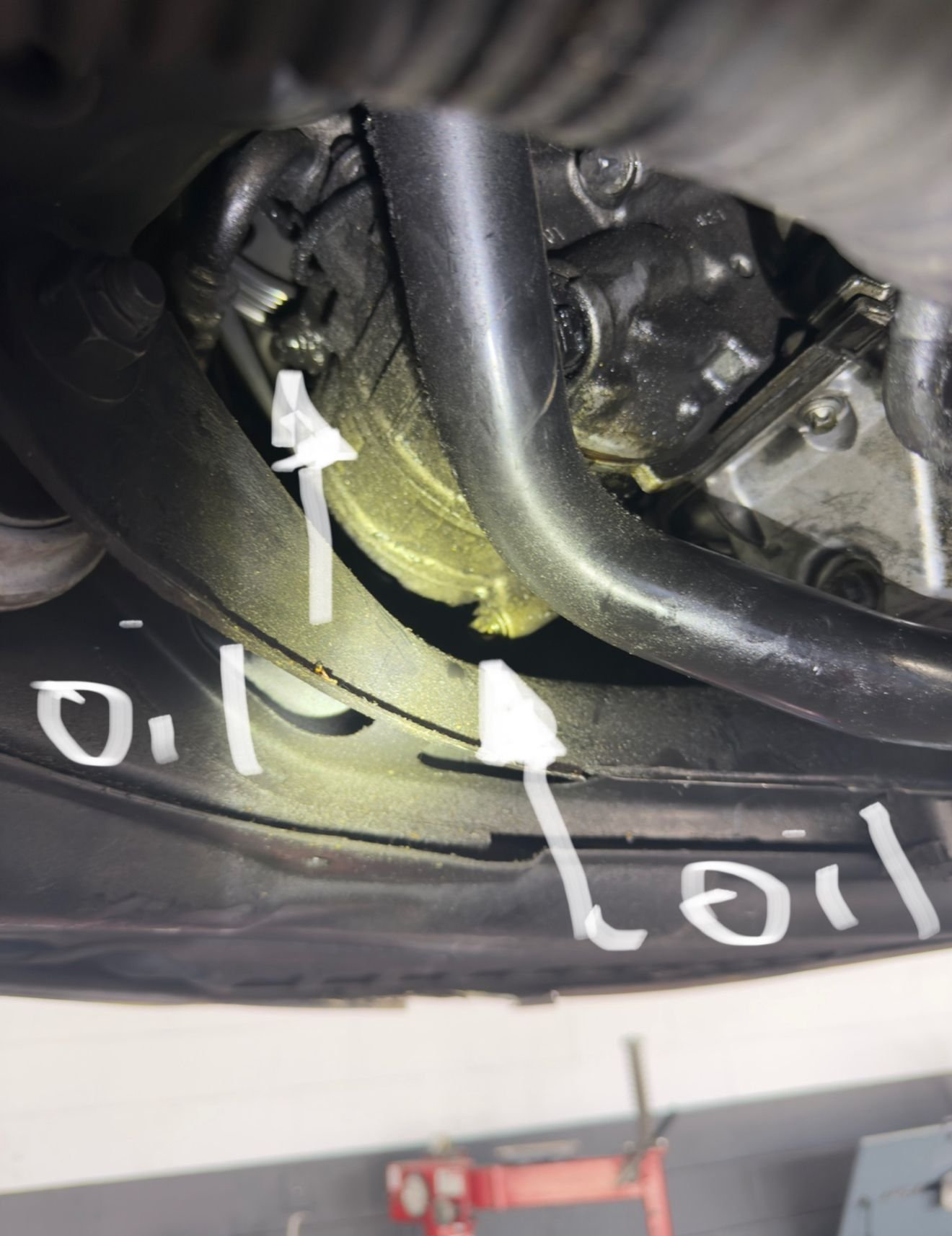

Some areas where the oil can be found.

The oil cooler is on top. It's what the oil filter gets installed into. It's at the very top and leaks oil all over the front of the motor, down directly onto the AC compressor as in your picture.

the oil pressure test port is right below the oil cooler, it fails all the time too, and leaks a ton of oil down the front of the motor above the AC compressor, belt tensioner, down onto the crank pulley
