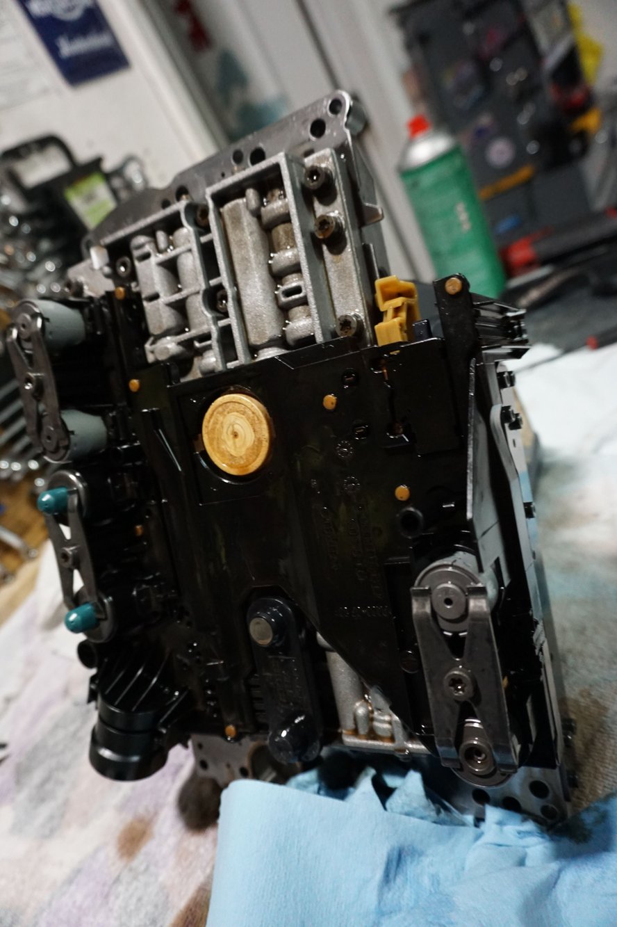

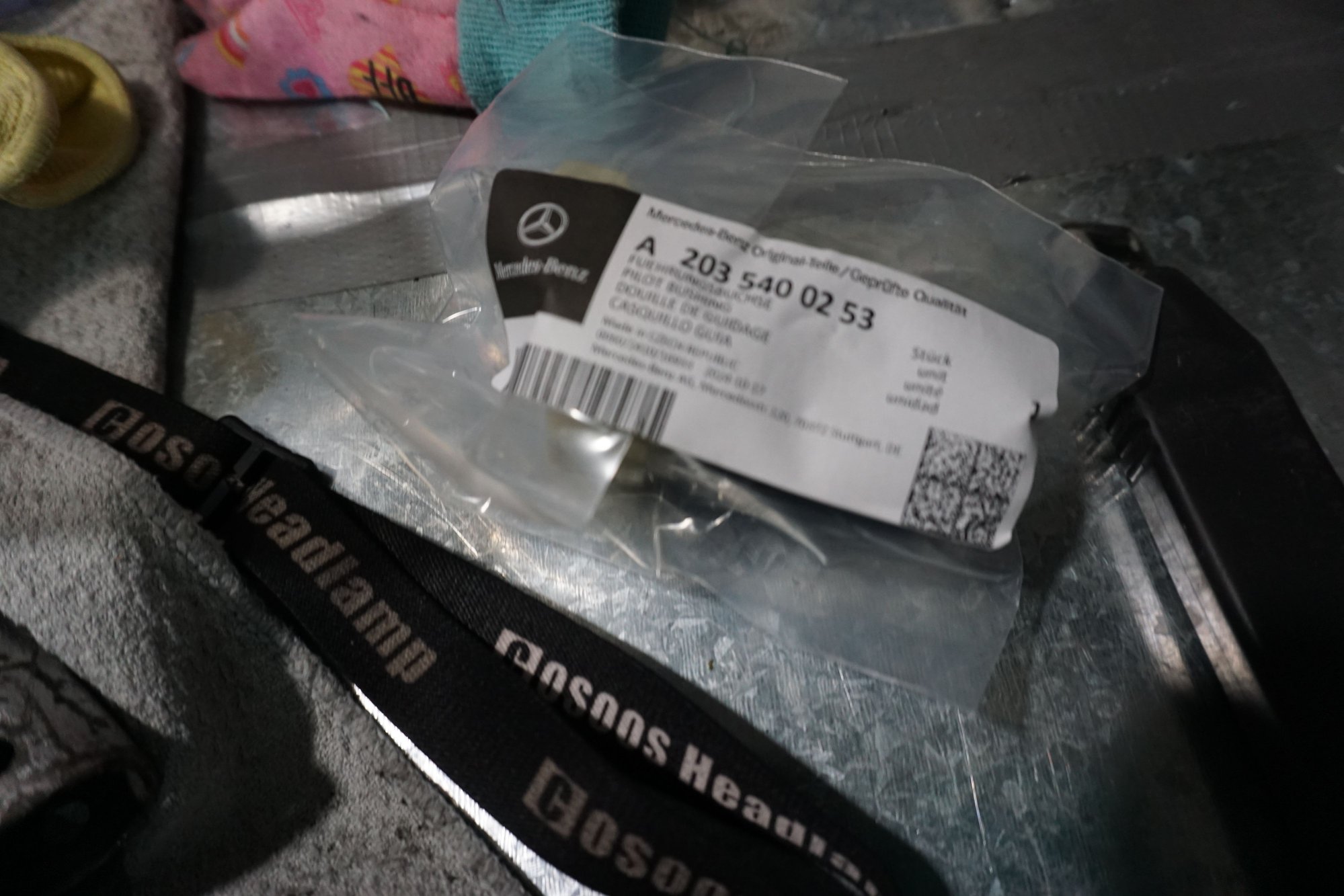

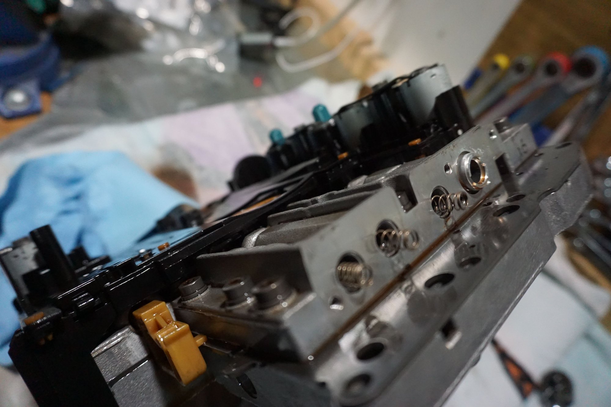

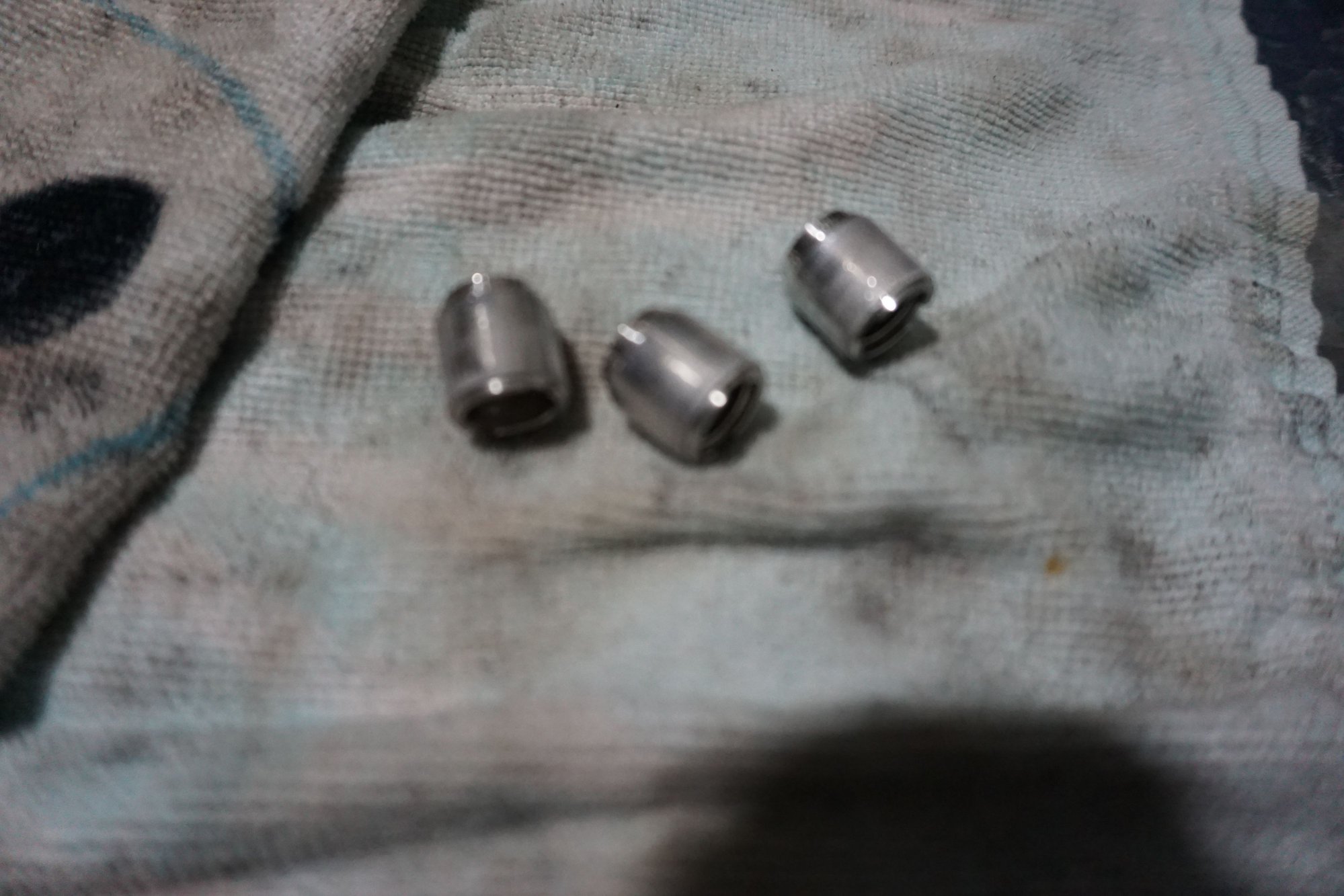

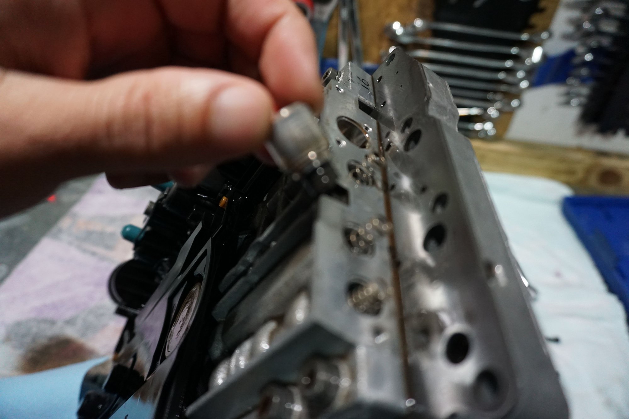

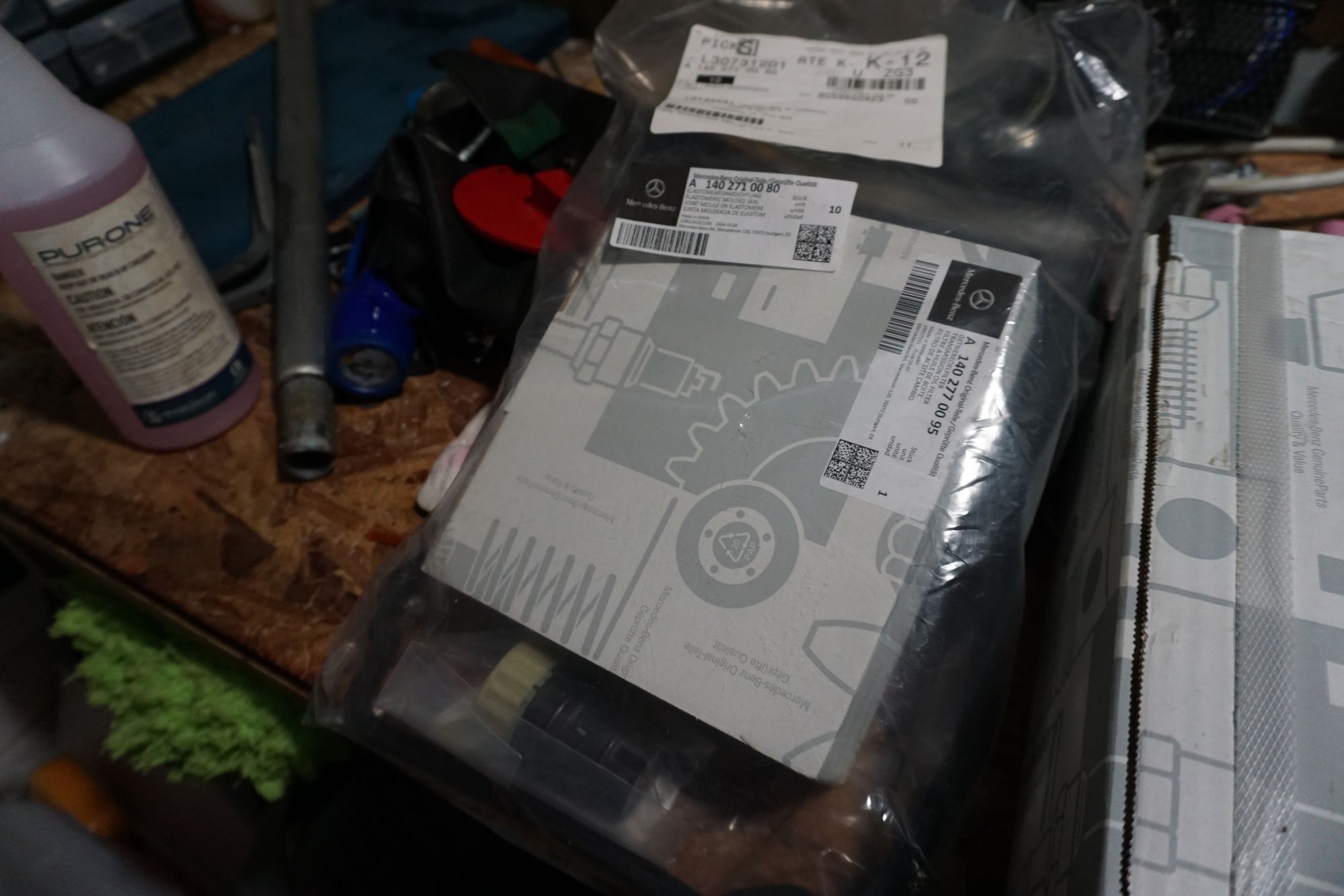

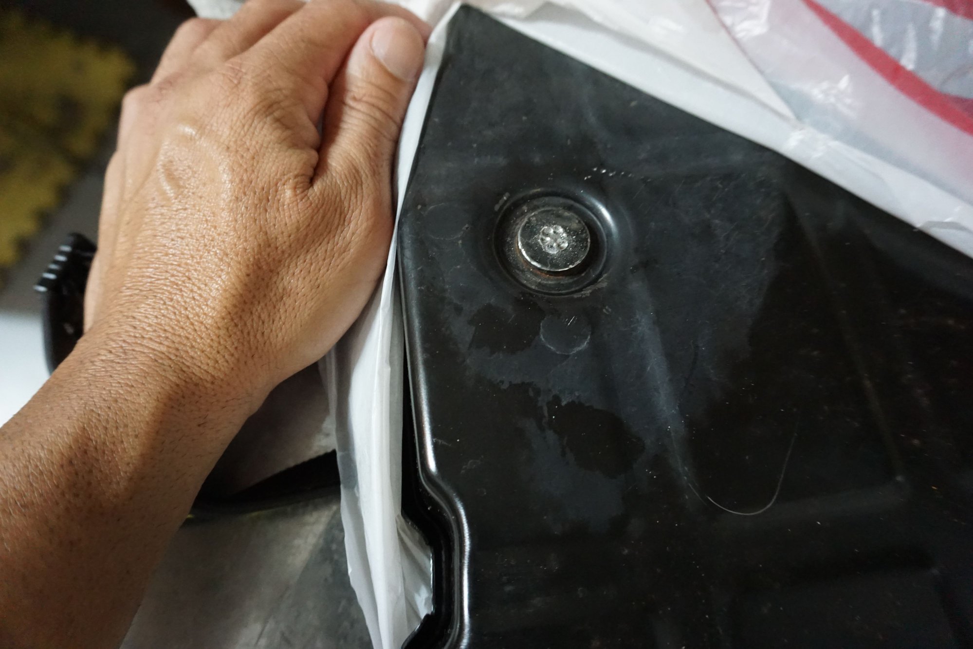

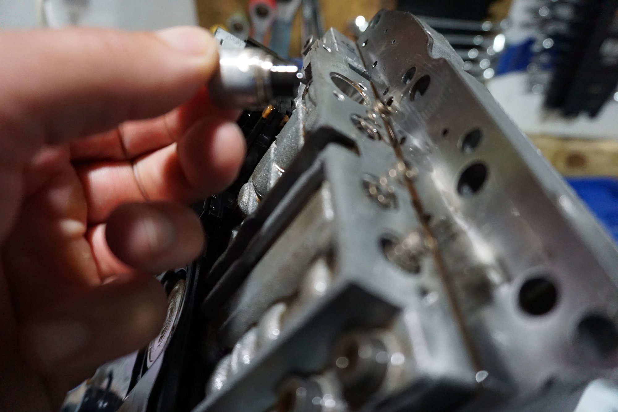

Jul 22, 2025 | 08:57 PM
here some pictures of my overlap sleeves they are scorned badly,
One bit of advice when installing new overlap sleeves make sure to soak them in trans fluid or they will be hard to insert them back in and one of the sleeves is smaller I.D
plus my 06 already has blue tops, I want to check part number to see if the one I purchased are updated version.
