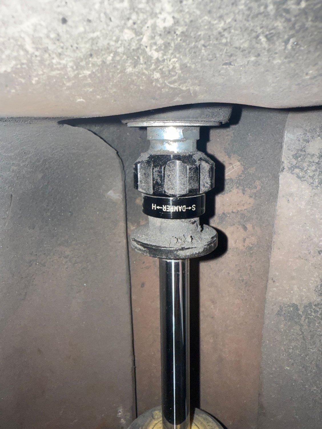

Rear shocks are at max hardness unless they have this adjuster backwards and it’s on max soft, I have no idea but going to try the other way adjustment and see if that’s possible. The front is perfect no issues there

It's upside down ! Turn to full soft and report.
Old Sep 29, 2025 | 03:43 PM
al00sh's Avatar
Joined: Apr 2014
Posts: 250
Likes: 19
From: Orange County
2004 W211 E55 AMG
So at full soft, if I push down on the trunk it is almost effortless

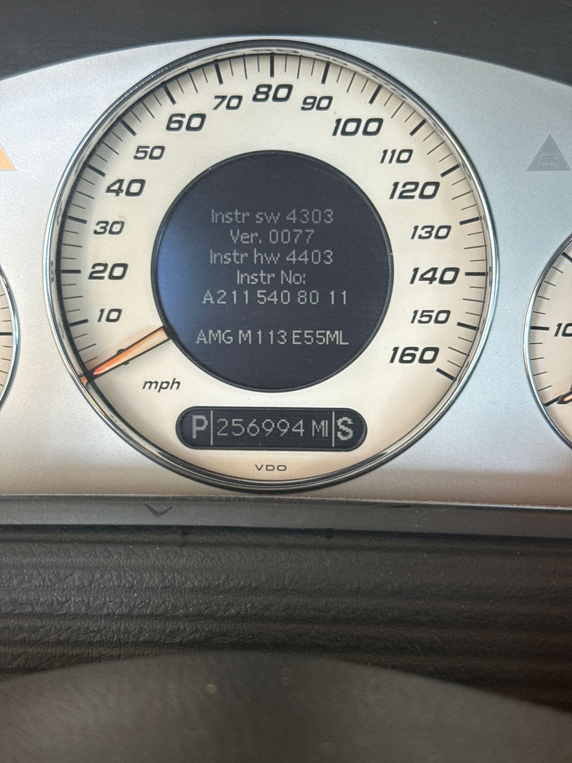

OIL LEVEL NOT SHOWING
Just did an oil change (AGAIN) bcuz my drain plug was leaking and also replaced oil level sensor just for the hell of it. It’s been sitting blank like this for about 15 minutes
anyone have any ideas?
