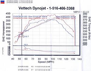

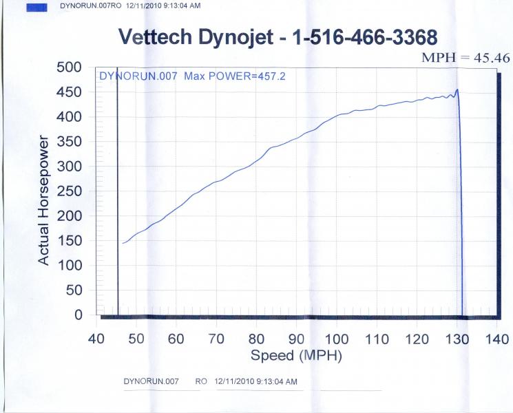

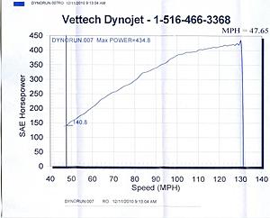

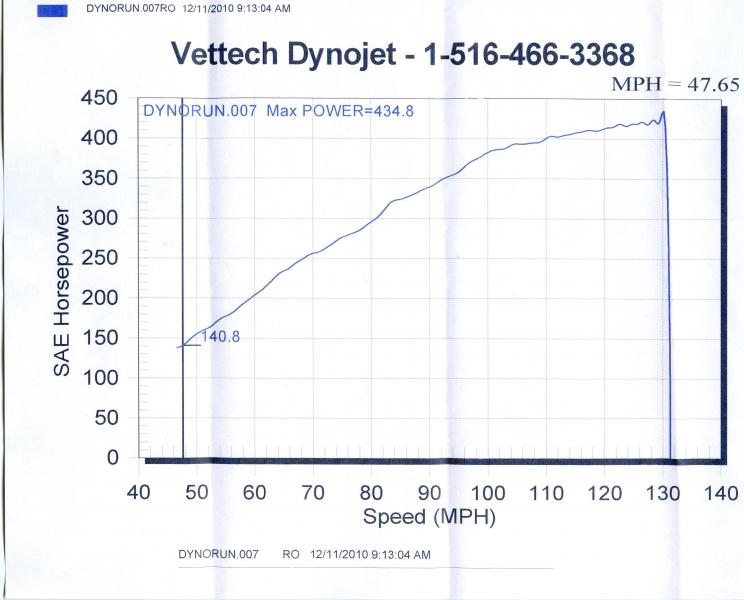

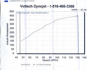

I removed Kleeman headers and cats and put back stock manifolds + primary cat delete, did the dyno this morning:
435 rwhp SAE, (457 uncorrected), mods: Kleeman ECU, K&N, charcoal delete, ROW airboxes, primary cat delete
409 rwhp SAE, mods: Kleeman headers+hfcats, OEtune, K&N, charcoal delete, TTM airboxes
395 rwhp SAE, modes: Kleeman headers+hfcats, Kleeman ECU, K&N, charcoal delete, stock airboxes
It is over 26hp difference. So after removing Kleemann headers+cats and putting back stock manifolds (with primary cat delete) yielded a gain of ~ 26hp comparing to 409, and ~40hp over 395 run.
It is about ~10hp gain from my baseline (@424 SAE) without Kleemann headers:
OEtune, K&N, charcoal delete, TTM airbox mod: @424 RWHP.
So overall: Kleeman ECU/OEtune, K&N, charcoal delete, ROW airboxes, primary cat delete should yield anywhere from 25-40 rwhp

Updated: dyno sheets for the: K1, K&N, Charcoal delete, ROW airboxes, primary cat delete.
The first one compares the current mods (RED) to the setup with the Kleemann headers+cats (BLUE).
The second one is the best run uncorrected, and the last is the same run corrected.
Attached Thumbnails Kleeman headers on W212 E63-dyno-catdelete.jpg   Kleeman headers on W212 E63-dyno-catdelete-raw.jpg   Kleeman headers on W212 E63-dyno-catdelete-sae.jpg

I know it's a hard lesson learned but next time I'm sure you'll do it right: headers made for your specific model AND a tune to get the most out of the headers.
I hope to see a thread from you in the coming months showing pretty good gains
