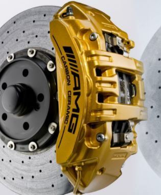

Ok so I am going to ask a really dumb question but figured someone else might be thinking the same thing. I love GiroDiscs. VERY quality product. I have their rotors on my STi.
According to the above:
Originally Posted by MerchantM5arine View Post
irodisc replacement front rotors are A1-207 part number and rears are A2-240....
That is what we need. However do we still use the same calipers?! IE: The gold/copper "AMG carbon ceramic" branded ones below? OR, do we have to switch the calipers to the red/non painted AMG calipers that would come with steel rotors? I also see on Girodiscs site they recommend a different pad due to the size of the rotor, the pad has to be smaller. Has anyone done this yet? Seems like a very viable option to not have to spend $10-13k for rotors...

Nigel,
As per my conversation with Mike over at GiroDisc, we can most definitely re-use our gold colored calipers. He phrased the kit as a "drop in replacement". The retrofit discs are the same 402mm size. As for the pads, they have to be changed out to accommodate a different friction material. I was unaware of the pads being a different size though. Girodisc informed me there were 2 types of pads available for the retrofit rotors. I can't find my email stating both kinds, but I remember the ones I was going to purchase were labeled as Girodisc "Magic Pads" To me they sounded like the all season tire of pads (i.e. low dust, high initial bite decent temp range) I recall they were an every day/fast street pad, not supposed to be used for track use. I seem to recall pads being about $250 per axle.
