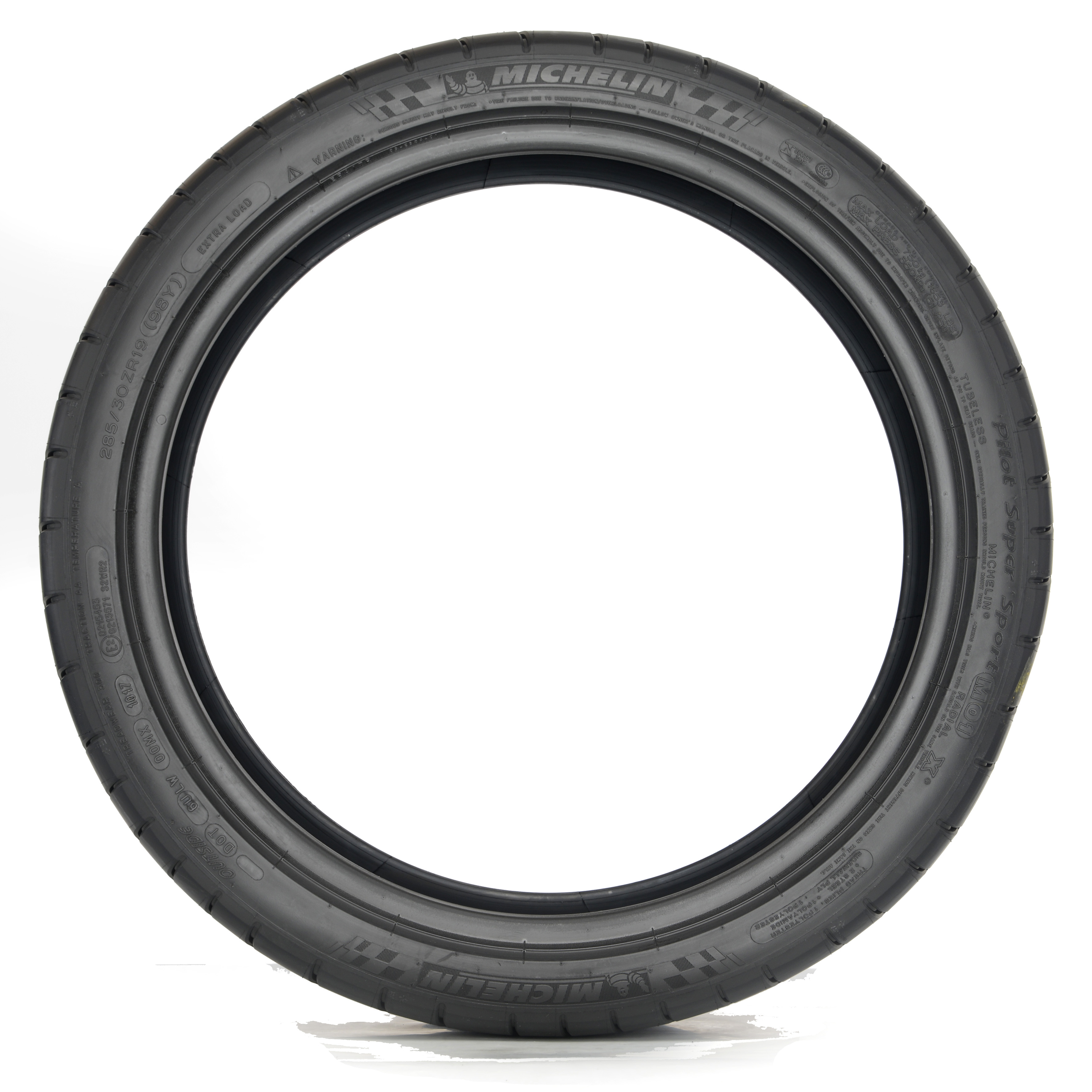

had long discussion with one of the USA heads of mich tire development, yes ps4s is replacing all the pss size
but for OE developement, in october u can buy 285 30 19 as a c63 OE replacement. called the PSS m--01
u can close this thread now...thank you

Just wanted to give you an update. These tires are indeed available. I just had them mounted on the rear of my C63 Black Series today.
Michelin Pilot Super Sport 285/30/19 (98Y) MO1.
Michelin part # is MSPN 07078
My Discount Tire rep said it was a hassle to try and order these tires. He said their normal channels at Michelin didn't want to sell the tires to them. Most likely because of the limited supply on hand and wanted to save them for dealers? Who knows. Anyways he said they went all the way to the top and spoke with the Michelin rep that is in charge for Discount Tire Corporate.
