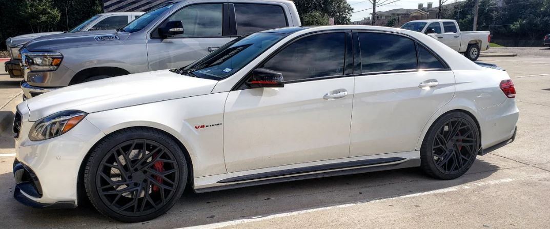

any help, ideas, opinions appreciated! pic of my baby

I love the front lip side skirts and rear bumper extensions, my car is in the shop currently getting this done, cannot wait to see how it looks.
