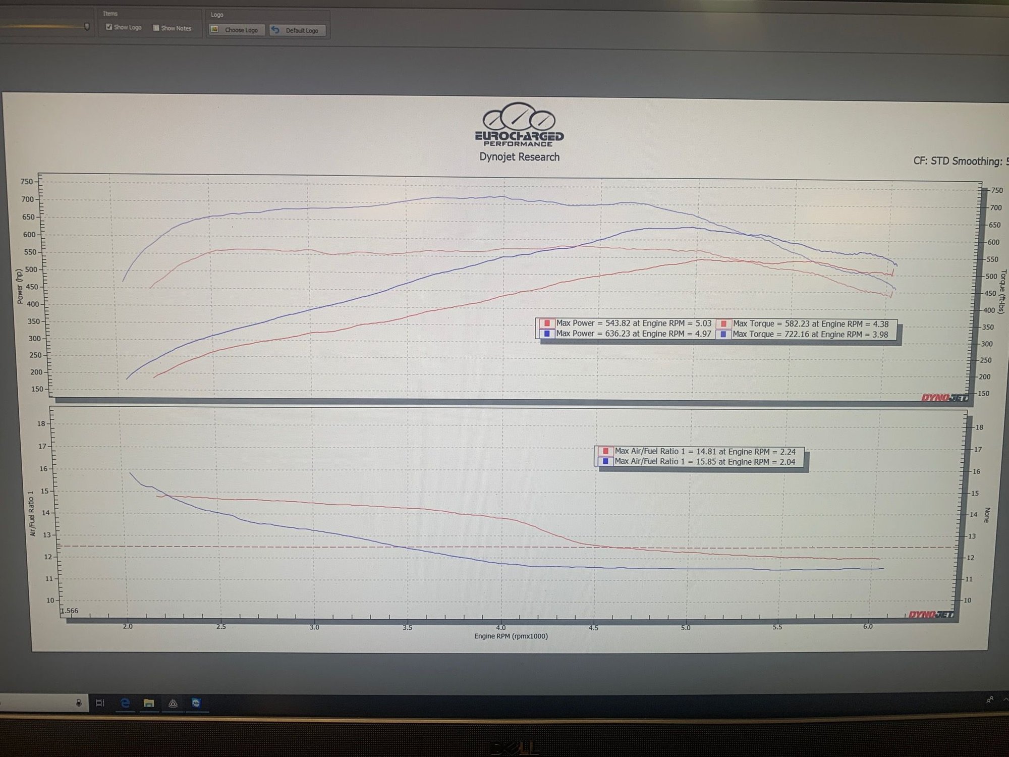

I just got a tune from them, and here is the dyno. Honestly, very hard to believe. Does this seem real? It definitely pulls harder though.

Was this on 93 octane, some variation of E85 or race gas?
If this is 93 octane and you have the "E50" tune then you have what I'm running, with very similar numbers.
Add 9 gallons of E85 to 8 gallons of 93 and take her out for a rip. Do a roll on in 3rd gear and just feel the car pull and pull and pull... TC in sport and transmission in Sport+.
This looks like the newest version of the EC tune with a much flatter torque curve. If so, and you have a E63S, then you have a solid 11.0 at 129 mph car on your hands.

is that their stage 1 or stage 2 tune? is that 638 wheel HP? pretty strong!

Yeah it's wheel. Stage 1 supposedly. 720 tq though? That seems excessive.

Brutus - does the E50 tune produce the 630+WHP with only 93 octane? or would you need the E85 mix to get to that level WHP? amazing work EC has done to finally get a tune only 63 running 11 flat.

The E50 tune produces this wheel horsepower on 93, and 680 when running a E50 blend.

It was just 93. So conflicting info I get about adding E to these cars, it is safe to? I've never really dealt with this before.

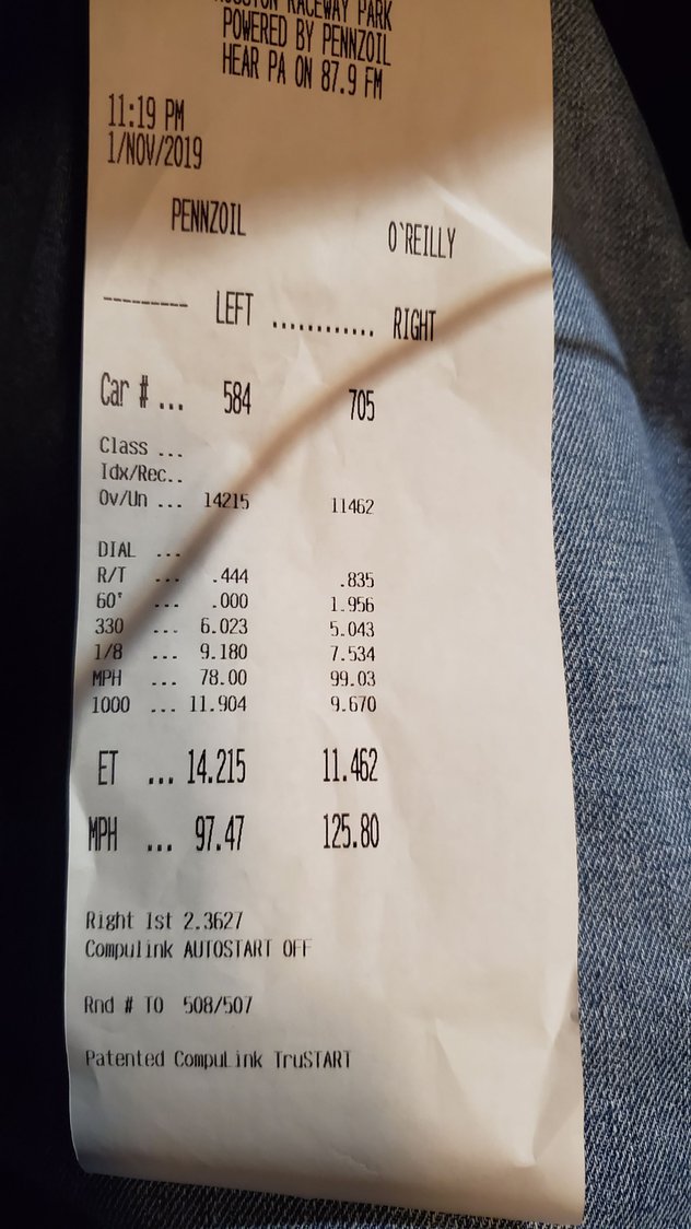

Right
First run.

Was this Houston last night?
If you are running 93 octane then you are bang on the numbers based on your trap speed.
If race gas then you are a little low.
I assume you used RS based on your 60ft??
Use brake boost with TC off the next time and you will gain a tenth or two on your time.
Try some race gas or ethanol blend next time and your trap speed will improve as well.
I went out last night and did a quick run on a deserted part of road and ran an 11.1 at 129.7 and a 7.6 60-130 running E50.
You must be happy with your numbers.

Yeah that was last night at Baytown. Are you in Houston? It was not quite E50 blend. I'll try more e85 next time. And it was RS.
