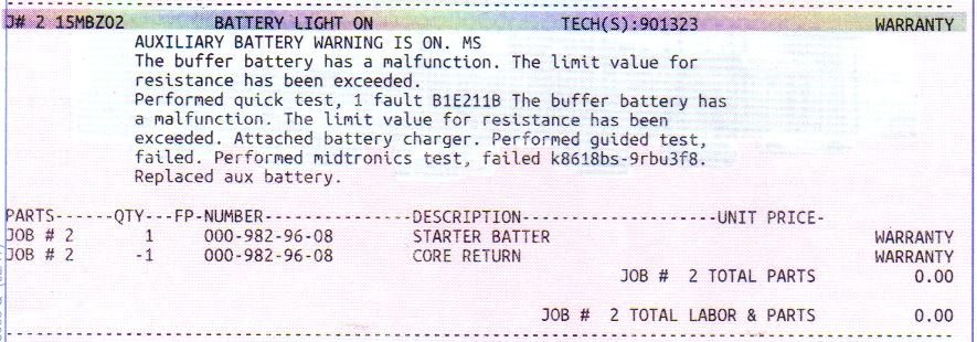

you can also tell the aux/trunk battery is low or dead when your car will not automatically turn off at a stop when in C / ECO mode..... i never use ECO but dealer said the battery was shot after 3 years on my 2015 and they replaced it under warranty a couple years ago.

My warning light started last week. Brake Hold feature will not work either. Dealer said cruise control also not work. My Aux Battery, part number 000-982-96-08, replaced 2 days ago and they call it "STARTER BATTERY":
