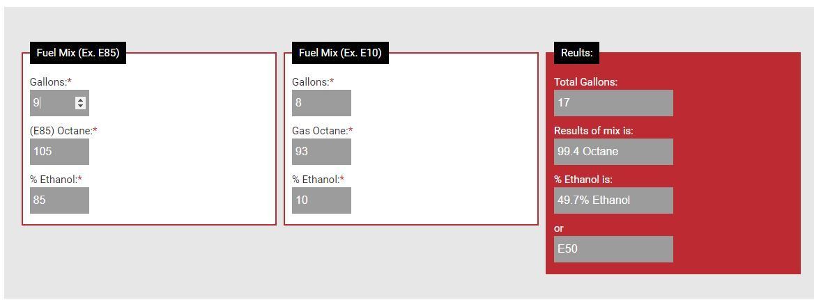

My E50 EC Tune has an equivalent octane rating of ~99 octane when you blend 9 gallons of E85 with 8 gallons of 93 octane..

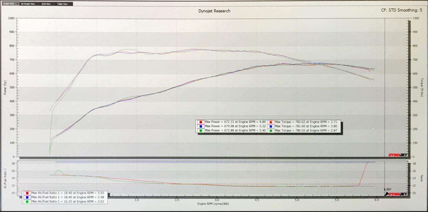

The car makes ~670 awhp at 18.5psi on this tune when running the blend.

Brutus - hey how are ya? Thanks for sharing that - i thought E50 was more like ms109 octane level but not so, its like 99/100 per your calculator. the E50 at 99/100 octane still produces much more power than straight 100 octane fuel which is amazing
