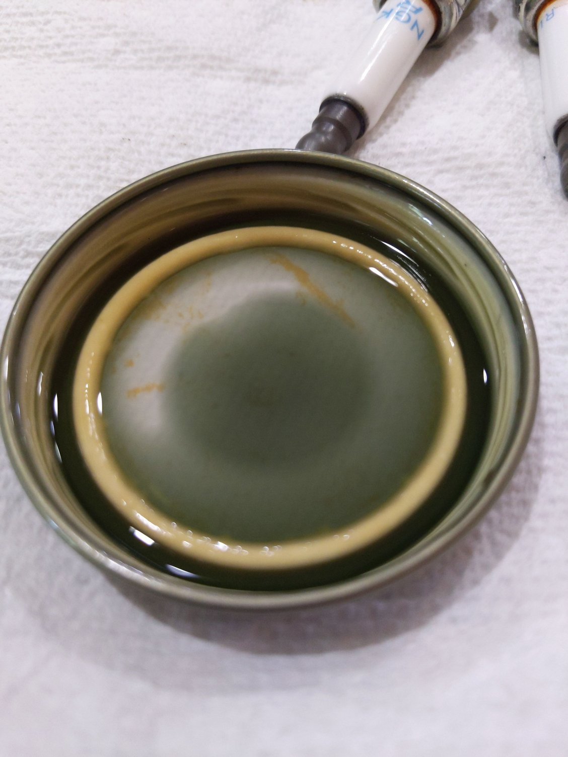

So I posted in an earlier thread that I'm new to Mercedes but I purchased a 2011 58K mile E63 a few weeks ago. I reported here there was hesitation when starting from a start and a hard down shift when coming to a quick stop. This seems to have improved after changing the oil and plugs but there's definitely a shifting issue. I can get past the majority of the harshness when I M mode. Today I decided to perform a flush and upon removing the drain plug a little over two quarts drained out. I was under the impression a quart would drain before popping the overfill cherry, another quart after. The fluid looked clean and blue and didn't have a destinct smell to it. I'm wondering if it was probably overfilled and that caused the stuttering. I took a picture of the fluid attached.

I am not so sure what you are asking. Is it possible the transmission was over/under-filled? Possible. How would you know? Drain all fluid (including the cooler) and measure. Do not forget that the procedure to refill needs appropriate temperature and vehicle leveling. Once you eliminate the ATF suspect, test operation and move on to the next likely candidate to troubleshoot. You shall start from OBD II diag for errors, resets, and/or adaptations. The color of the fluid tells nothing much, sorry. There are several brands on Approved List 236.15, all having their 'shades' of blue that change over time/mileage. Color is a distraction. Hope this helps.
