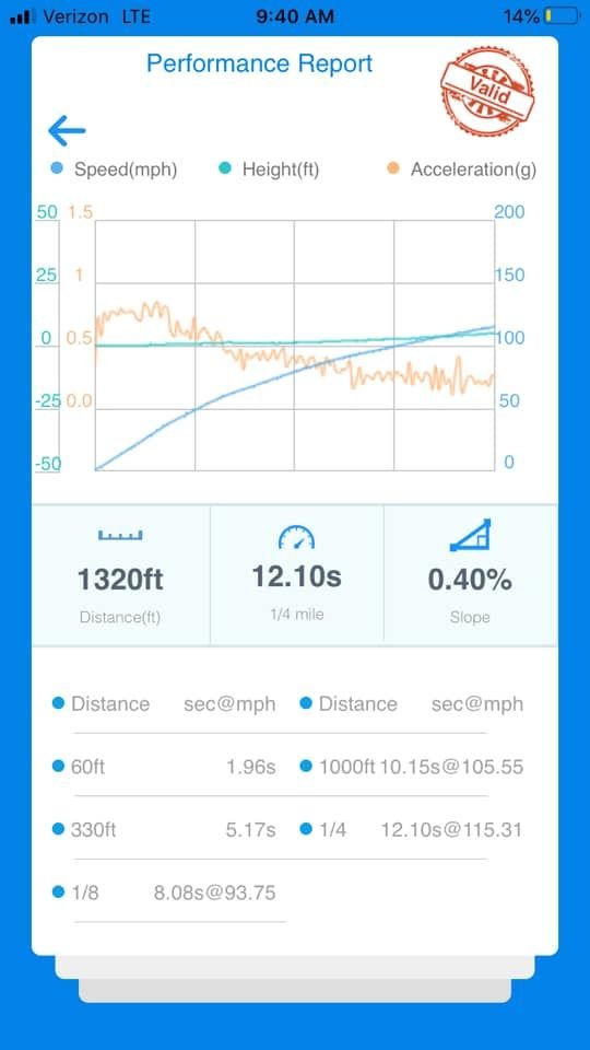

So I bought a awd 16 e63 wagon two weeks ago. Has some yokohama tires on it and 40000 miles on the car.

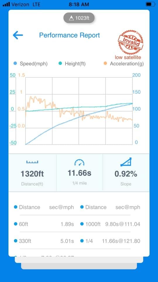

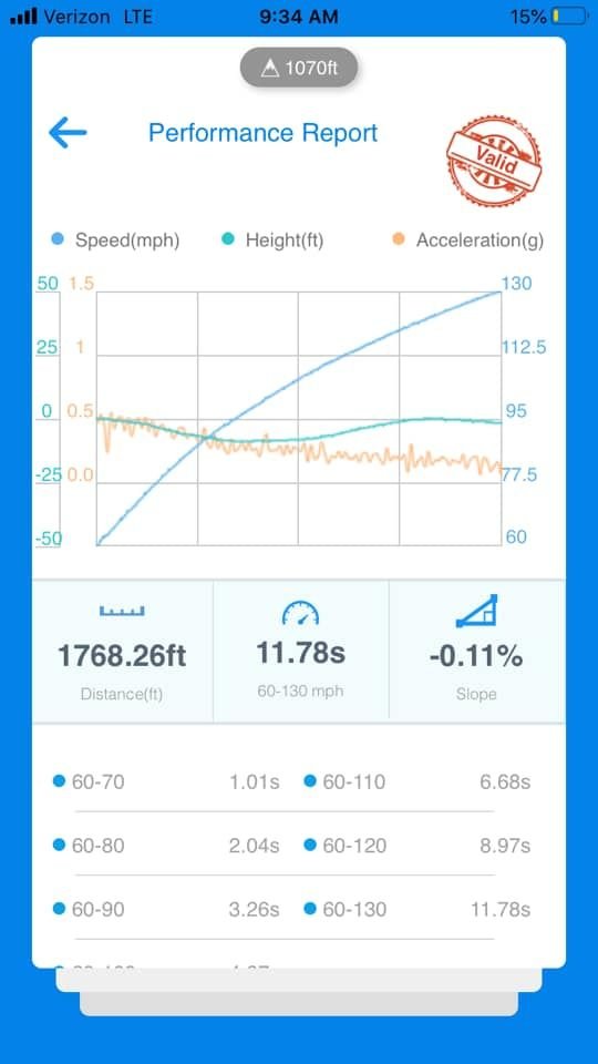

So I put my dragy on it stock with 91 octane.. 12.10 @ 115mph.. 60-130 was 11.78.. So being what I know about oem cars and ethanol i decided to mix me up a batch of e30 for it. 4 gallons of e85 and 11 gallons of 88octane.. Hit the road with the dragy and full tank of gas and boom......

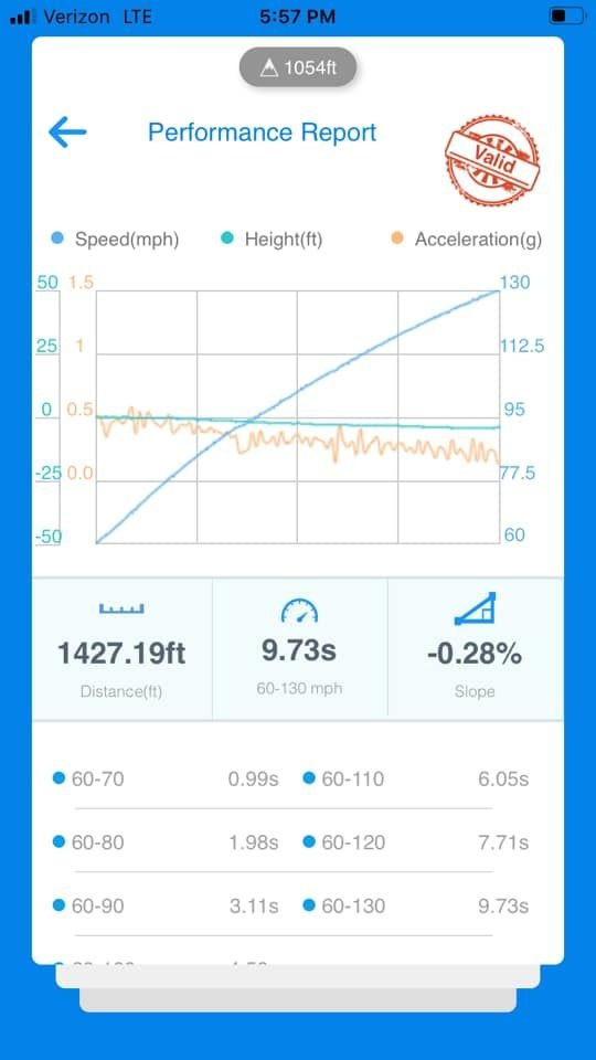

11.66 @ 121mph and best 60-130 so far is 9.66..
I then did a 3'' cat delete back pipes on it and it did not pick up anything BUT it sounds *****en now.
Using a Hp calculator it picked up close to 100hp by making it e30 with stock tune and being the car has wide band o2 sensors they are capable of adapting to the e30 fuel with the stock tune and it has ZERO effect on the drive ability of the car! This is the best free 100hp you can pick up on a oem boosted car...

dans776....so you're saying you're on stock tune and just added 4 gallons of E85 and bam....dropped 0.44 sec?

That is correct... 100% that is all I did... Switched fuel.. Any oem vehicle can run up to e30 fuel with out a tune change. It's 94 octane. Boosted cars or oe's with high compression will love it as i proved..

Thats a great performance boost and you were running up hill 0.92!
