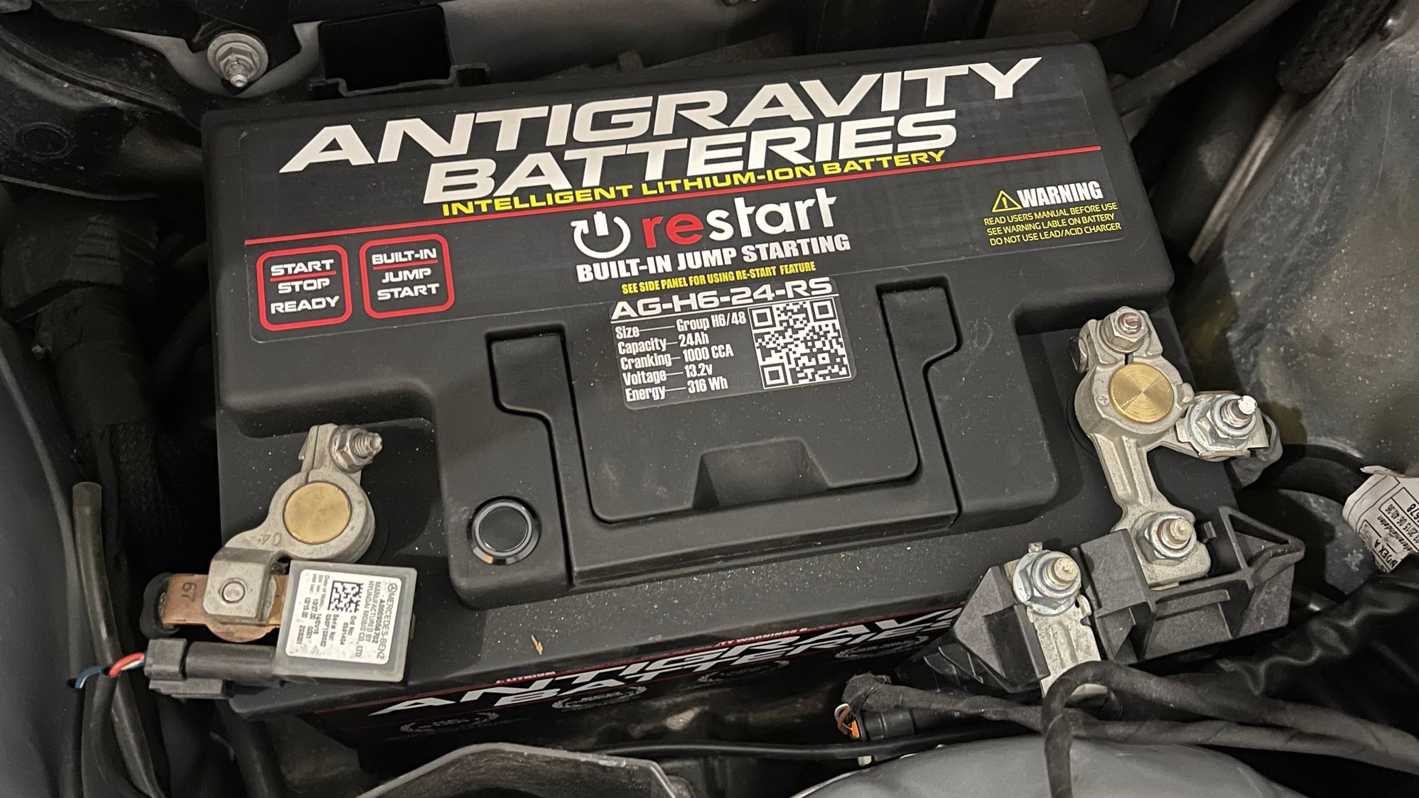

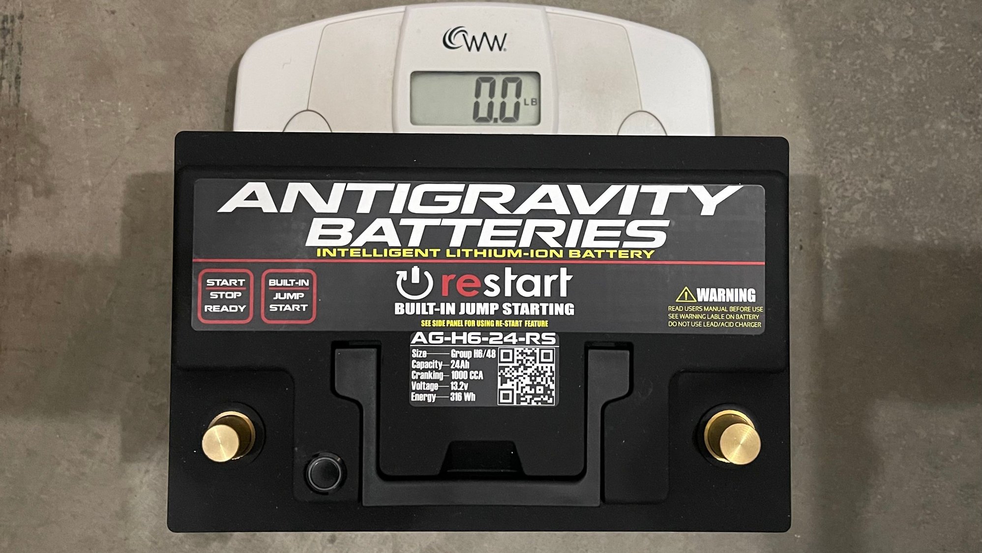

Finally charged and installed.
So light the scale wouldn’t work. I had to hold it and weigh myself with and without the battery. It weighs 8 lbs!
8.4 lbs vs 50.8
I had to weigh it with me and subtract it.
Vroom Vroom

2023 E63S Wagon
Originally Posted by sickSVT
I run the Antigravity H6, a solid 45lbs weight reduction from the factory battery.
You'll have to disconnect the IBS sensor located in the negative battery terminal so the alternator charges it properly.
So just unplug the sensor clip from the negative terminal?
Yup, unplug the IBS connector from the negative battery terminal. I had to learn that the hard way when I tried driving the car for 2 hours and almost ran out of juice until I got home and unplugged it. No issues ever since then.
Perfect. Done!
First drive today.
I threw the stock battery and a 10mm in the back just in case for this week
