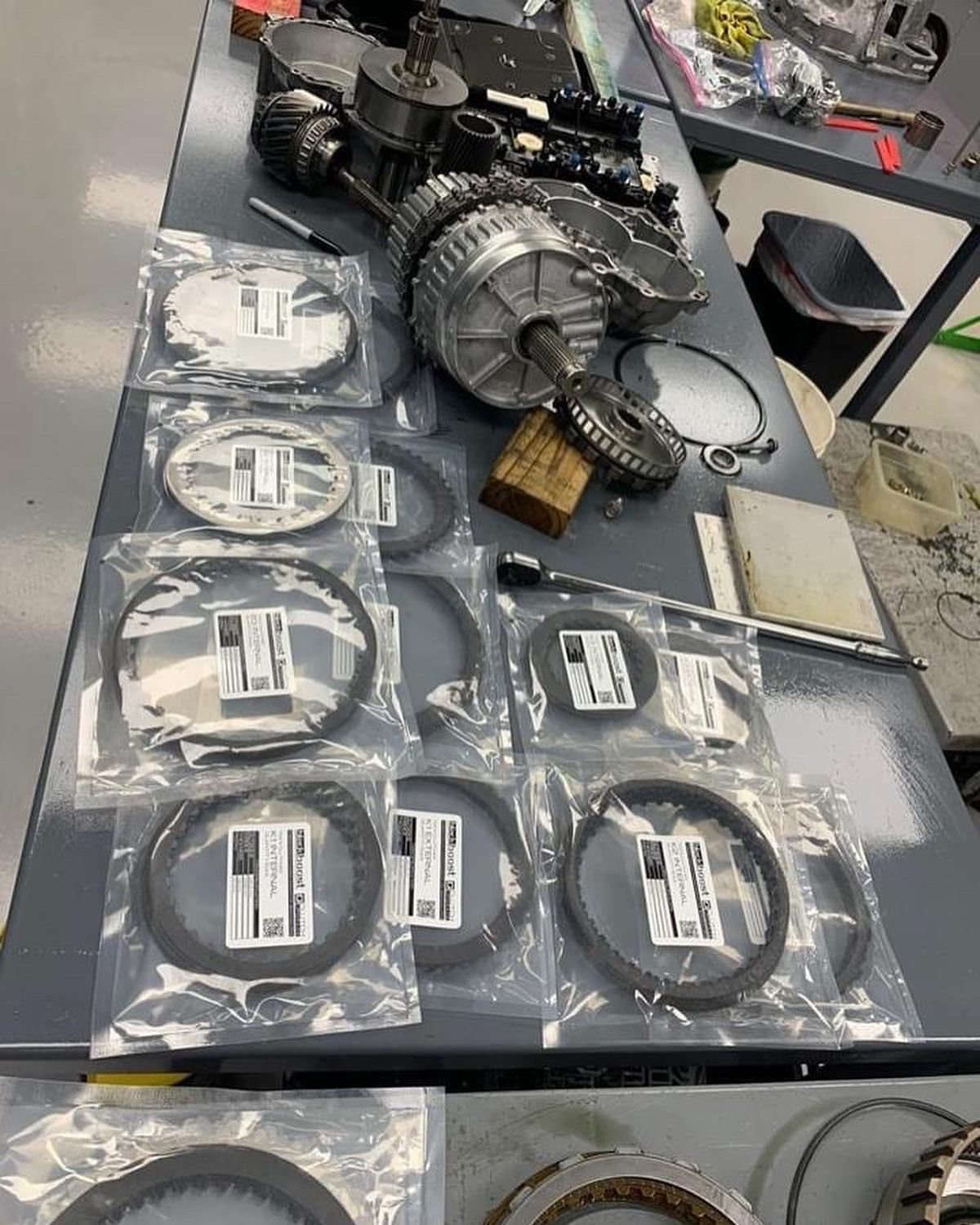

I wanted to carve out a separate thread to highlight a critical component of the build - the clutches.
When we started down this car's build path, we knew we didn't stand a snowballs chance in hell of the stock clutches surviving the amount of torque we were going to subject the transmission to.
We opted for the BlackBoost clutches because, well, its a Boostedbenz build that utilizes all the various hardware BlackBoost had to offer. We wanted to subject the clutches to real world stresses in an environment most cars don't operate in for extended periods.
Because we were going to be running at the Mile at elevated speeds, we would be subjecting not only the first four gears to sustained loads, but also the 5th and 6th gears as well. Given the mechanics of the gear ratios... if we were going to see slippage it would be in the higher gears.
When we started the tear down and build we had over a month of schedule to get ready for the mile.
Easy peasey lemon squeezie.... NOT!
When we commenced tear down it was noted that the output shaft on Jessies build had slight deformation and twist in the splines of the shaft. Because of this we couldn't remove the basket, meaning we couldn't replace all clutches.
No problem, we'll just order a new output shaft and go from there.
Well three weeks later Mercedes decided we'd waited long enough and finally sent us a replacement output shaft.. It came in during the TX2K weekend and all shops were slammed.... damn.
We were 4 days away from buttoning up the car to head to the Mile when we were finally able to rebuild the trans...no pressure.
What follows is not the recommended break in process for a transmission rebuild.
The engine and trans were put back together and in the car on Tuesday. Slav gave me a base map to drive the car on Wednesday... I then proceeded to put 80 gentle miles on the car in stop and go traffic to try and get the new trans adapted.... we didn't have access to a Xentry system at the time, but the up shifts from 3rd onwards seemed fine. Downshifts into 2nd were a different story.... damn. We knew we had nowhere near the number of miles we wanted comfortably under our belt, but Jesse, bless his cotton socks, said "send It!"
