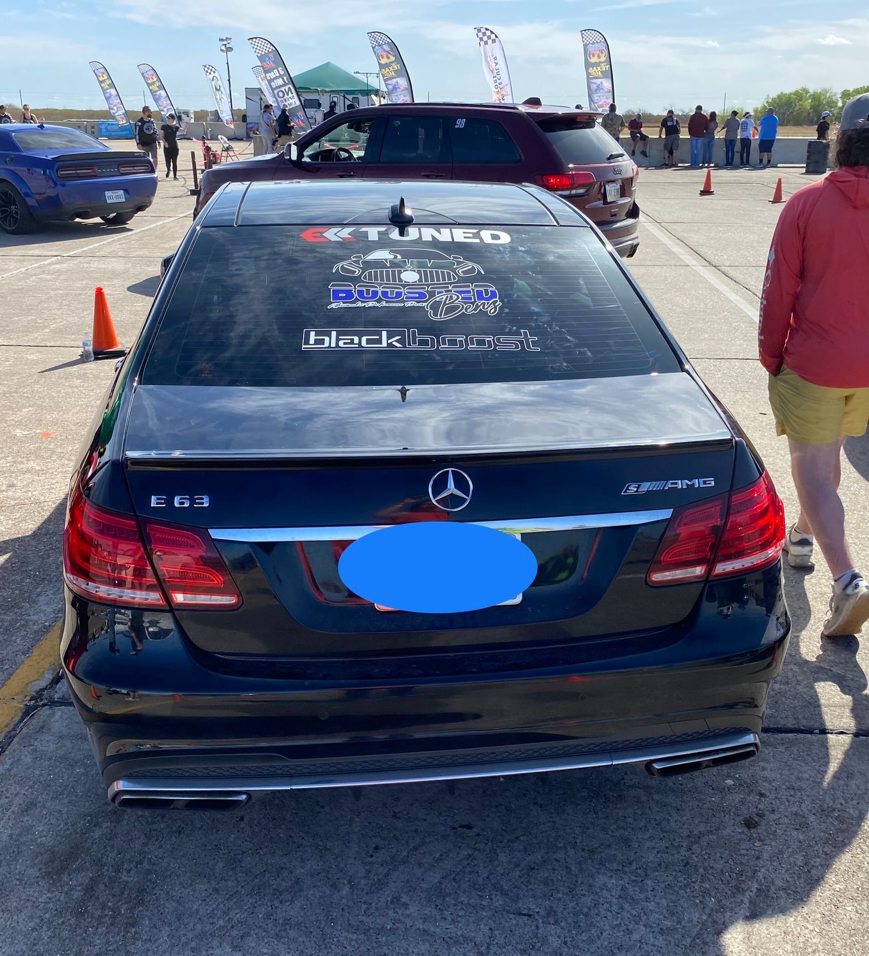

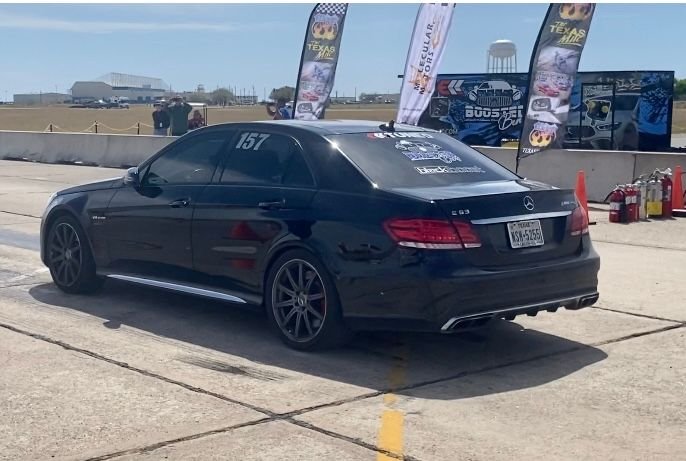

I wanted to thank the enthusiast for trusting us with his car and this build. As mentioned this is an M157 build running a Boosted Benz Bundle Stage 5. This build had a lot of experienced people on it and I could not have asked for a better team. The BlackBoost Hardware with the ECC Tuned ECC Slav formally Eurocharged Canada is a fantastic combination for this platform to maximize performance. Make sure to check out www.boostedbenz.com for one stop shopping and @boostedbenz_exclusive for future builds.
In the staging lane waiting to do the first pass
Lined up to race with the Boosted Benz trailer in the background
