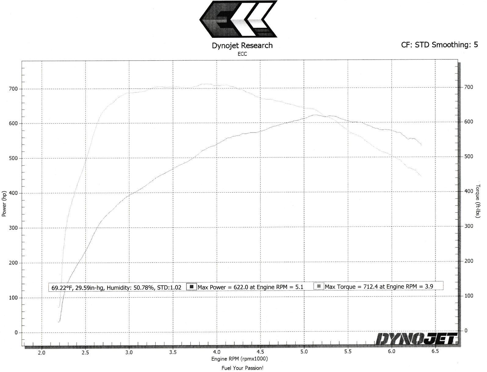

So, I had the car in to ECC Toronto (formerly known as eurocharged canada).
They were saying they didn't expect much. They seemed to think I was being paranoid and said that it was probably barely tuned. He said he expected 490 on the dyno.
They said it wasn't their tune, and it's running more boost than they would recommend. These numbers (and high boost) scare me about engine longevity so I have an appointment with the dealer to get flashed back to stock on Tuesday. I've been told not to beat on it until we dial back the boost.
Browsing some other threads the overall shape and numbers seem most similar to a Renntech R2 package, https://mbworld.org/forums/w212-amg/...t-install.html, but without the air intakes. Maybe that's what the prior tuner was trying to emulate. So god knows what they're doing here.
Fortunately it doesn't sound like any damage has been done at this point so if I return to stock I should be OK and not risking bent rods, etc.
Also, they confirmed that for the exhaust the secondary cats are deleted and resonators are deleted, and that the mufflers are renntech. Hence all the volume. They suggested re-adding resonators if I'm looking for a 20% reduction in volume.
I'm hoping tuning to stock doesn't mess with the sound of the car much. Crazy loud downshifts and cracks on upshifts (which I assume may be impacted by amount of boost) were part of why I bought the car.
