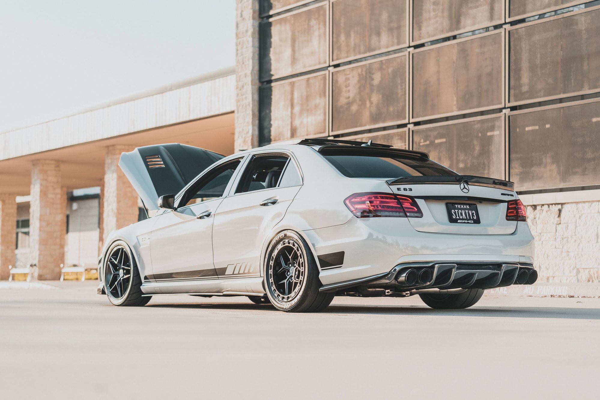

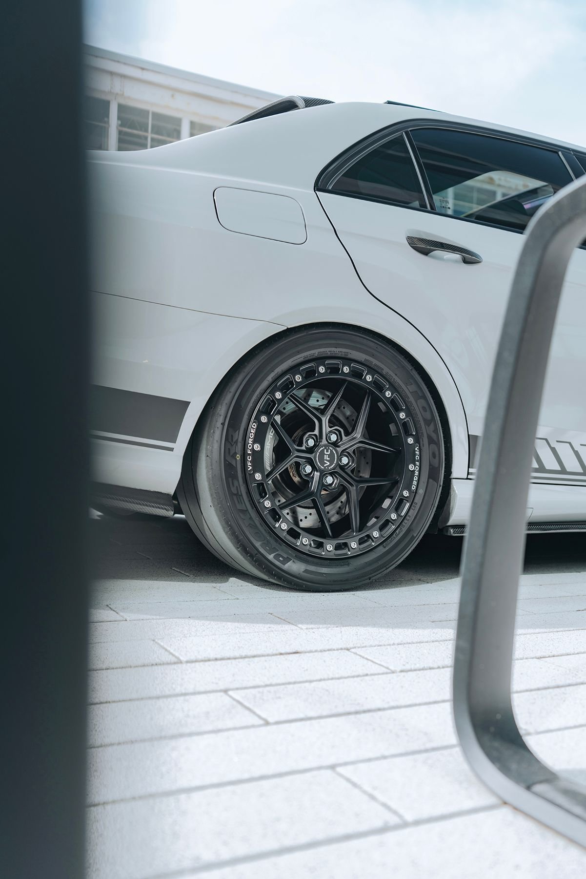

Got the new meats for the beadlocks.

Got my beadlocks installed, they got the specs dialed in perfectly!

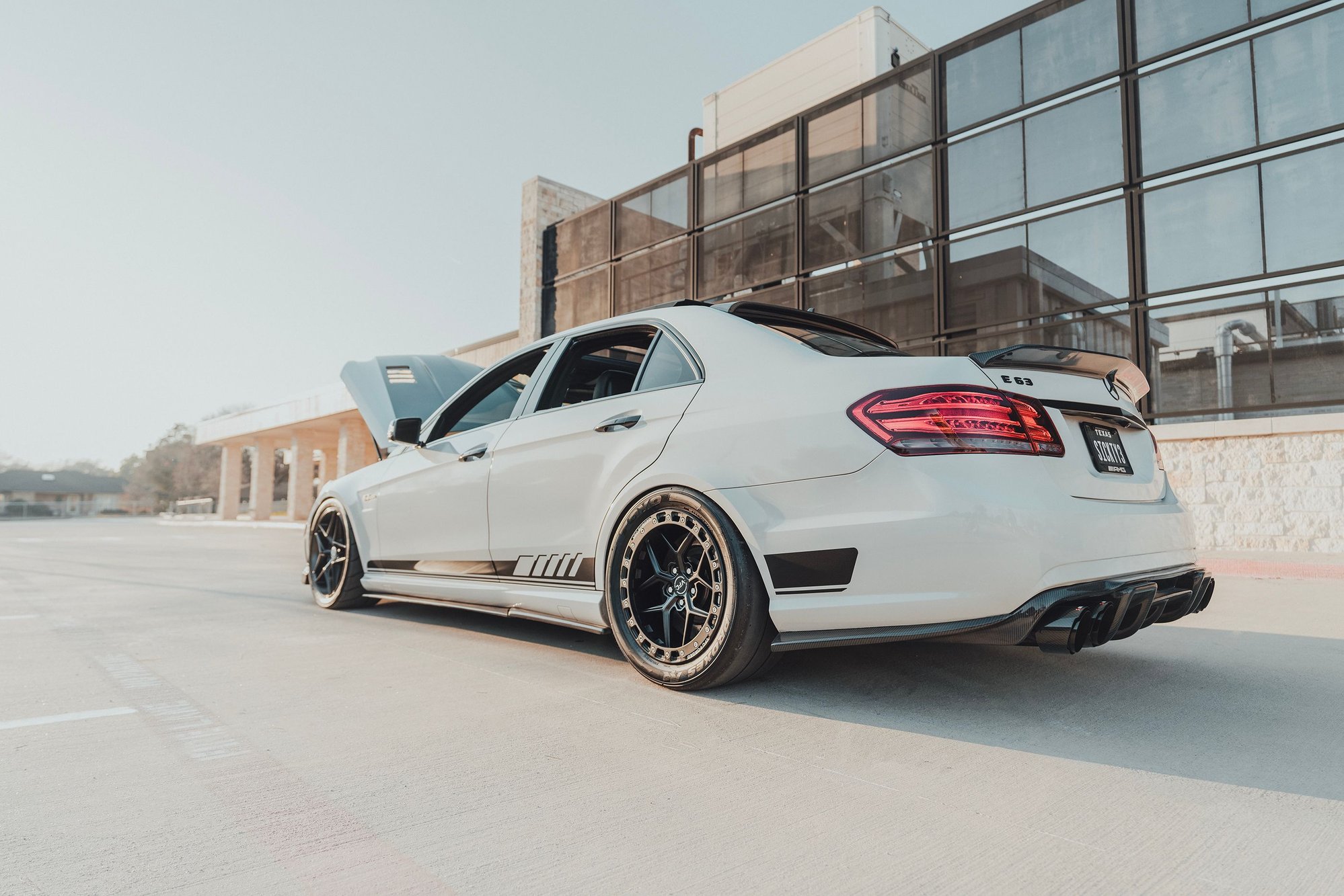

Where'd you get your carbon door handle covers and the roof spoiler? How was the fit? And did you just use adhesive or RTV etc?

eBay like 4 years ago, used heavy duty 3M tape.

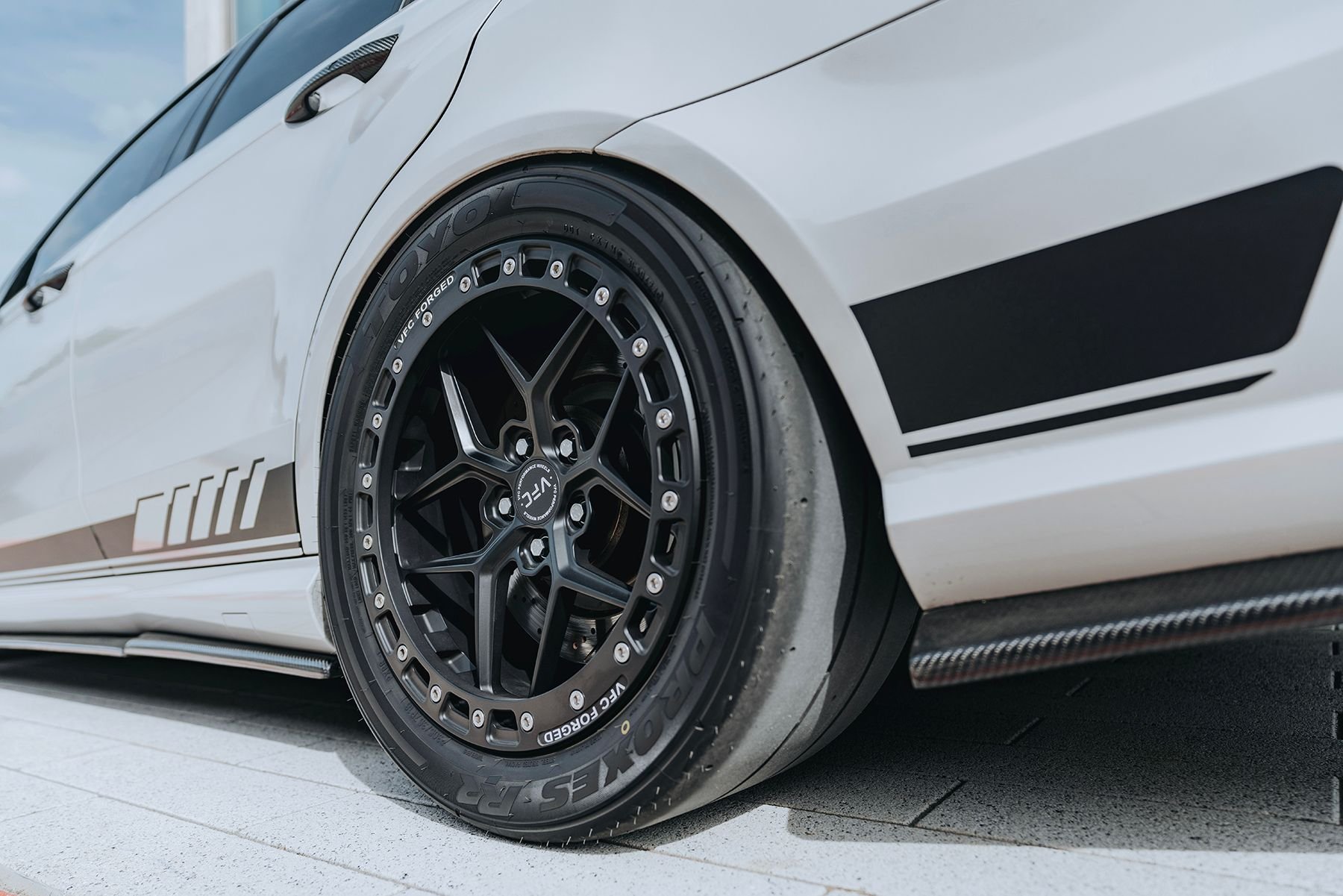

STOUT BUILD. WONDERING if RR's hook/book better than 888's on the street

They do hook better but both have to be heated pretty good to get any traction on the street. Wear life is about the same on both tires.

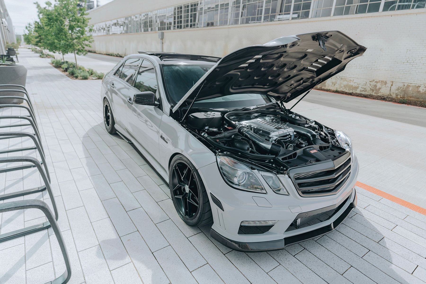

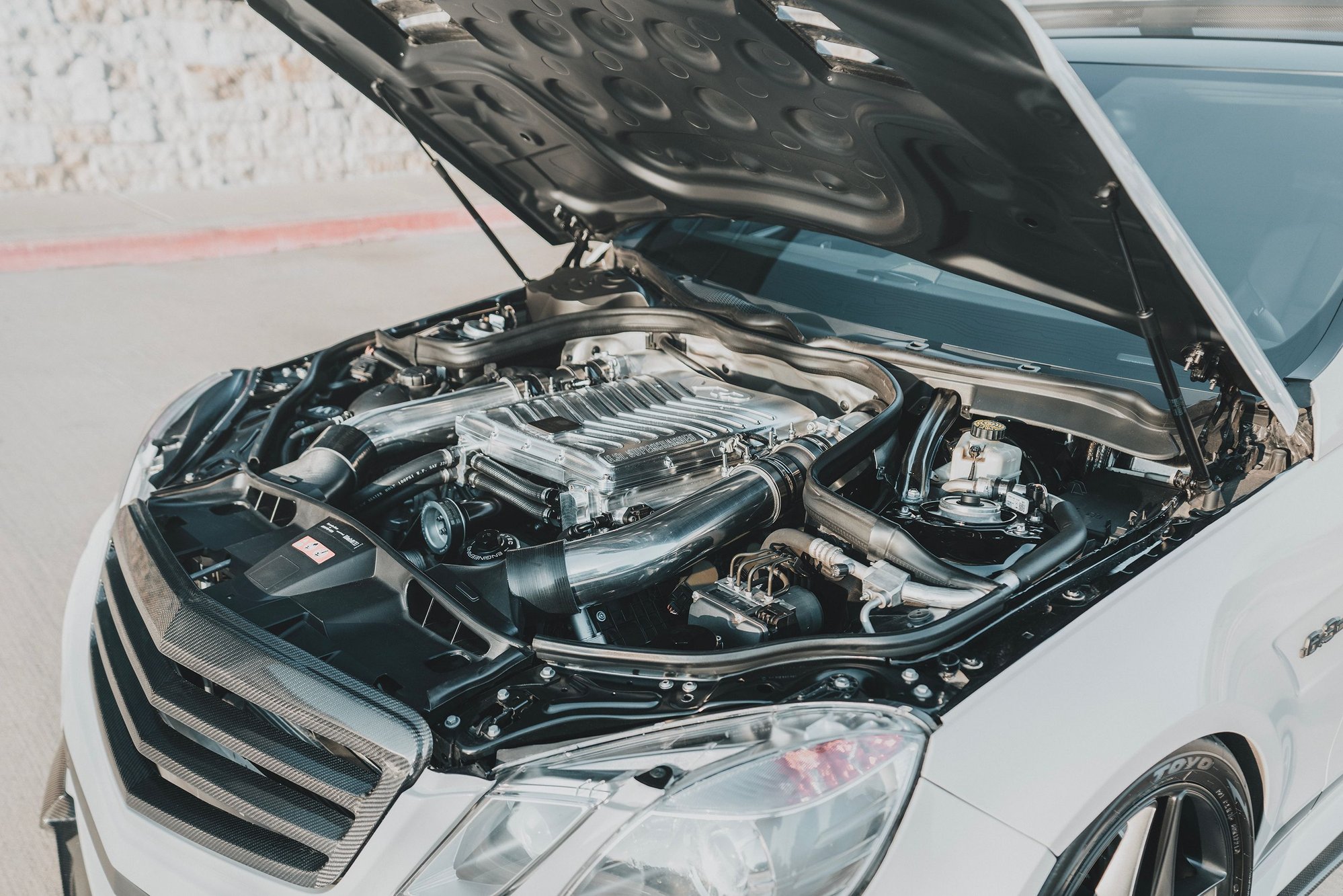

Haven't done much to it, just been enjoying it for the past few months.
I did get a smaller Griptec supercharger pulley to bring the boost up a bit.
Car is an absolute monster to drive, from the 3.0L Whipple, Stage 3 Cams, Full 3" Exhaust it gets a ton of looks cruising around!

Looks so good. How do those RRs hook on the street?

@sickSVT I am curious to know - have you considered bumping it to the new 3.8L Whipple supercharger?

They're 305's on a 18" beadlock so they hook really good once they get some heat on them.

Anything above the 3.0L Whipple would be overkill on a stock motor setup. My 3.0L at 5 psi makes around 700 rwhp, so there's still plenty of room if I ever want to push it to 20 psi. The 3.8L would hardly make any boost to take advantage of its efficiency range.

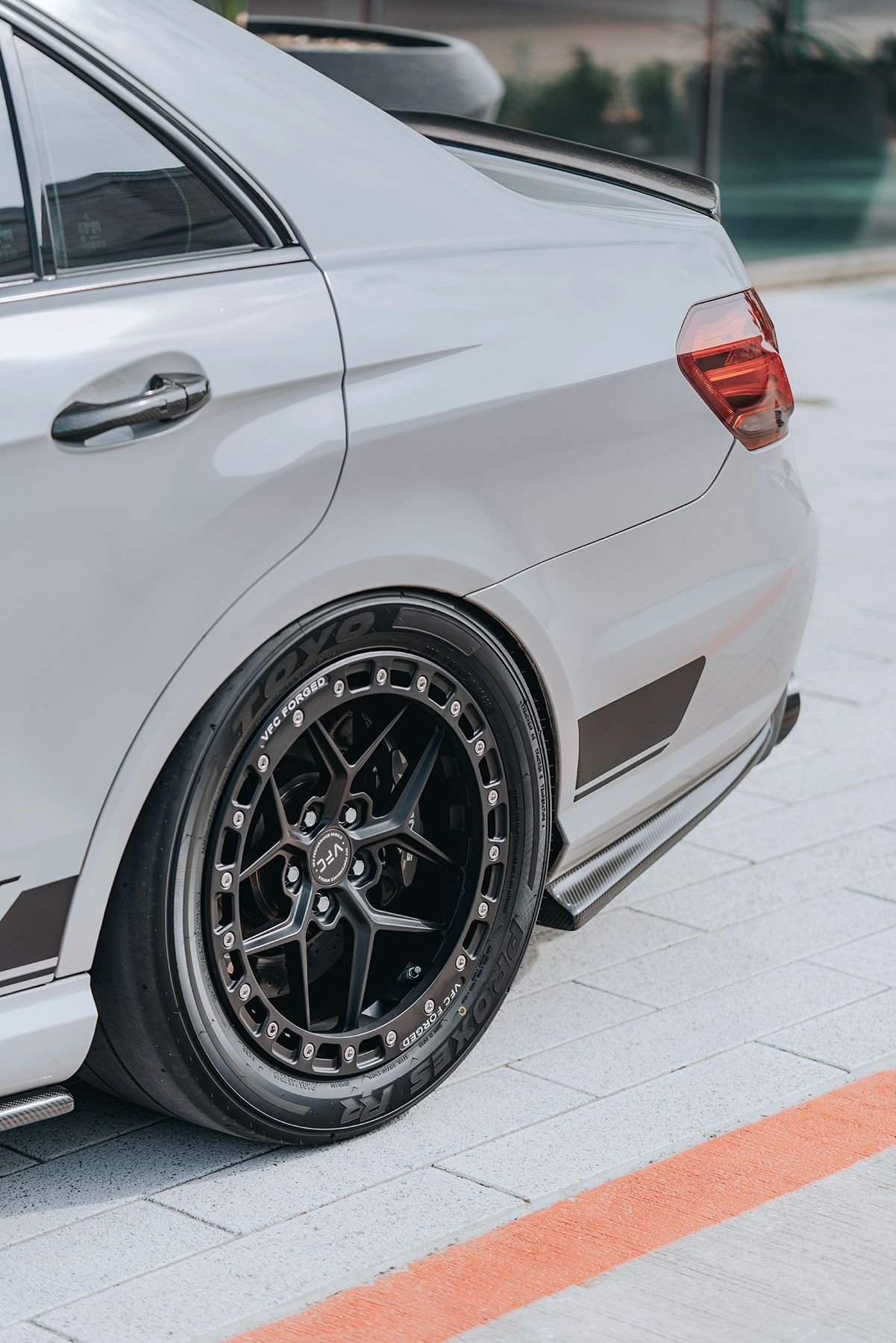

what suspension are you running ?

H&R springs with lowering links in the rear.
