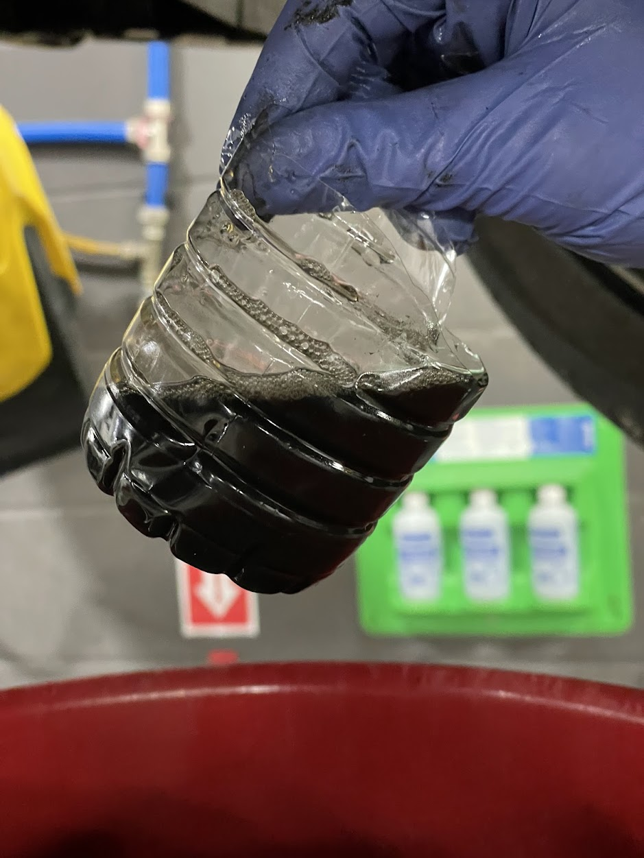

100k miles, at 75k miles I paid my local Benz dealer to change it during a recall or service of the front axle
Based on how black the oil is here (picture below)... I question whether the Benz dealer did a full change or just checked the level. If the former, these front diffs seem tough on oil and should have it changed more regularly.
With the process here, a change only takes an extra ~15 minutes if you're already under there doing an oil change.
Now that I know how easy the front and rear diffs are to change (rear is a dream...), I change them regularly. Same for the SL500 and E55, nice and enjoyable to DIY.
I leave most other things to my local indy.

the benz dealer 100% did not change the fluids @75K
