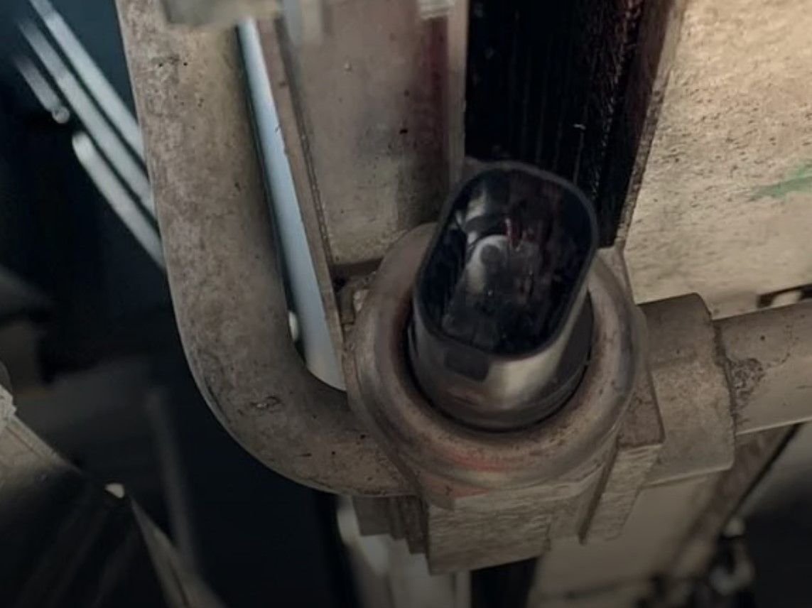

coolant temp sensor (you're going to hate replacing this)
-or-
AC pressure switch
Both are scannable things once you get a decent scanner. not an AMG specific or even a Mercedes specific thing. It's just annoying car things from newer cars that run off 200+ sensors
Can't tell you which one it is cuz I can't tell you how you broke it. Gotta just read data to pinpoint what it is, aka grab a good scanner that reads make-specific data.
