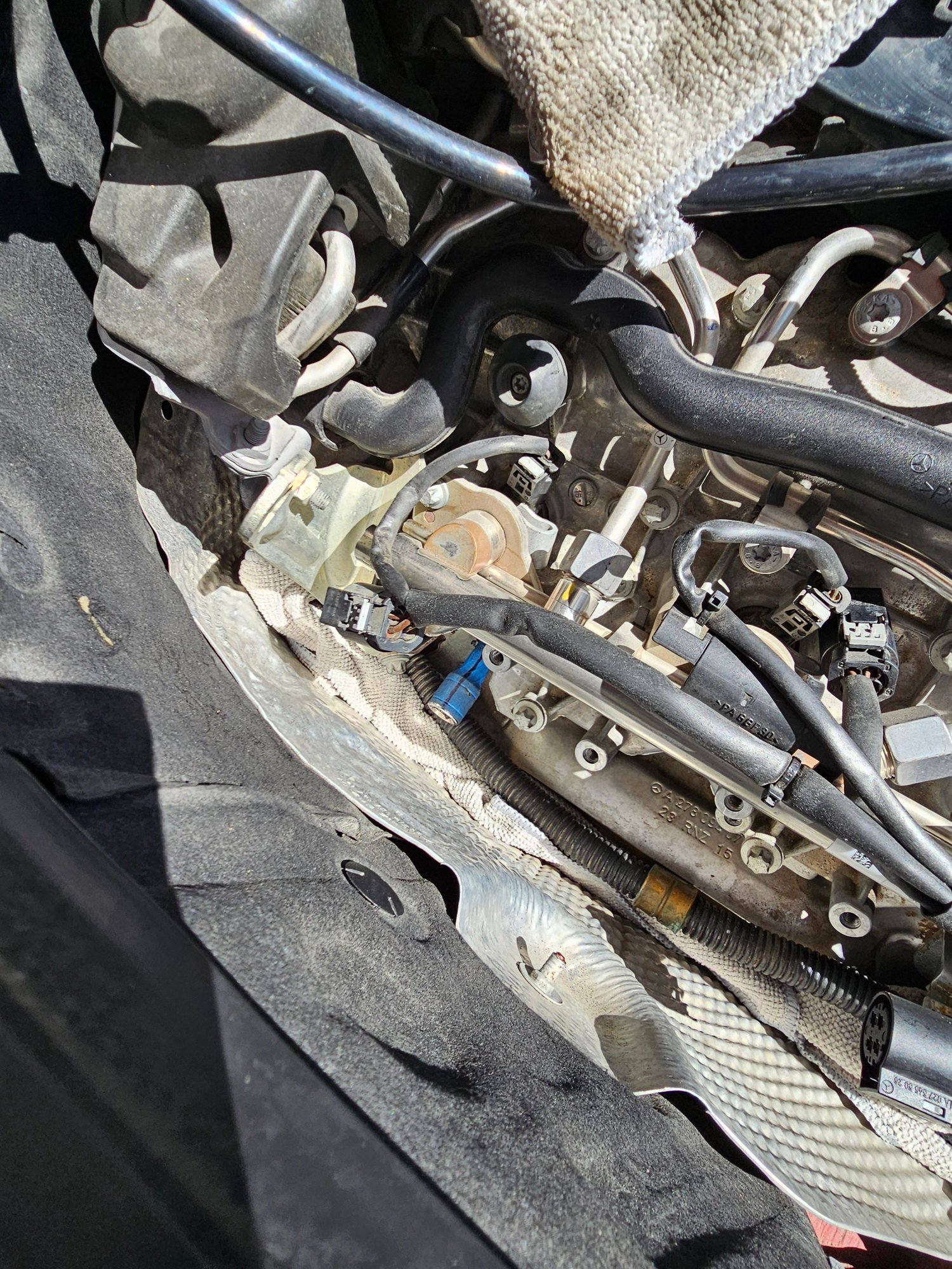

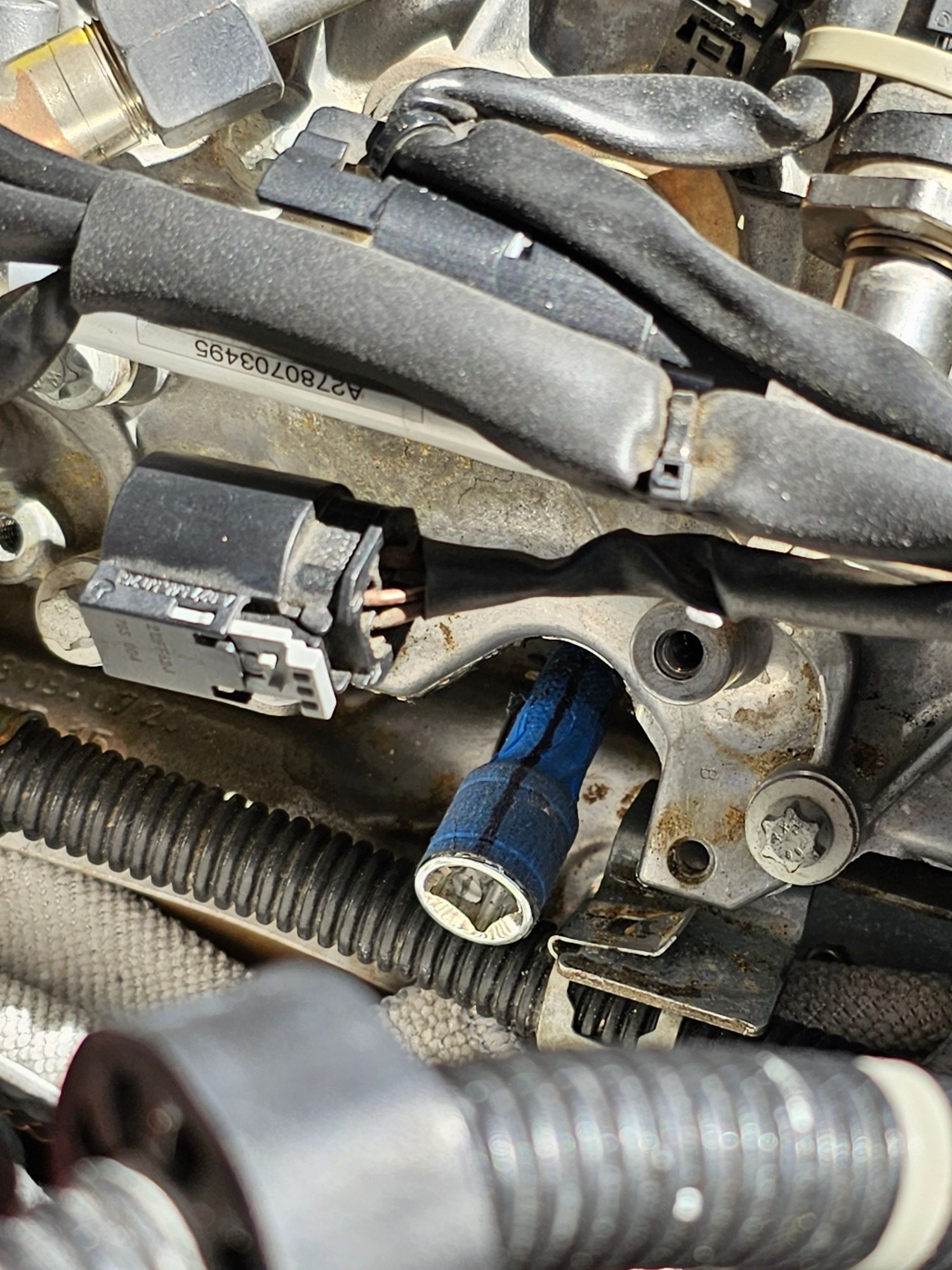

did the passanger side very quick. Much more room than the drivers side. She fired right up and super smooth. I don't know of it's just me but it seems to fire up rather much quicker than before and responsive. Anyways they were all indexed completely straight up.almost all where at 45° prior. Definitely a cool projects if your a bit handy.and you know you did it better than anyone.
