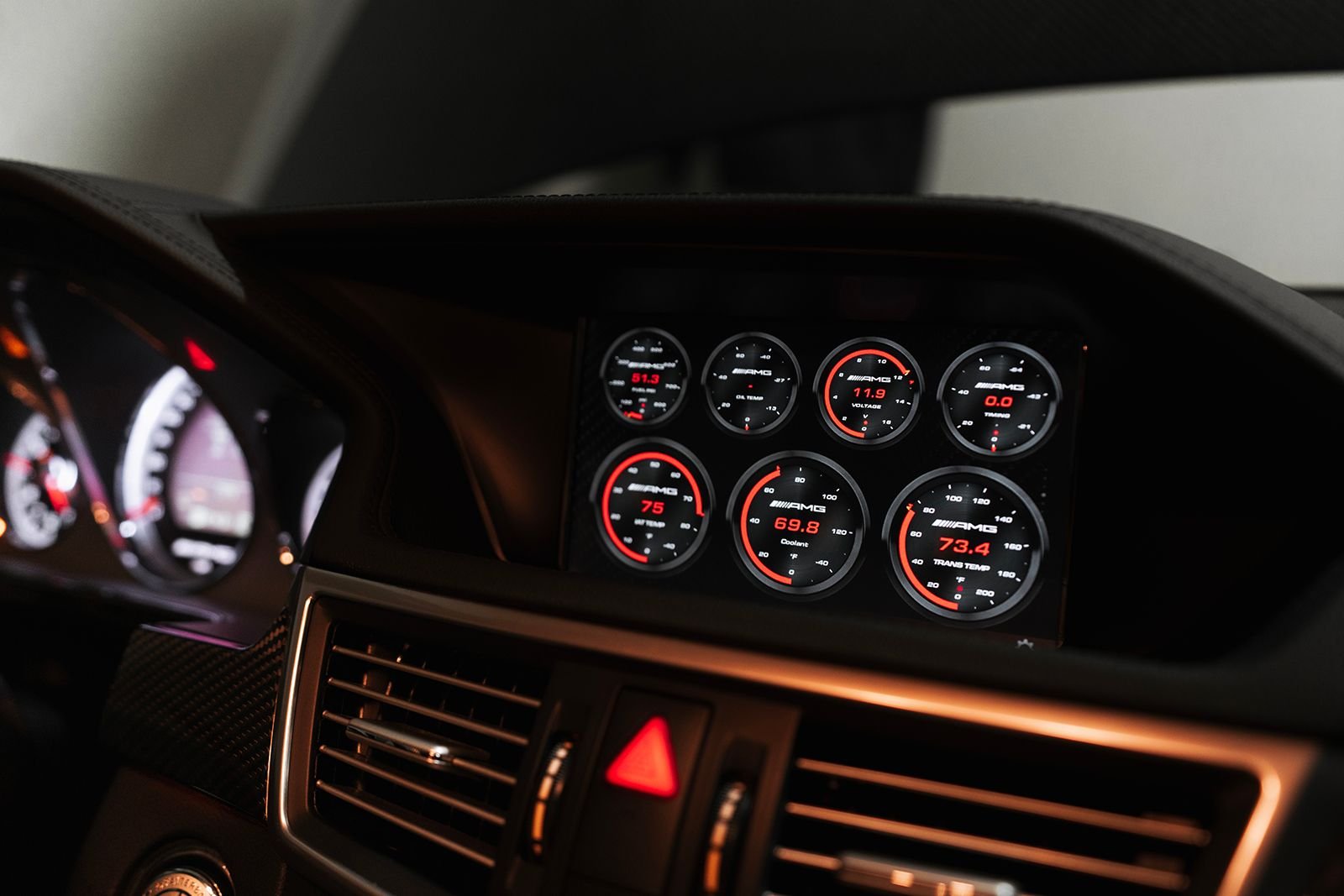

Originally Posted by sickSVT
I installed an 8" Android on mine, looks OEM but it's 1" larger than the factory screen and comes with all of the features.
I mainly use it to monitor my IAT's, Engine Temp, Trans Temp, Voltage, Fuel Pressure, ect.
Much more seamless than hooking up my laptop to datalog with HP Tuners.
Hi, can you share with us the name of your android HU, or some link? I really like it and i want one too for my C207. Thank you !
