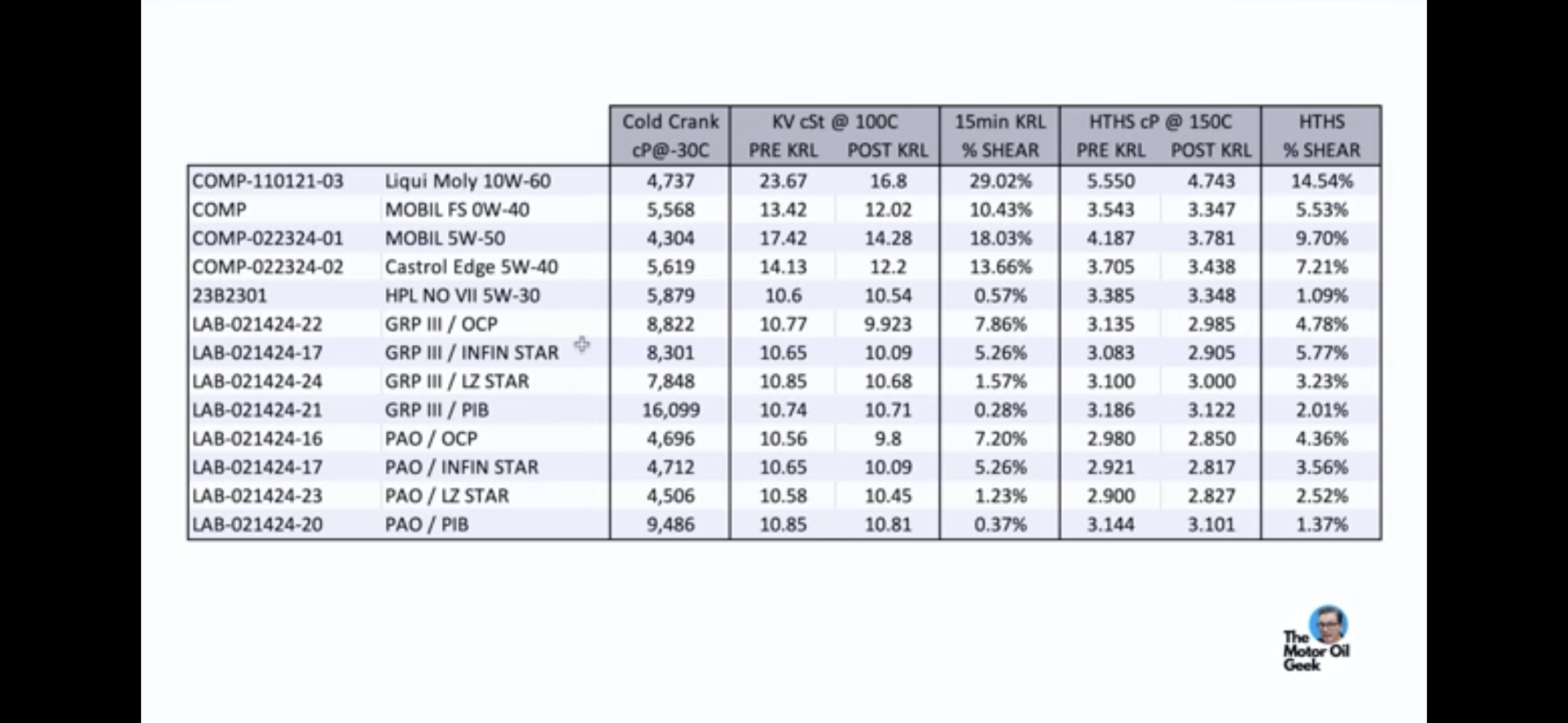

As I consider what oil to order for the next oil change, I thought adding these charts to this thread might be interesting. I’m historically not a fan of the Mobil one before the sp rating was recently added. Could these charts indicate Mobil one fs 5w50 could be the best choice? It’s now sp rated though a 229.3 oil. We know 229.5 requires a fleece filter for longevity, but does a 229.3 still flow well through a fleece filter? Of course none of us should be considering a 10-25k OCI. Are fleece and paper still available for these cars, or just fleece? I’d have to assume fleece lasts longer but is it also a difference in porosity?

We share the same rational understanding
I too am looking for my next oil in 5w50 SP... I think this is the sweet spot for ultimate balance - Not too high not to low viscosity - Good average value over temperature range for normal driving.
(track/race is way different requirements).
ExxonMobil giant is extremely well qualified of course for great lubricants - It's up to us to match our needs
Lake Jr's lab results
Let's have a good look to compare these numbers... many different oils.... not apple to apple.
Any 5w50 SP is a good choice ... how many other matches, perhaps in heavy-duty grade for stability.

Every oil is batch and every oil specs are different. The published numbers are a good estimation.
The W40 vs. w50 numbers are not equal at all.
That's why we moving up to get better oil pressure, less chance to burn oil with higher smoke temp.

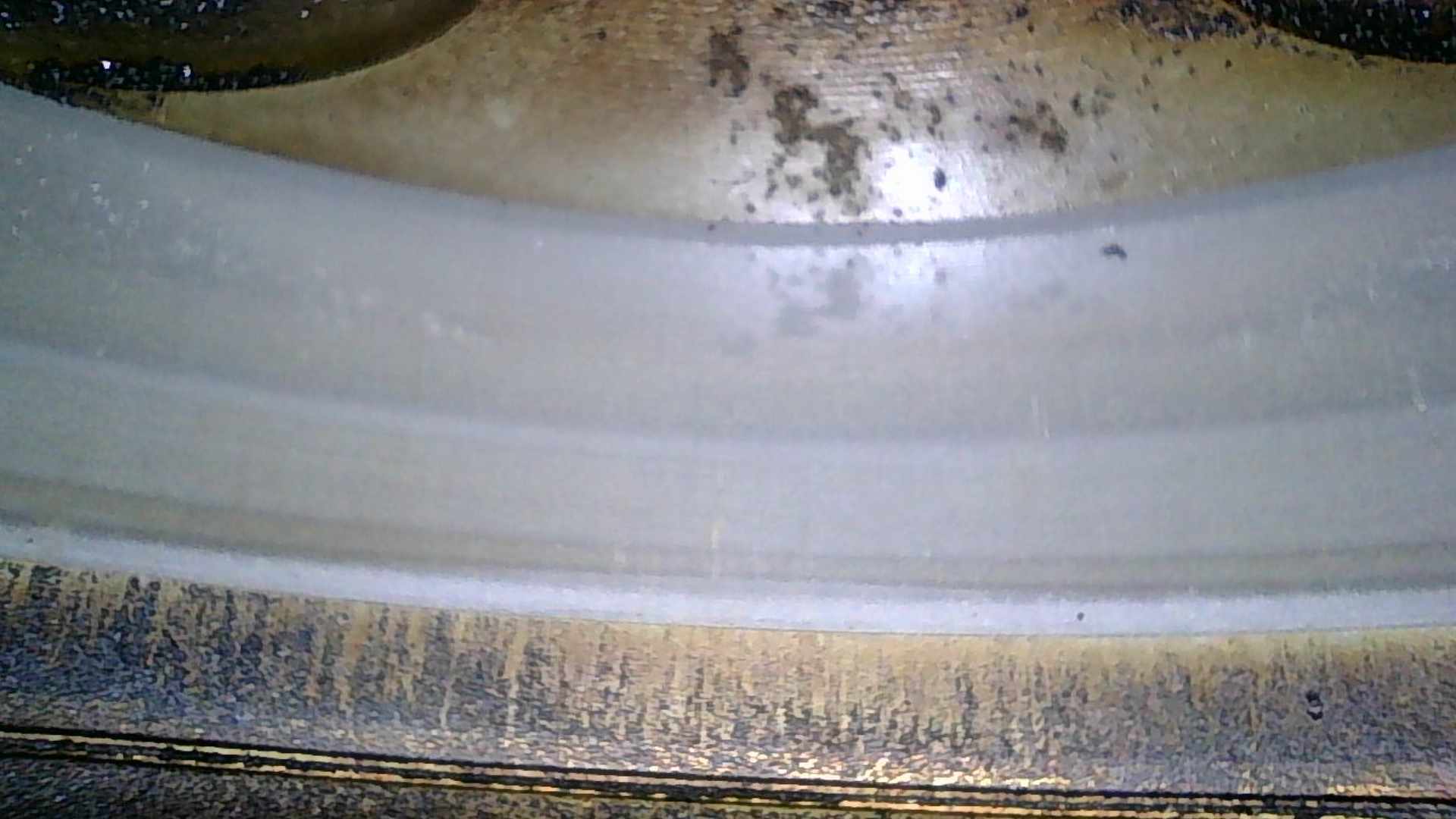

Update - So, what have I done and what are the results.
Sidebar - Ive been doing spring Maintenance of my two vehicles because Im supercommuting currently while building a business. Rear pads, rear tires, Air filters inside and out, oil, and now coils and plugs, boost pressure sensor, and a map sensor while I was in there on top of the throttle body.
I found a cheap launch creader a few weeks ago and then promptly erased my transmission and wet clutch..... Shout out to Mercedes Specialists in Westminster MD for a quick and easy fix, costing only an hour. They were new to me but I could not get through teach in my slightly hilly area. Fantastic service.
Back to the cylinder walls.

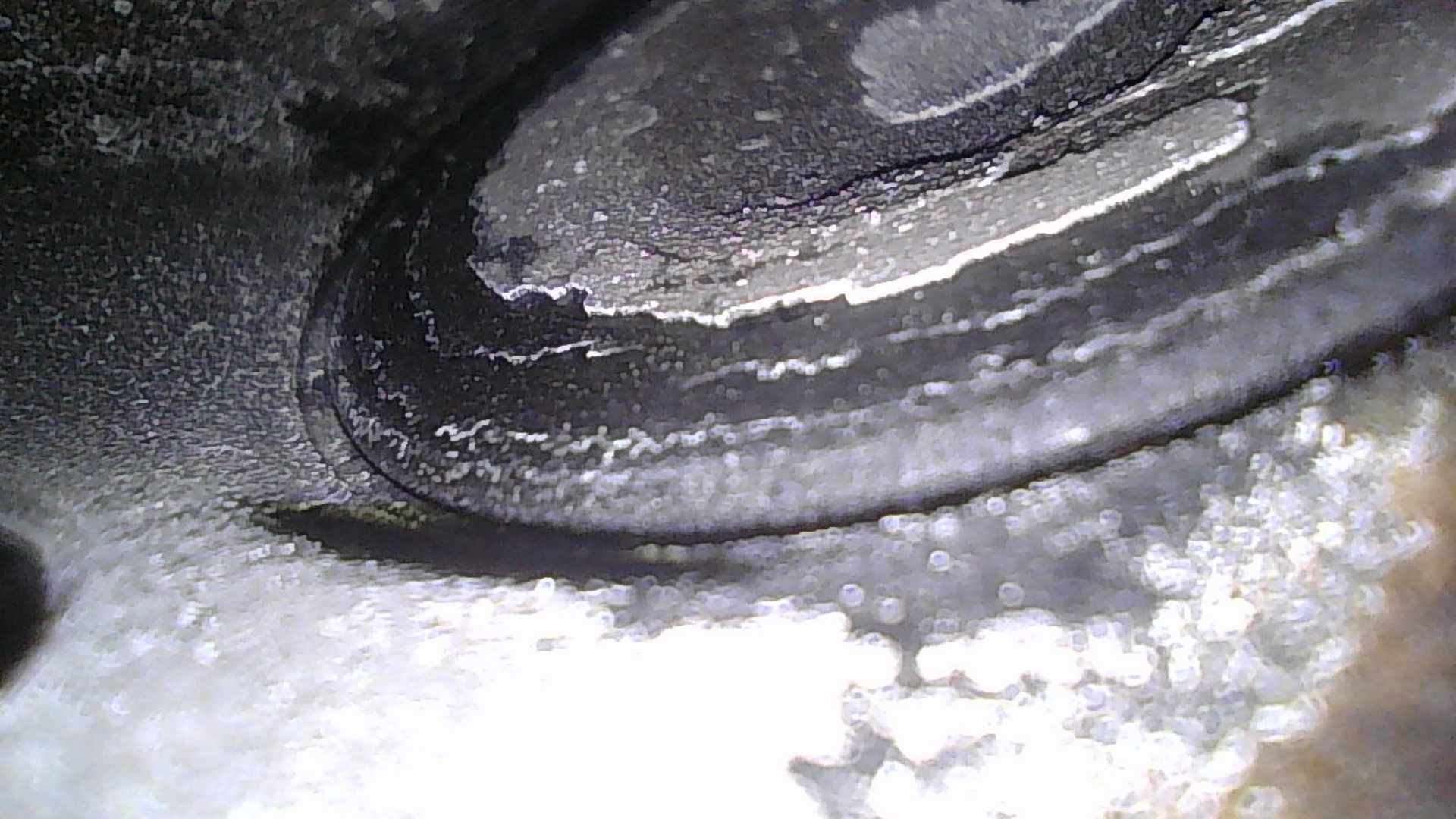

So you may have seen me chiming in here and there about using cleaners to try and rectify my two wettest cylinders, and then remove the ceratec deposits, ultimately from sticking rings. This thread was the start of tracking what I would do.
So above you see my initial use of cleaners. I have since put 5000 miles on the car. In that time I have had the solenoid plugged back in for about half the time due to finishing out a warranty last year and then unplugging again, just a few weeks ago. I used castrol 5/50, changed to Pennzoil 5/40 for the warranty period, and then just put in some mobil 5/50, sticking with SP and NO ADDITIVES. Ive changed the oil roughly five or six times including the start of the thread. Ive used the Proline LM flush two times, one bottle each time (weaker than rec, just due to me being cheap, not worry. The pictures from the first flush were up above, and the last flush a few weeks ago are included below. Besides the flushes, Ive used two bottles of Techron, and one bottle of redline since initially doing the berryman's. I also had my valves cleaned during that warranty work.

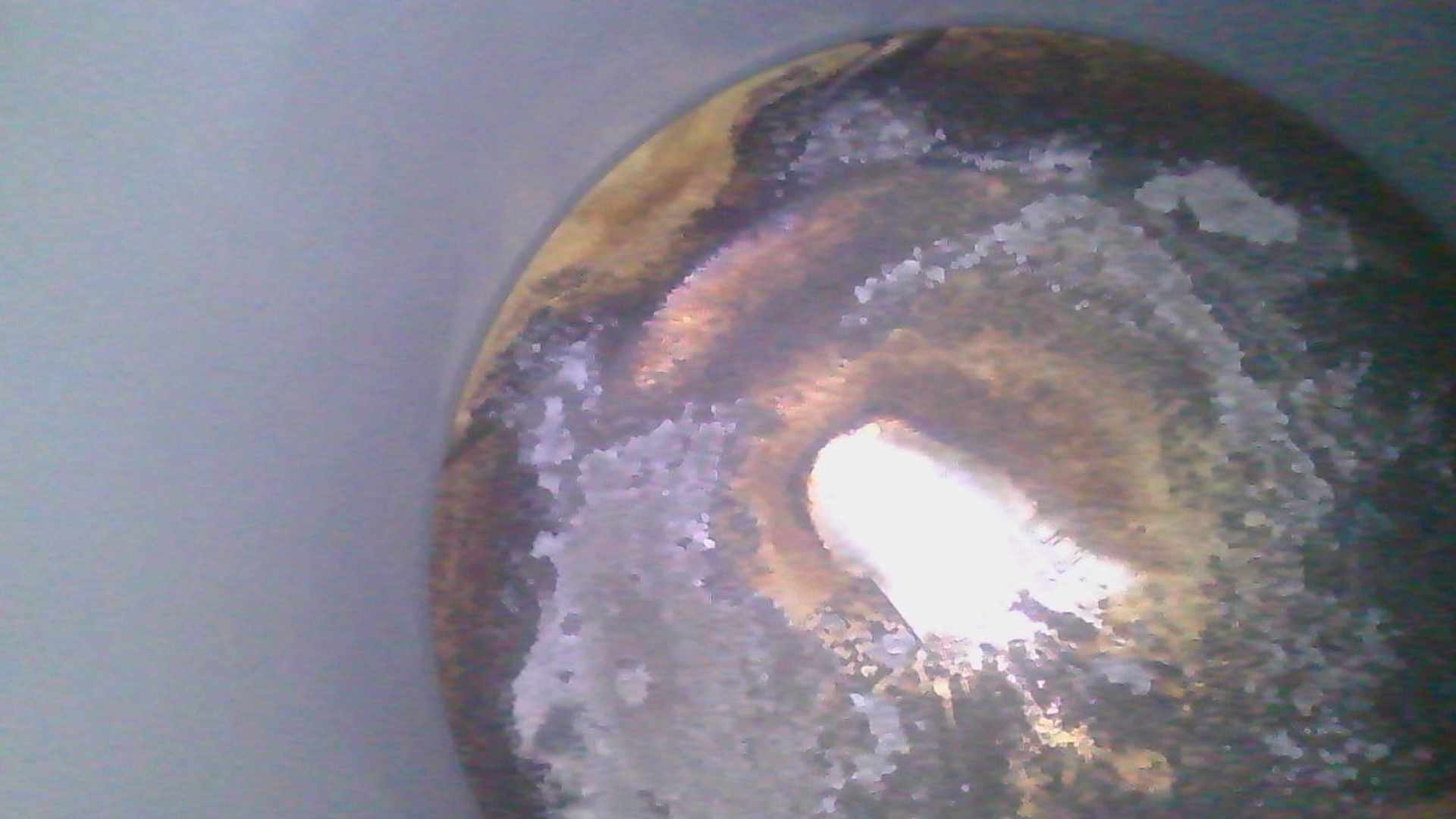

While I was changing plugs and coils I figured it was the perfect time for a picture check in. Any guesses as to if any of what I have done have made a difference? Did I mess up my cylinder walls? What happened....? Do I regret it? Boy I wish they made Restore and Protect for us, as its been great in my LX..
Well, I had never changed my coils and my plugs dont have many miles but were due because the plugs were dirty 5k miles ago and figured maybe the cleaners may not have worked. I put the old plugs back in for a proper test where the only changed variables were the cleaners. Yes I watched Motor Oil GEEK, but there's no R and P for us and he made the statement of understanding that us Euros need a solution as well. I also continued to use a mix of top tier and non top tier, as Id normally do....as my gas bills are currently insane so I dont chase top tier as much.
Here we go...
Fuel injectors are noticeably cleaner. The Ceratec valve deposits are considerably cleaner and now not building, nice there's no additives anymore.
EVERY cylinder wall is DRY
All of the cylinder walls look GREAT, and EVERY piston is significantly cleaner....Look at that QR code..
The dark carbon is turning to white ash and disappearing.

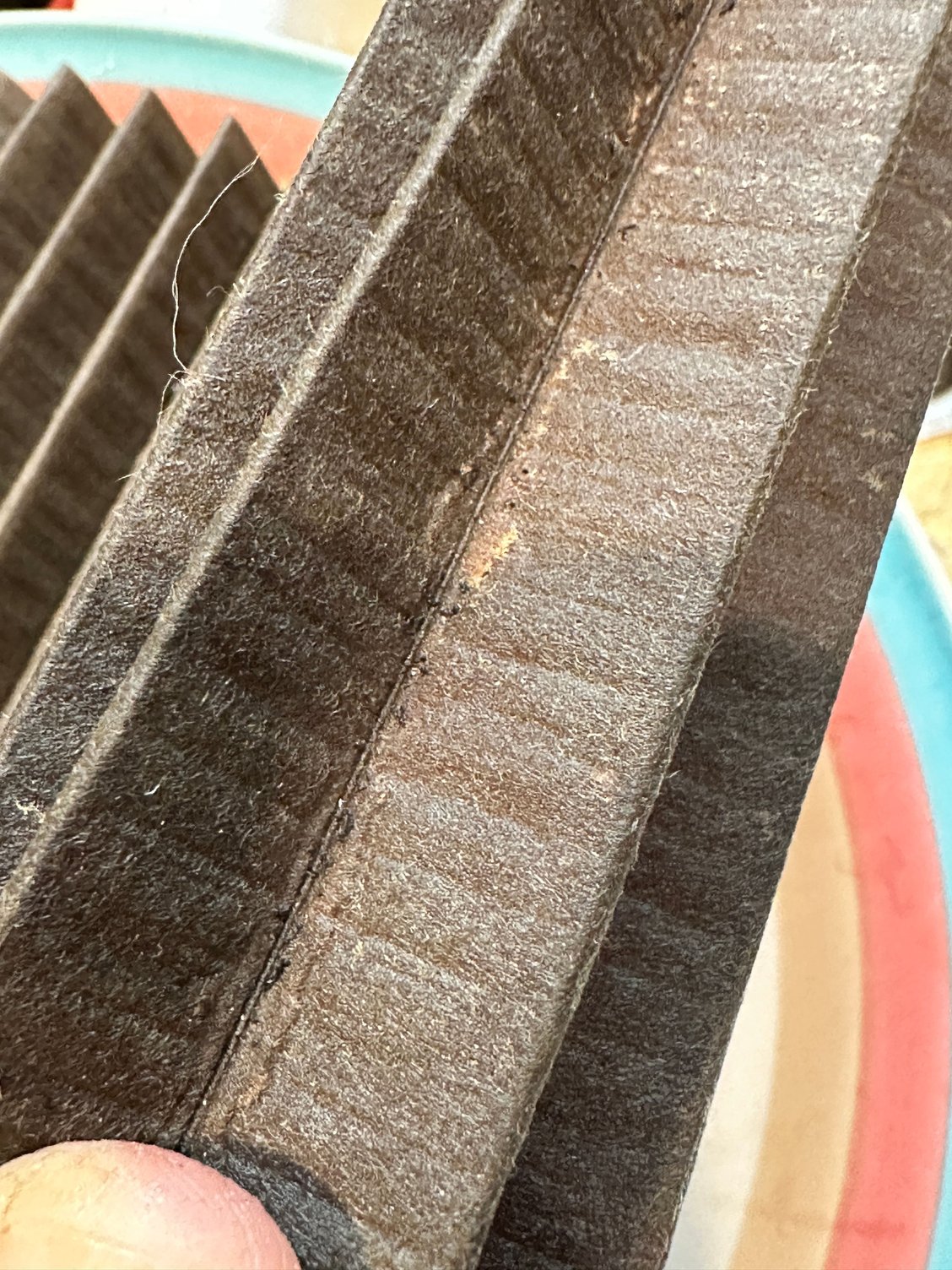

And below, the results from the flush after 5k miles, which was probably 2-3k on the oil.

Seeing your piston QR Code stamp is amazing. Your walls are in mint condition.

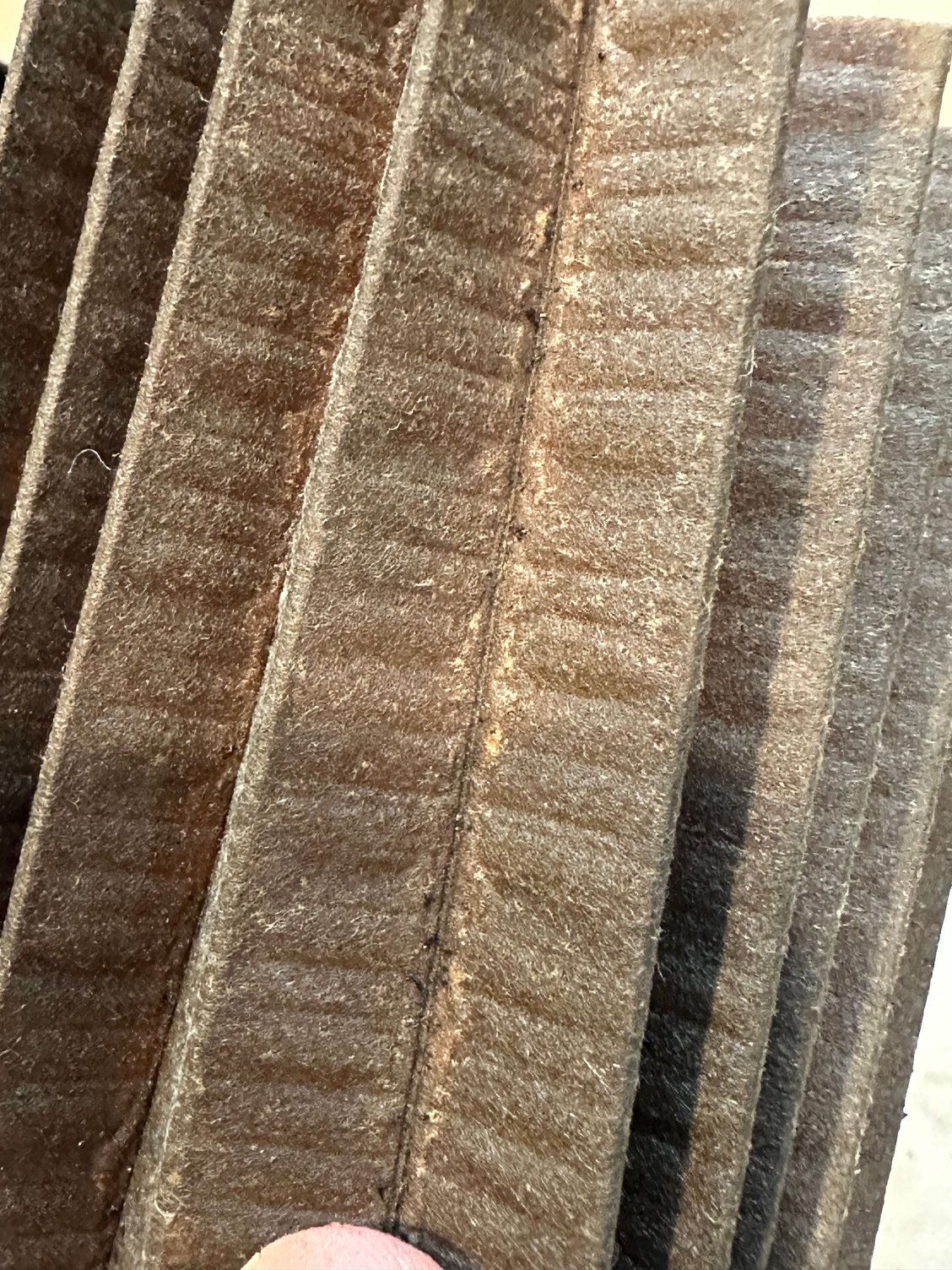

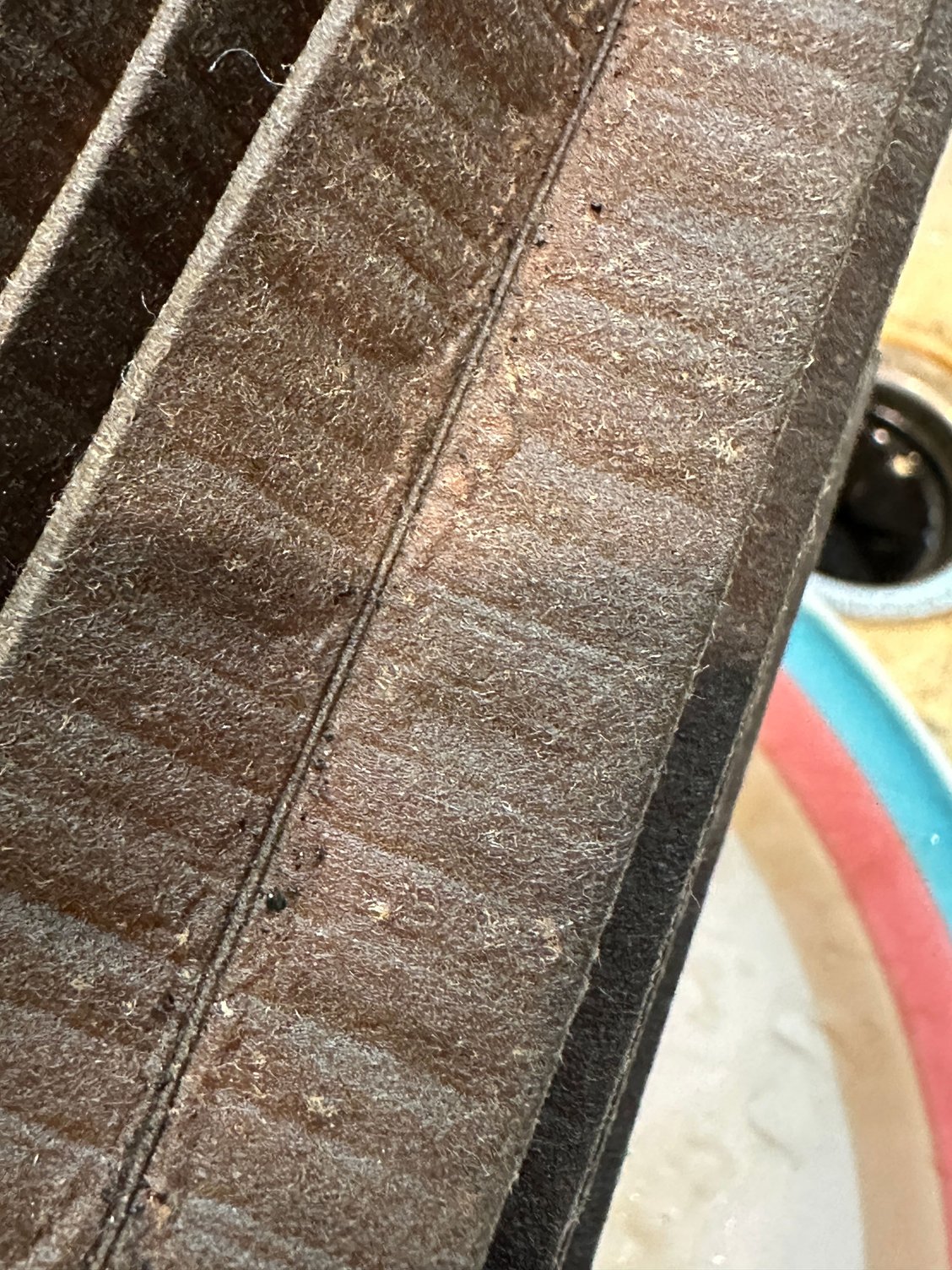

You've got carbon chunkies trapped in your filter presumably coming off your pistons. A step in the right direction towards effective spray cooling.

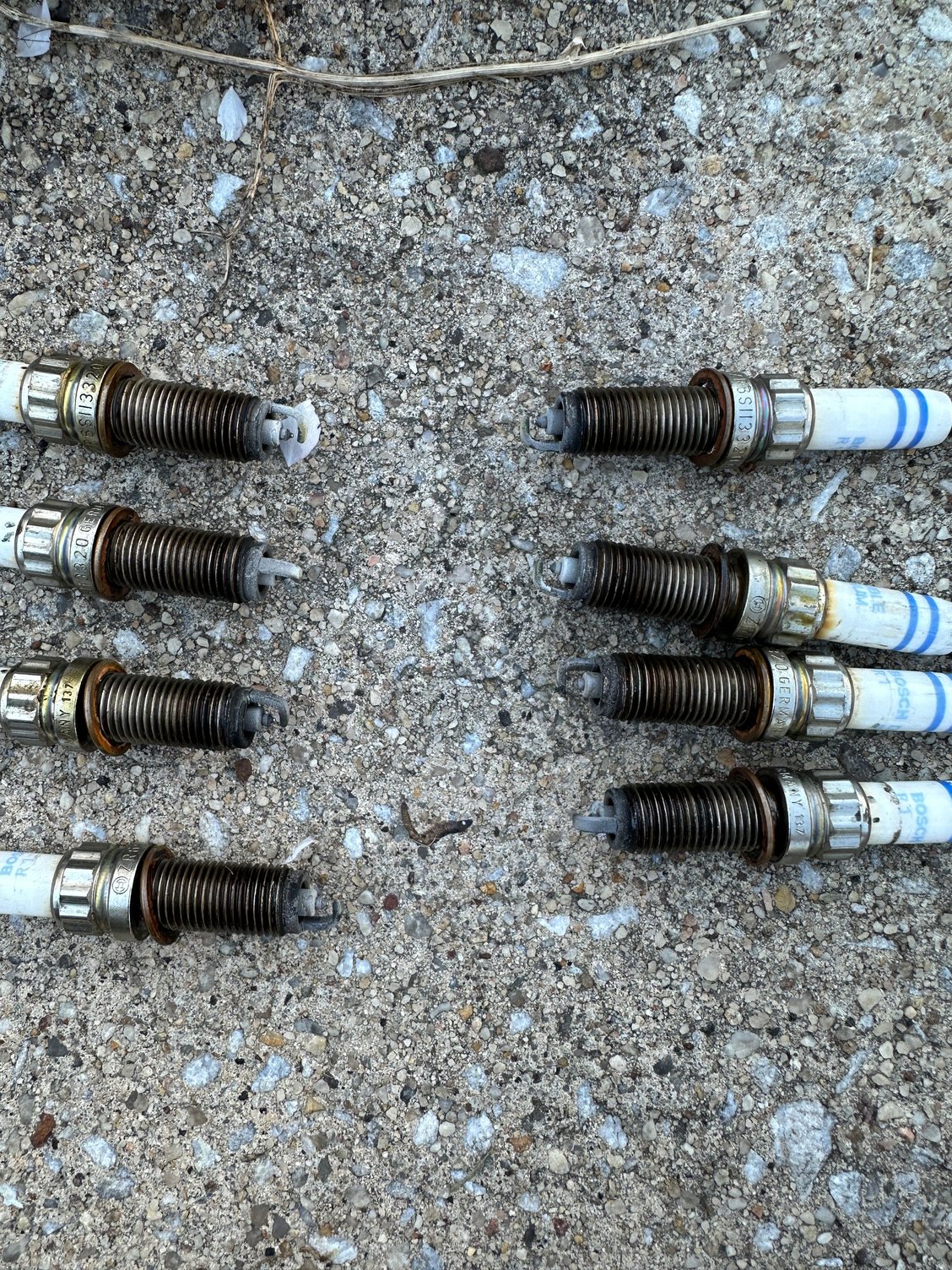

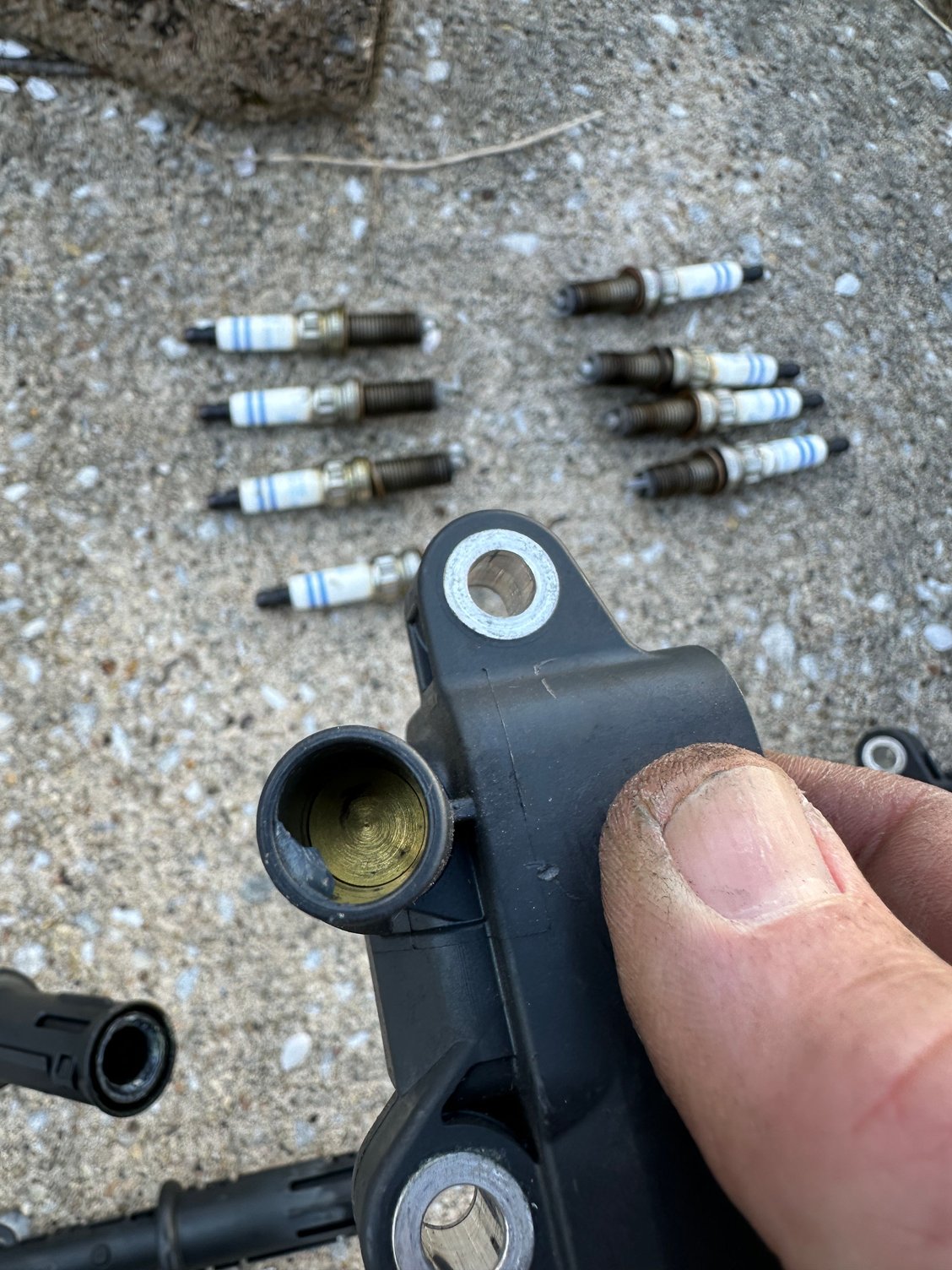

Some pictures of the plugs and coils. I I never usually start to replace coils until I notice a problem and these all seem clean so I’ll keep them as spares. One thing I noticed is that the coil boots were different on this round of Bosch coils that I got from FCP. The boots were the only thing on the old coils that showed a little bit of corrosion inside the springs. I even have eight sets of boots in case I was just going to do that part.
As for the plugs, they look better than they did in the beginning of the thread, just like the Pistons, etc., do. All of the plugs were dry. Those still had the sand appearance. The plugs had approximately 20,000 miles on them. New plugs from fcp came pre gapped at about 28. The new plugs were clocked at about 10-1030 and to get to 12:00, would needed to have had the washers sanded.
I left them as is, but we’ll go back in when I have some time to clock them to 12 o’clock because that’s how I’ve always done it and I want to stay consistent

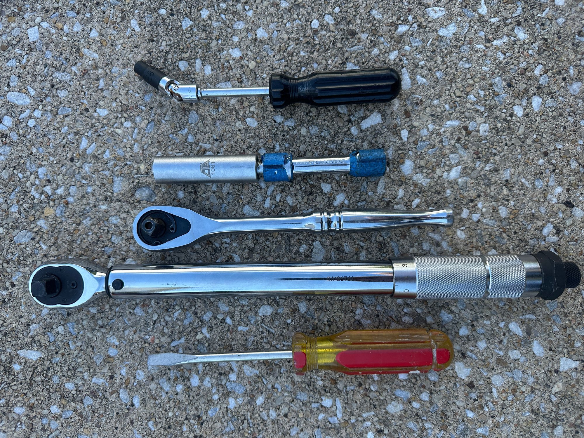

All of the tools used for coils and plugs. I purposely used the most minimum amount of Tools so I could share that it could be done with just these items. I did not need anything else though if you want to measure torque on the coil bolts, you need that adapter or proper torque wrench size/scale, which I have as well.  In order to do the map sensor, I added another etorx as well as a torx bit into the pile
Coil electrode surfaces all looked pristine
This would be the plug view from sitting inside the car, same positions as the other plug pic.s
This would be the plug view from sitting inside the car, not the same as above

Two more thumbs up on tending to best ignition despite low 20kMi. We take nothing for granted: good call on your new plugs!
GDI ECU absolutely needs precise timings on all cylinders.
Your engine still tends to coat everything with remaining white ceramics... known to be effective high-voltage insulator.
> Phaser mapped control.
The phaser solenoid PWM positioning vs. Rpm is not computed live, it's mapped.
When the oil pressure changes, the ECU slowly relearns these adaptations data.
Disconnecting pump solenoid and changing oil viscosity is not inconsequential - It corrupts the data of this positioning logic.
The camshafts positioning directly affects the air intake and thereby the A/F trims. This is a source of misfirings.
Once you are aware of this, no need to over react.
One of the goal of MOD-X:5W50 is to provide VVT solenoid smooth oil pressure without pressure ridges near 2kRpm.
When you switch back and forth MOD-X to MOD-0 the phaser map is made irrelevant.
Instead of engine running better... it runs worse from lean mixtures.
The cam control logic has very limited ability to respond to any unexpected pressure events such as:
  1. pump switching!
  2. viscosity switching!
  3. squirters opening!
These stock issues is what 5W-50 help address.
Camshaft positioning must be really precise, just like ignition else misfires.
The plugs are definitely coated in the ceramic and the spark is surely improved. Im sure that stuff is everywhere and you can see a bunch in the newest filter pic. Im happy that is Slowly eroding so it doesn't clog anything but damn, one cant help to think it could be in the vvt actuator screen. I only think it will get better and better over the next 10k miles. Today was the first day driving since the new coils and plugs and she felt great. Ive driven this car about 95% of the miles in sport plus, and the rest in comfort. Im hoping to train the comfort mode to be a bit better than it is, for these long commutes or im going to wind up in jail constantly in sport plus;/
Yep, I agree with this thought process on timing. My concern is that my cam timing adaptations on the right bank are near zero, and the left bank intake is around 2.5 degrees, and the exhaust is about 4.5 degrees. Interestingly before the initial solenoid pull, it was at 3.6 or so. So to me, this means the reluctor wheels might be slowly shifting. Just about any sensor that may have read "not perfect" has been replaced and the adaptations never change. None of the testing reveals a different pathway for me to think about. Ultimately I hear we get a check engine light at 6.5 degrees. I will prepare for phasers, and perhaps some camshafts in the future, but would start by trying to pull valve covers, inspecting and pinning the wheel.
Thanks for taking the time for your input, always appreciated.
The car runs great, Im just a tinkerer at heart and like to act preventively....hence the ceratec disaster. As someone involved in agriculture, I should know that you can easily kill something with too much love...ie water or fertilizer in ag, or the wrong additives for cars.
