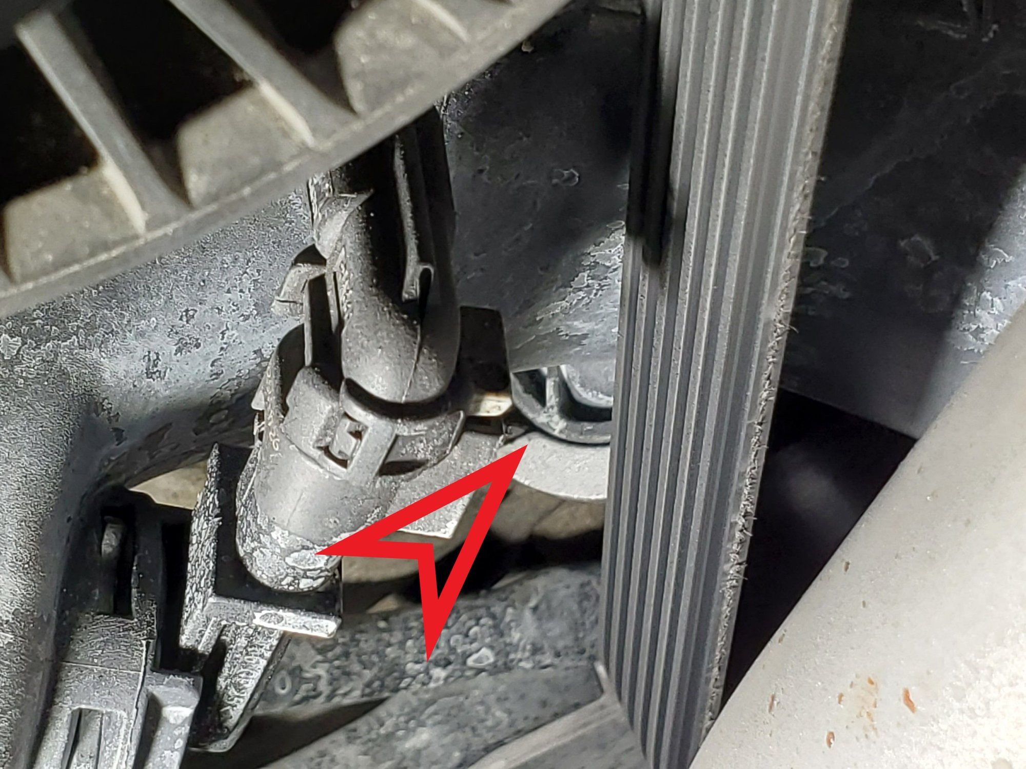

Old Mar 5, 2025 | 09:28 AM
OldManAndHisCar's Avatar
Joined: Jun 2021
Posts: 3,115
Likes: 1,348
From: Fleriduh
W212 E63S Wagon - GSL580 - E63 - E350 - C300
Originally Posted by Jaybird123
Thanks much! Is it humanly possible to replace it WITHOUT pulling the thermostat by any chance? Hate to disturb that fragile pos since I’ve already replaced it
Nope, I do not at all see a way to get at it with the thermostat in place....images are before and after on my car.
After
After
Before
Before
Old Mar 5, 2025 | 09:41 AM
After
Before
Wow ... thank you for the most helpful photos
Was the thermostat housing the only part that needs to be removed?
Old Mar 5, 2025 | 09:49 AM
Joined: Jun 2021
Posts: 3,115
Likes: 1,348
From: Fleriduh
I just took a new picture as it sits....removal list:
  • drivers side intake
  • serpentine belt
  • thermostat
