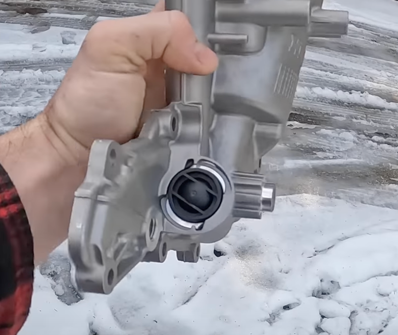

I own a 2013 E63 with 145,000 miles. Over the past 40,000 miles, the engine has developed two major oil leaks from the Oil Filter Assembly. There is a 1.5 inch black plastic 'oil filter cover' (PN A278 180 04) that is located in front of an internal valve and a spring within the Oil Filter Assembly (#50, 60 & 70 in the MB diagram). For some unknown reason, this assembly pushes on the black plastic 'oil filter cover' which then spews engine oil. WHAT IS CAUSING THIS TO HAPPEN? The PVC / Crankcase Ventilation Filter has never been replaced, so I suspect that it is clogged, which creates too much pressure in the crankcase, which then unloads this oil filter valve? FYI. I grabbed some of these Oil Filter Assembly photos from a You Tube video regarding the same subject but there was no explanation for the issue so I'm seeking help. I am grateful for your knowledge and assistance.

You 140k.Mi. M157 is leaking oil from multiple places...You already understand this comes from crankcase pressure.
> How to deal with that ??
  • you can reduce crankcase pressure...
  • replace PCV + plugged up duscharge hose Line
  • decrease pistons blowby pressure leak
  • replace only few hardened oil seals
  • fix known leaks (CPS) & issues (stuck rings)
filter + cooler + Tstat
filter CAP + cooler + Tstat
Nos 170 +180
Nos 60 + 50
No 90 (+ O-rings)
The more you seal crankcase pressure by replacing new seals, the more it's going to stress your rear main seal and timing cover seals too. Either may become a terminal condition.
So reducing the source of blow-by pressure should be a top priority, not the dirty leaks.
