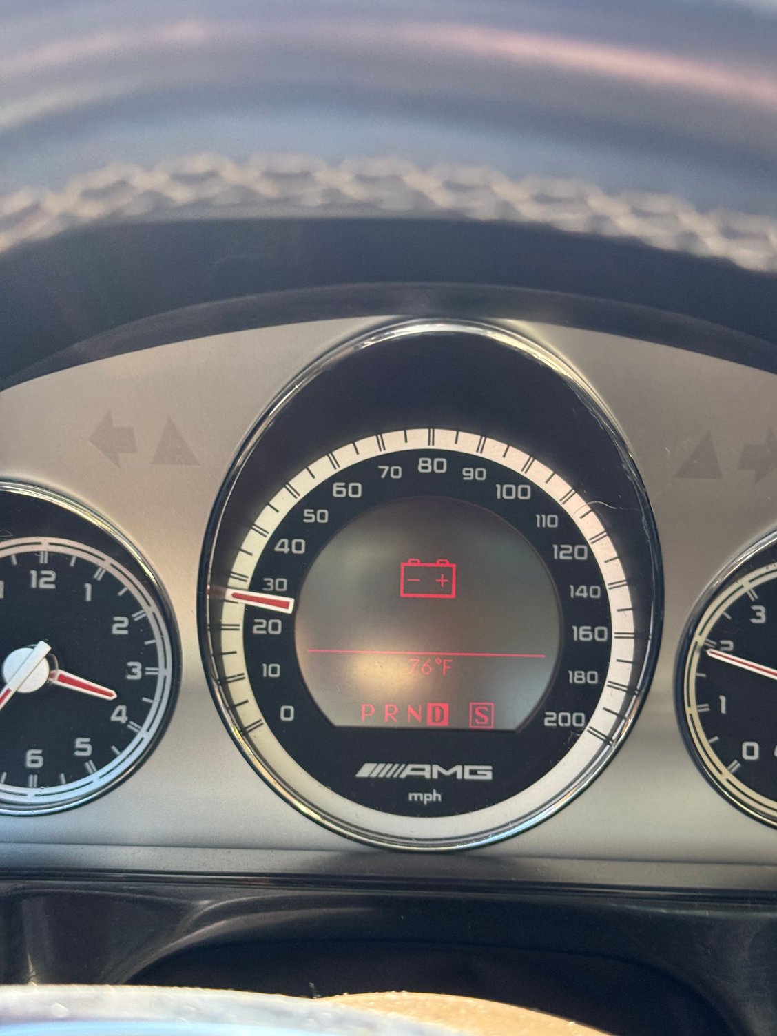

Okay so I took it back to the last shop today and they swapped in another new bank 2 upstream O2 sensor. That cleared up the fault. Still have some hesitation events however. I was hoping they would clear up after letting the fuel trips re-adapt again. The drive home was stop-and-go for about 40 minutes probably averaging 35 mph... So I thought it might not be the best condition for adaptations.
Anyways, as I was getting close to home, my gauge cluster screen lit up red with a battery symbol... Shortly after, my infotainment screen shut itself off. Thankfully I wasn't far from home and I made it back with no issues. I left the car running and hooked up my scan tool to now see more new codes.
1337 - Communication with the starter or alternator has a malfunction.
0365 - The output for the actuation of the alternator has a malfunction.
I checked the alternator live data page and it seems to be sitting at the minimum of ~11V. Although curious it shows no electrical or mechanical fault with the alternator. ALTHOUGH, I do remember seeing an electrical fault on this page before with no error code just a few days ago when looking around at all the live data prior...
So it looks like I need a new alternator. Appointment booked to tomorrow morning. $1100 quoted for OEM alternator. 2 hours labor. Feeling hopeful somehow.
It's really curious how I all of a sudden got these codes. The electrical fault to the O2 sensor could make sense if the voltage was too low going to the sensor, but why just that one? And why after it had been replaced with new? Maybe the old one was just done for and not reporting properly?
And regarding the hesitation / lurching symptoms, bad voltage to any of the fuel mixture components could maybe cause this. But I'm out of my depth here so not sure.

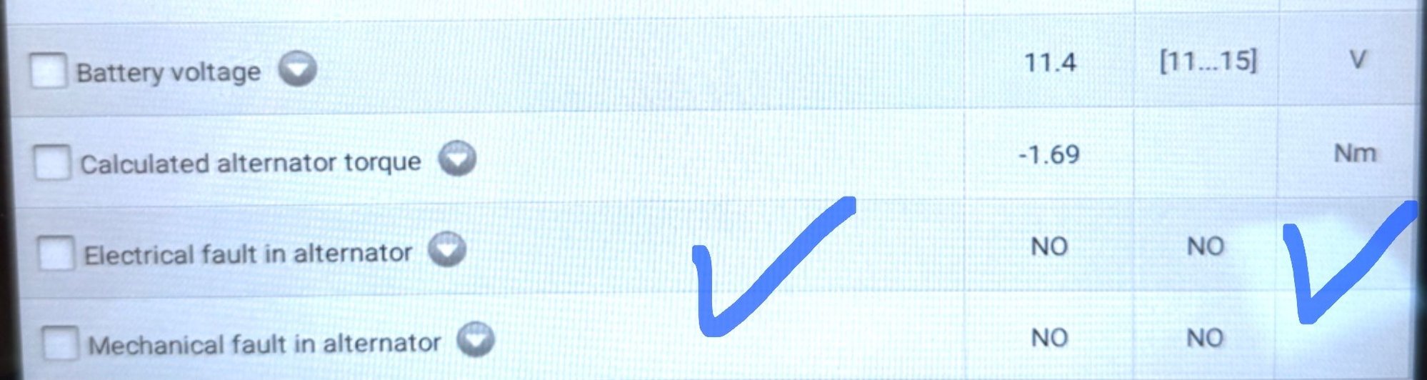

I think I'm only able to see the alternator data shown in my screen shot. Which doesn't include ALT RPM. The screenshot doesn't show the electrical fault BUT I did look at this page yesterday where it did show an electrical fault.

BAD ALT REG
ALT DATA : "NO FAULTS" ?!?!?
That really means no COMS!
not a bad connector
not the bad pulley clutch
not bad rectifier diode bridge
but a regulator issue:
(loose screws or bad module)
Video shows a clean ALT, not oiled up.

ALT NOT REPORTING
Originally Posted by ZackaSnack
Maybe you missed that I just saw it reporting an electrical fault yesterday. But yes it’s curious it wasn’t reporting a fault in the live data while the was an active code for an ALT failure.
I’d feel better about it being replaced entirely as it’s the same labor to just replace the regulator.
-- The ALT fields are unpopulated and seem to defaut as "No" despite ALT being unable to report.
-- It should really be shown as " - - - " for blank data.
-- That logic is misleading.
The ECU is smart enough to trigger a fault about non-responding ALT.
Unfortunately things have taken turn for the worse.
I attempted to drive it to the mechanic shop today but the battery had none of it.
When I started it up at first today, it started fine, but after idling for a few minutes, it started misfiring like crazy. Flashing CEL. I shut it off. Started it back up and it seemed happy after that. No CEL…
I thought it was well enough to drive to the shop. Nope. Made it about half way before everything electrical started shutting off… it went into 30 mph limp mode on the highway. I pulled it off the road and tried to kill it, but the engine would not stop. After about 5 minutes, it started revving and after another 5 minutes I hear a pop and smoke coming from the driver side engine bay…
Thankfully there was no fire. I’m thinking the car overheated from the fans stopping from dead battery (from the ALT not charging it)… And a hose blew or something. Quite a lot of fluid in the engine bay. And it looked like my car decided to take a wee all over the road.
After about 30 minutes waiting on the side of the road for a tow truck, I mustered the courage to check out the engine bay…. Greenish fluid. Coolant I think? Didn’t have much smell. Or it may have been the washer fluid? The top was on however and I didn’t see any culprits sticking out. Alternator seemed to be in one piece also…
Anyways, got it towed to the same previous shop so hoping whatever fluid busted open isn’t anything catastrophic or the fluid didn’t ruin anything electrical… Should know something by the end of the day.
Update after the shop has had some time to check it out:
The pop / vapor was the radiator. It busted open apparently. So currently looking at a new rad and new ALT. Could've been much worse I guess...
Also having them clear all electrical codes and recheck them for any possible residual electrical damage. And they're going to do a Block Test to verify head gasket integrity.

I’m thinking because the coolant was boiling from the engine overheating? The battery was dying completely with it not getting charged from the alternator. It was already a warm day here and I was halfway through my drive.
All the electronics started shutting off but I could not stop the engine. Once I stopped the car, the engine started revving on its own (bad voltage to the ECU maybe?). That, in combination with the radiator fan probably stopped. Radiator go boom!
But in all reality, it must’ve just busted open at a weak point rather than the entire radiator literally exploding into pieces…
