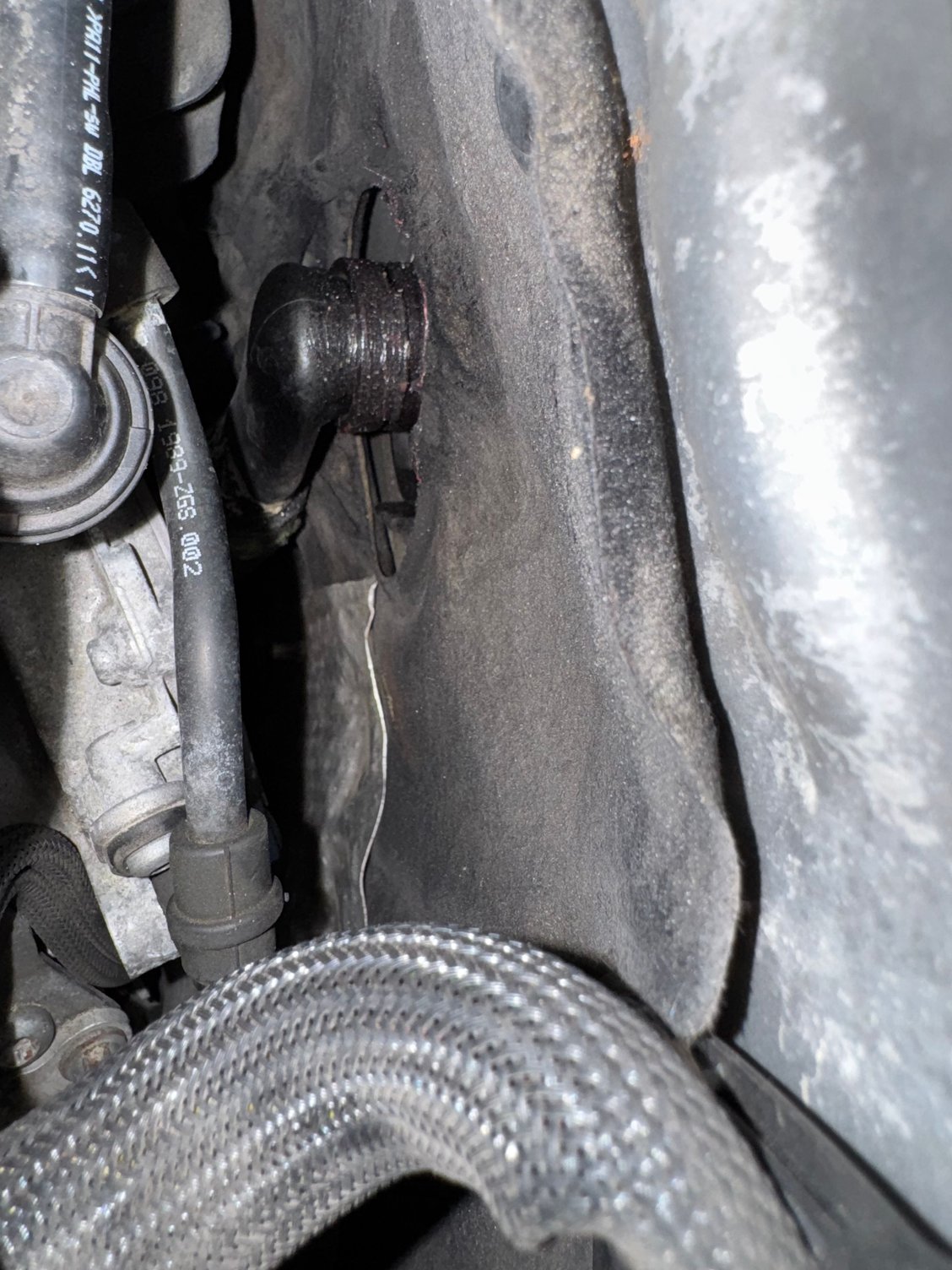

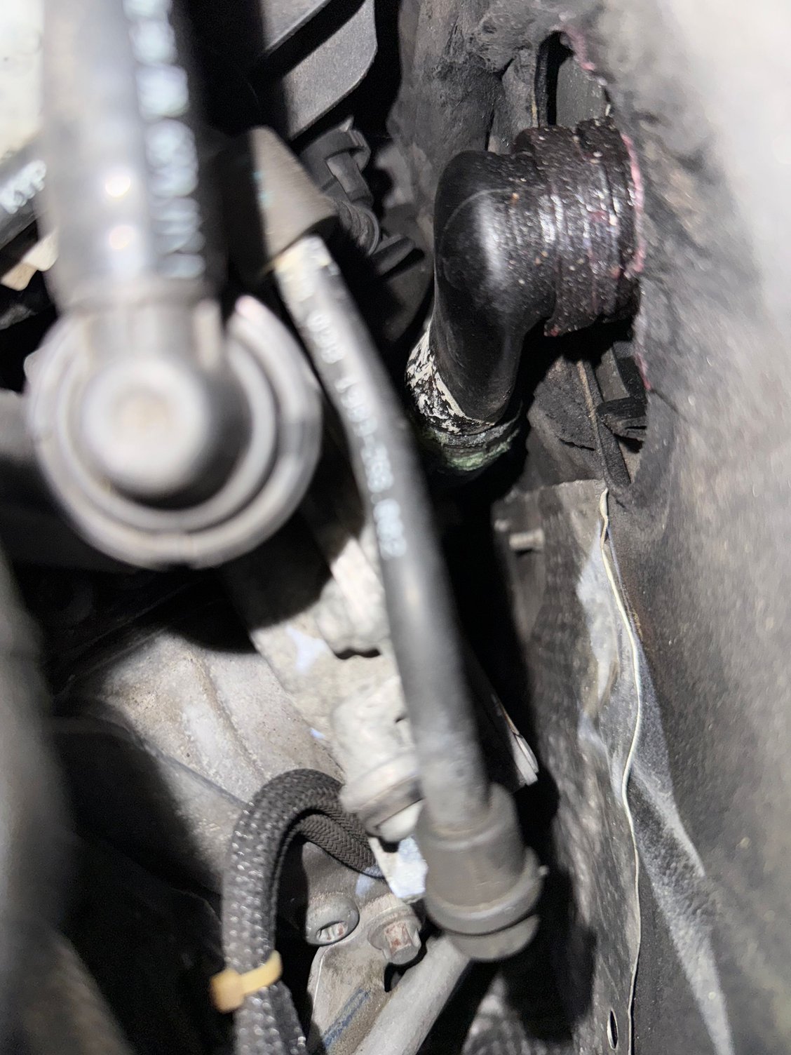

Hey everyone. I sent my car to a shop for a coolant leak and they actually found it. I didn’t understand what the tech told me other than a hose by the firewall. I managed to find it and it looks like it’s in a very uncomfortable spot to do a DIY. I’ll probably spend about $150 to replace the hoses and like almost 2k in labor. Is this a common issue on the M157’s and is there a way I can change it on my own so I can save money?
This is behind the engine/driver side firewall.

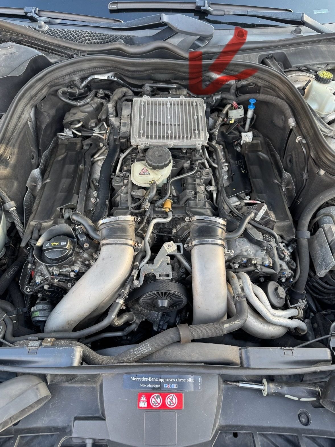

I drew a red arrow below to indicate where it’s located.

LEAKY O-RING
this is a really standard repair... ~100kMi?
$2000 only??
Vibrations are really what's helping stress this hose connection.
How old are your Engine Mount + Tranny ?

Did that when the tranny was out. It's a bit tight but can be done from the top. About 20 min.work. Coolant will make a little mess.

I did my own...there are some tricks! First, first - your firewall is "fake" and can be removed. Take out your broken hose....then, on the passenger side pull the electronics over, and disconnect the other hose. It is a bit of a back and forth task, it comes up and out. You then have the space to replace that hose (there are a few other "while you are there" things...all very inexpensive).
This might be $2k at the stealership, it can be 2-4 hours in your garage!

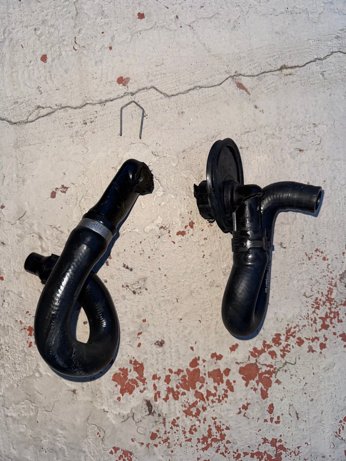

2 bloody/sweaty/frustrated days of torture and FINALLY got this done! Good Lord!! This was my greatest achievement of all mechanical time. Dang man! I’ve never felt so satisfied in my life until i pulled this out. Now I’m heading in and rewarding myself with a case of Stella! Cheers! 🍻

Two days? Now your just bragging. Mine was about a week! That was the first one where I found on I think a Nissan forum to melt the fittings out of the engine block.....oh, good times. I also changed the temp sensor back there while I was in the area.
