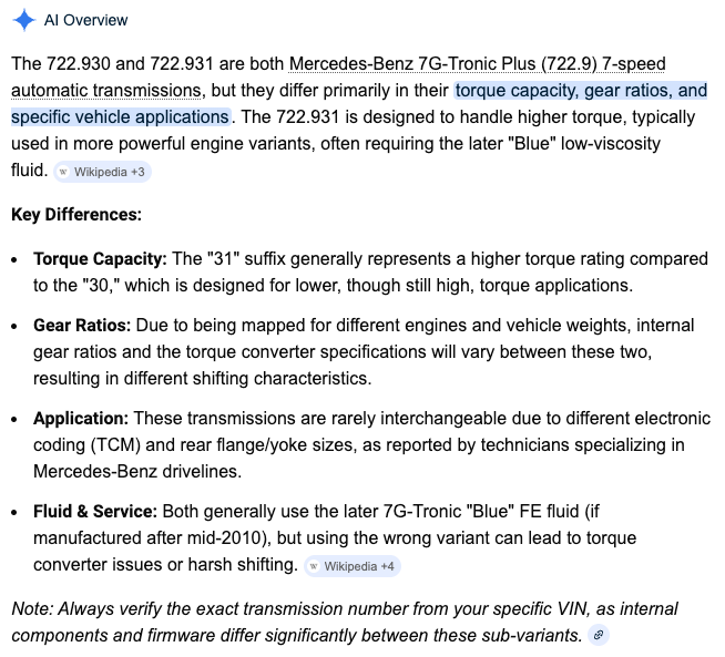

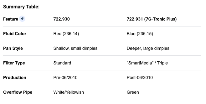

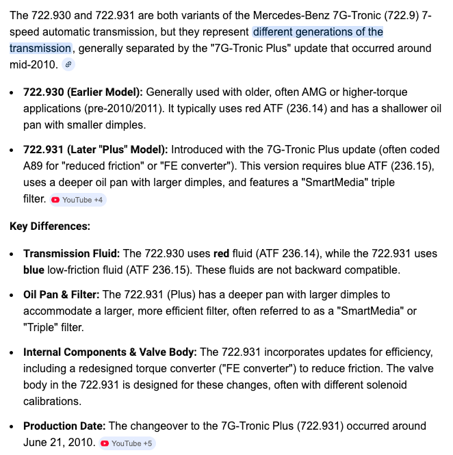

Mercedes SL R231
Ha! I ran the query again and got this. I’ll post my like and maybe you can get clarification.
Ai is saying older but the transmission that is the 722.930 is out of a 2017 C63S which makes no sense to me.
